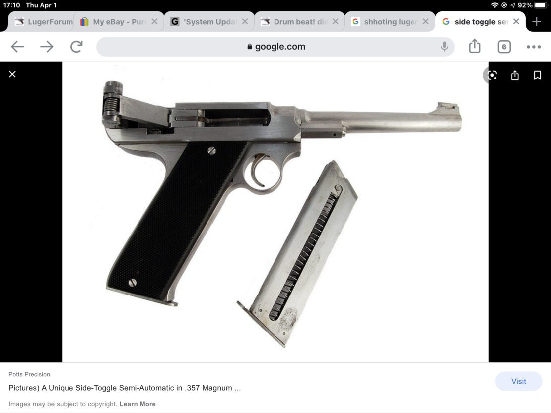

Damn, and I was so going to try to shoot Luger gangbanger style...sideways. I guess for that I would need something like that
File Type: jpg 24B92B69-B400-488C-A3D8-FE323C21CE16.jpg (71.7 KB, 197 views)
File Type: jpg C99D1674-D8C4-4A76-83A0-F0197BD71B7F.jpg (59.4 KB, 181 views)
