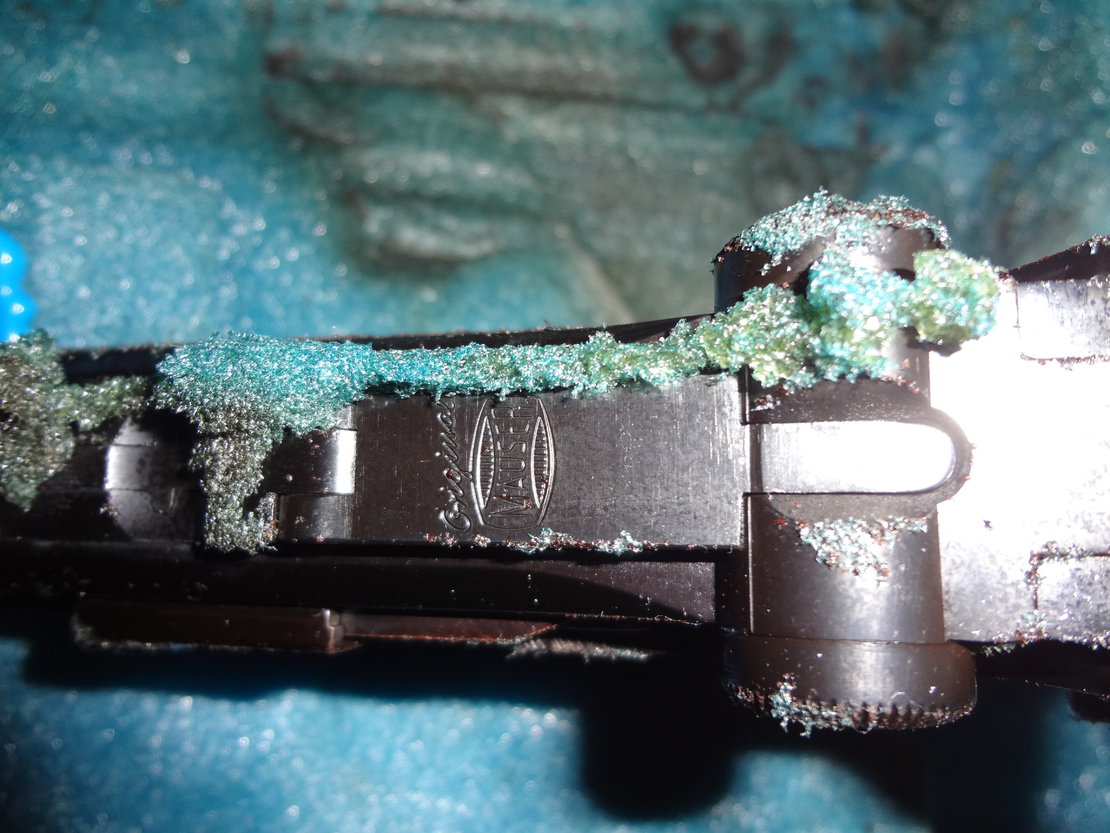

hello all
i've inherited a 6 in barrel luger from my dad 20 years ago. i was told its a naval version. its been in a foam case ever since he bought in in the early 90's. here is the problem. after all these years my buddy wanted to check it out so i took it out of storage. what i saw when i opened the case was the foam that lined the case has degraded and was stuck all over the luger. i was too afraid to clean it off as i didnt want to damage the finish. my question is how can i safely clean off the stuck foam off the gun without hurting it. my alternative is to take it to an expert if i have to. that could run into big bucks.
any advice would be appreciated
thank you

I think I would try a few drops of oil on a spot where there is not too much foam. If it takes it off with a little help (toothbrush) You are home free............

Probably Acetone would be the quickest to dissolve the foam, and it won't interact with or harm the blue. But also, as Hugh suggests, trying a small, inconspicuous area first is always a good idea. Quickly follow up with oil to remove haze/residue and preserve the surface.

I would not be surprised to see the bluing blemished from the foam and chemical reactions.
As said above, most oils would dissolve it, acetone would work best, then after cleaning it, use gun oil.
Clean well, but don't overdo it, less is better in this kind of 'cleaning'.

thanks for all your suggestions. i was thinking of acetone at first but was afraid it may affect the finish

here are a few pictures of the luger and stuck foam
the foam has an oily feel to it
i would say its been in this case for 30 or more years. its been so long i dont even remember how to strip it. i did this for my dad when he first got it to clean and oil. to be honest, i dont even remember if we brought this to the range to test

It's an Interarms Mauser Parabellum from the early 1970s.
Nothing 'naval' about it, they were available in several barrel lenght, including 6 inch.
Most of it should wipe off with a bit of oil and a wipe.

Original German and Swiss Lugers can range from $800 (for a shooter) to the moon (thousands).
Take the grips off carefully before you start to clean things .Acetone might damage the wood finish.
Make sure to properly oil it after using acetone if you do that... It completely strips oils - and it typically a really aggressive plastic solvent.
You might need to try well oiled bronze or steel wool gently on an oiled surface when you get the bulk of the stuff off.

I've found that good old Hoppe's No9 solvent will take off most adhesives and plastics after an overnight soak. Totally benign to the finish.

Acetone surely works, but just to be safe first I would use WD40 an old toothbrush and a lot of patience, then a good coat of BALLISTOL.
