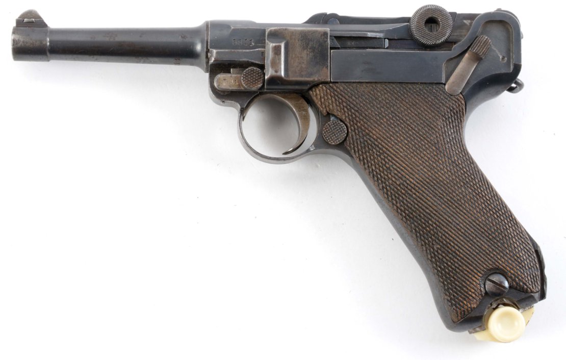

Hello - new guy from Washington State. I'm very green when it comes to anything other than S&W's, Colts or Sigs, so please pardon anything idiotic I might say about my newest firearm - a 1918 Erfurt Luger.
I am not one of those guys who has always wanted a Luger, but I was discussing firearms with a buddy and he asked me if I had a Luger. So the thought stuck in my head and when I saw one for a good price, I grabbed it. The first thing I tried to do was figure out how to break it down, and hit a wall almost immediately:
1) The toggle lock is not working. From what I'm reading on the internet, either the magazine spring is shot or the gun does not have a toggle lock. It has an after-market mag with a white bottom.
2) The take-down lever doesn't move. Is this related to the toggle lock issue?
Thanks in advance. I look forward to enjoying this Luger. If it's like most of my other ventures, I'll probably end up with more of these than I need.

To start with, congrats on your new acquisition, you'll learn more with this Lugers than any that follow... But, to the problems at hand... remove the RH grip, you should be able to actuate the hold open while holding toggle back? It's tricky, but after a little effort you'll get it... Once the toggle is locked back / open, (only way it, the take down lever, can be moved!!!) you should be able to swing the take down lever down 90 degrees to allow removal of the side plate, and, also the receiver after pulling back all the way on the toggle, to let the hold open fall down and release... If you get that far, we will re-visit and discuss the next move, moves.... best to you, til...lat'r...GT...

Thanks. I didn't try actuating the hold open, but I was able to push the barrel down and get the take down lever down. Then the side-plate fell off and I was able to remove the front of the gun. I decided to stop at that point.
I googled 'Erfurt Luger' 'mec-gar magazine' and found they make them. Will the 8-rd mags sold by Midway work with this gun? If so, I'll just buy one and see if that solves the toggle back problem.

Here's a short video of the process to disassemble and reassemble the pistol.
Link:
https://www.youtube.com/watch?v=L-RL98gXKTQ
I have a few slight issues with the terminology that isn't quite correct, the pistol has no "slide' it is a barrel with an extension. There are others but, I'll leave it for later.
Looks like a nice rig, the added plus is the holster and belt. If you get a chance post some pics of the holster and belt markings. Thanks for sharing your gun with us. You will probably want another.

Thanks for that video link - it made the process extremely easy to understand.
Funny thing - once I broke it down and put it back together, the toggle lock works, and very smooth and easy. When it arrived it was very difficult to even pull the toggle up, and then it snapped right back down. I'm a bit confused by this.

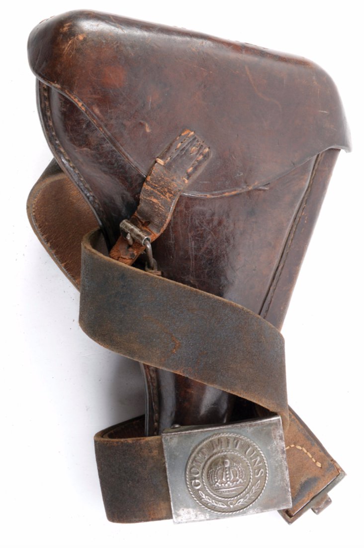

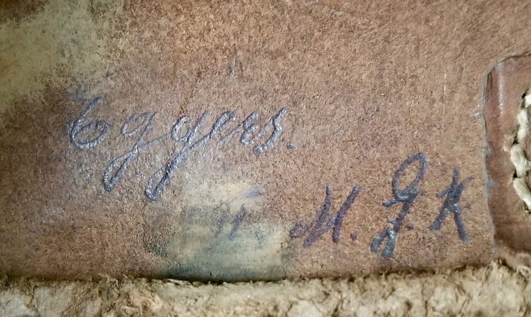

Attached are the pictures you asked about.

Congratulations on your new Luger.
You'll probably find a copy of our forum's FAQ document helpful. Just download it free by following the FAQ link at the top of the page.
The fact that you can't lift the toggle is likely related to the lock not operating.
The receiver has to be pulled back about a quarter inch before you can rotate the slide lock.
This jam up sometimes happens when the linkage between the recoil spring lever (inside the grips) and the toggle is not engaged properly.
Use extreme care when removing the grips. The left one, in particular, is easy to chip near the safety lever. The grip screws are also unique, with an unusual Whitworth British 55 degree thread.
Don't lift them far off the frame before sliding them down.
Before handling or working on this, ensure that there isn't a round in the chamber. The "loaded" indicator on the breech block will help, but consider probing it carefully to see if there is anything in there.

Thanks for your response. The first thing I did when I received it was pull up on the toggle and take a peek in the chamber. Then broke it down, pulled up the toggle and took a look through the barrel. Really wild to see all the differences between this design and anything else I've ever seen. Very creative minds at work here. Comparing this gun to the WWII versions (on the internet - I don't own one), they are amazingly similar. Like the old Smith & Wesson revolvers, and cheap wood mouse-traps, once they got things 'right', there weren't many changes made.
I think you are right that the toggle was not engaged properly. Once I followed the instructions in the video link posted by gunnertwo, everything worked great. Just now I broke it down again and had the initial issues repeated. Did it again and now it's fine.
Thanks for the grip recommendations. I got lucky on the first try and the grip panel fell off in my hand with no effort, but I'll certainly be careful to avoid chipping in the future.

Nice photos on the holster markings. Now do the same for the serial number, proof marks and toggle markings, so those who maintain databases can add yours to the lists.

Nice rig and you did very well... especially with the holster and belt/buckle.
