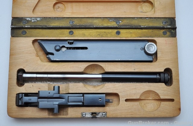

Thank you everyone. Any idea what this gun is worth? I'm into it for a grand but the conversion kit was included. Also looking for the long handled tool as it is missing from my conversion kit. Other than that it looks to be complete.

I'd say most of the value in your deal is represented by the conversion kit, missing rod notwithstanding, but I think you did OK. Your Luger has been knocked down to the basement in the realm of collectibility because of the over-buffing applied before plating.
Conversion kit?
His other post

You have a $1000 cleaning kit and a free luger, JMHO.
Enjoy them both.
The long rod was likely removed from the kit in service, when the small chain type cleaning kit came into use. Later boxes were of the "small" variety and had no provision for a cleaning rod.
The small empty spot is the provision for the 9mm ejector when removed from the receiver to install the sub-caliber kit- so you don't lose the extractor!
