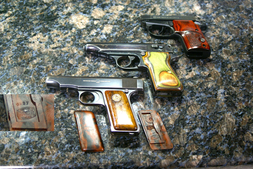

Here's the picture with my other pair of .32s, and Eugen's grips mounted. Turns out the grips that were on it are actually, genuine Franzite! Which means they've been on the gun for some years most likely. Wonder as to the how/why of it all.
Anyway, the gun looks even better in person that it does in pictures, the BBL was dirty but cleaned right up and looks brand new! The piece does have a broken firing pin, which isn't terribly surprising - a re-pop FP is on order.
Now this may not be "news" to anyone here, but my research led me to believe that keeping control of the FP and its spring during reassembly can be a chore. Not true - see this short video for details:
https://www.youtube.com/watch?v=swQ8UTRn6P8
Haven't seen that little detail about the FP spring assembly retaining notch anywhere else - makes it easy-peasy.

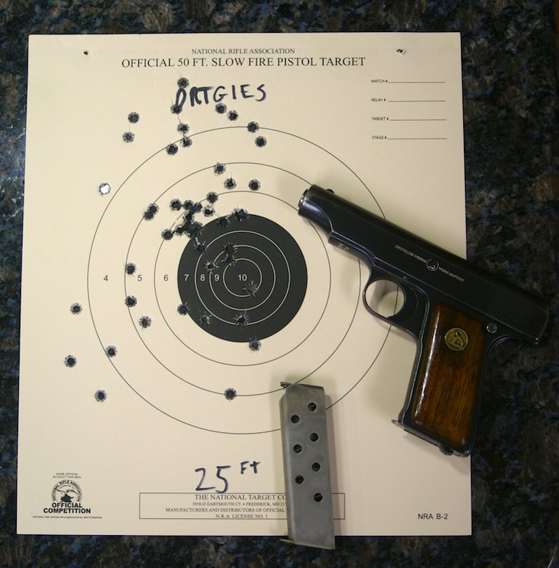

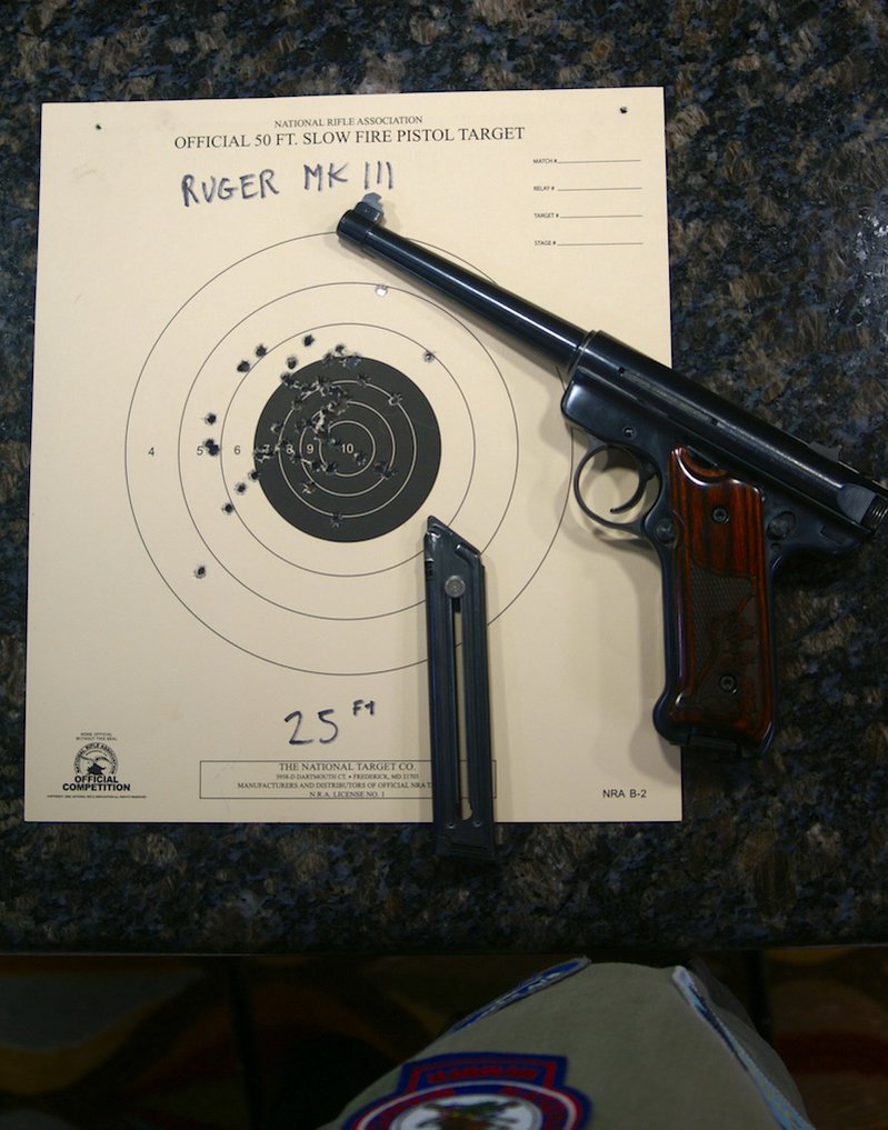

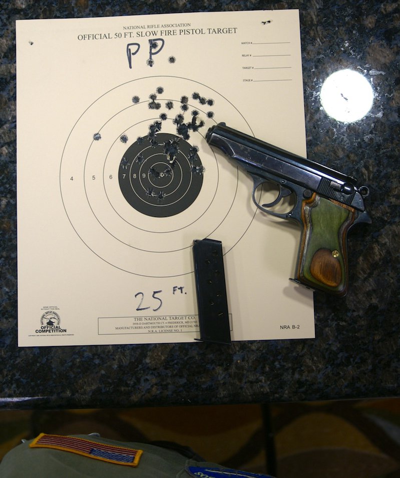

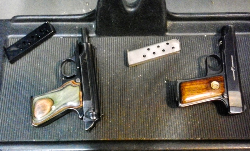

Took the "new" Ortgies to the range, along with my Walther PP for comparison - and my Ruger Mark III .22 "just because".
Comparing the Ortgies with the Walther was "interesting" - keeping in mind that the Walther is a 10 year newer design in a time when handgun design was rapidly evolving.
Sights: Ortgies very small V-notch, Walther is a smaller version of the modern U notch sights we're all familiar with.
Empty mag hold open: Ortgies no, Walther yes.
Mag release: Ortgies heel, Walther button in usual place.
Firing system: Ortgies striker, Walther hammer.
Safety: Ortgies has a one of a kind odd grip safety, Walther has a decocker.
Accuracy: As can be seen in the following pix, the Walther won out - these two guns in *my* hands, on this particular day. Same ammo used in both, a mixture of PMC hollow point and Magtech FMJ.
Reliability over the 50 rds shot: I had one FTF/FTE "event" with the Ortgies, with a PMC hollow point. Walther had no issues.
The rest of the story: All shots at 8-1/3rd yards, AKA 25 feet. 50 rds through both. Both guns felt fine in the hand, and handling/recoil were very similar as you'd expect. Both guns had replacement springs in them, the Ortgies "just yesterday", and the Walther 250 rds ago when I first got it. Both are fun to shoot.
The oddball Ortgies grip safety just makes zero sense to me. *shrug* I shot a bunch of raw video yesterday of the Ortgies complete take down to replace the springs - I should have it up on YooToob as soon as I can get to editing/combining the footage.
