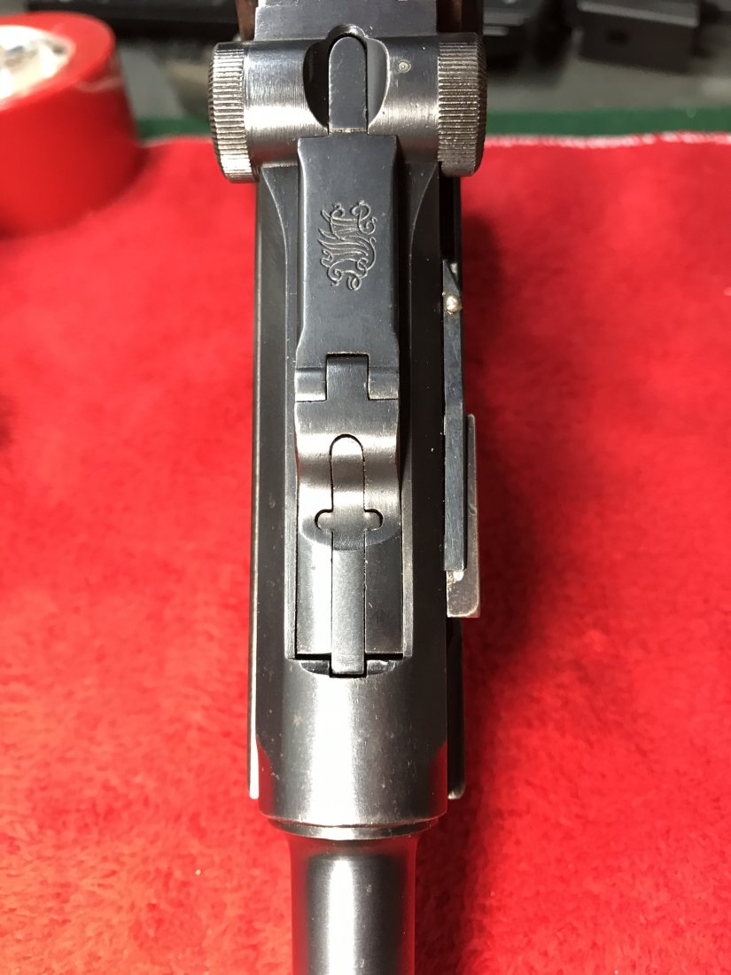

Just bought this DWM 9mm that I haven’t been smart enough to identify. Never owned a Luger before. This is marked “DWM” on the toggle but my research leads me to believe the magazine (122/37) is made by Mauser? What’s puzzling to me is that it has the correct serial number. All numbers I can find are matching but haven’t been brave enough to disassemble the gun. There is no serial number on the front toggle that I can see. From markings on the grip part of frame it looks like a police issue. You can also see the sear safety in one of the photos. Gun has a 4” barrel, a stock lug and no grip safety. Safety is engaged in the down position. Any advice is much appreciated.

What I am seeing is a late DWM (actually very close to Mauser taking over or did) police luger - it has a sear safety and a disconnected magazine safety (expected). Its Waa marking on the right shows it was accepted by the army (correct) and accepted into the police. The front grip strap markings are police.
The magazine is force matched and is a mauser period magazine.

Nice pictures!
Is there no date stamp on top of the chamber ?
I can only make out some scratches, so I wondered if the date was buffed off ?
Unread 07-23-2018, 01:27 PM   #12
Could we please see a better view in good light of the top of the chamber area? Thanks.

Thanks to all for the info and advice. Attached are a couple photos of the top of the chamber. No date. Doesn’t appear to me that anything was buffed off...

The chamber area is not ground or buffed IMHO. Since it was made up from parts, the receiver was probably unmarked during assembly and never got date stamped.
