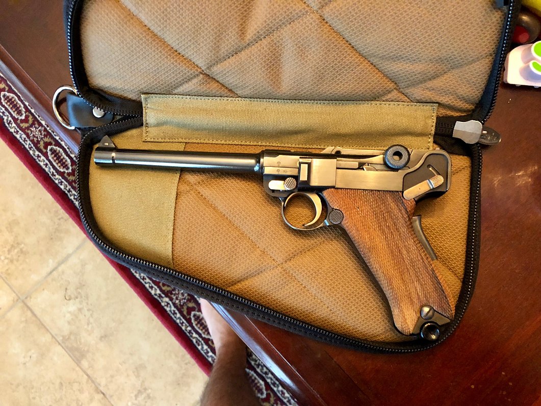

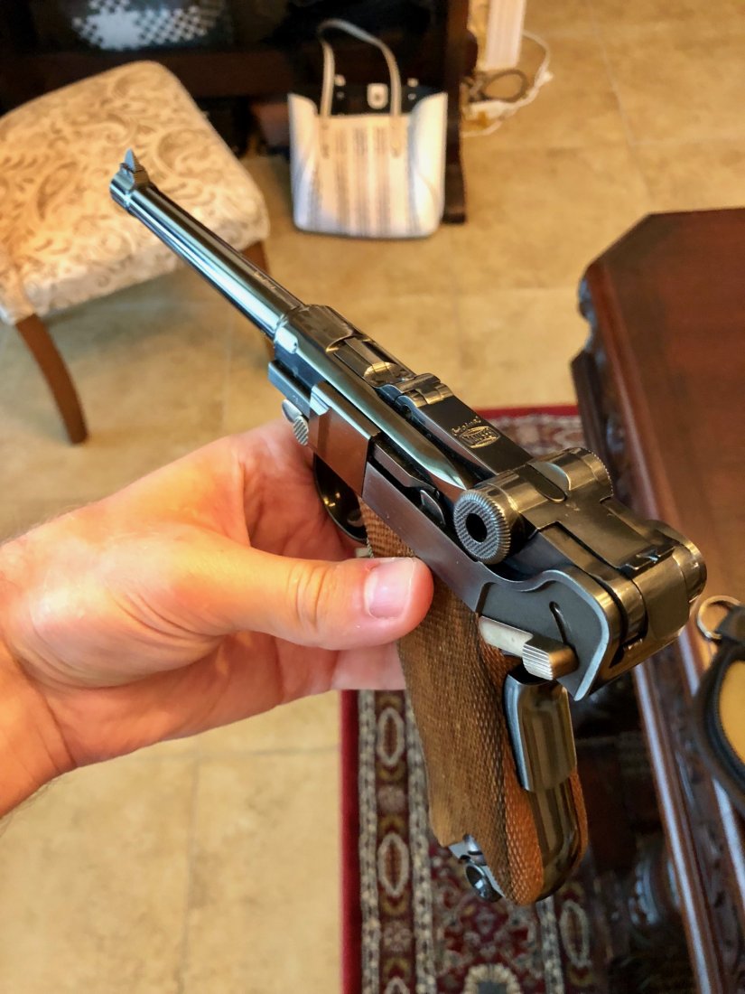

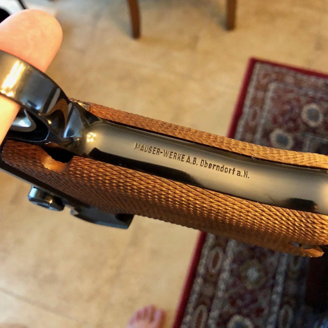

Greetings all!
Finally picked up what I have been wanting for quite some time. A LNIB 9mm 6" Luger!
I have owned a 1914 DWM in the past, so I am familiar with the platform and I consider myself pretty knowledge'd up on the history of wartime/interwar/commercial/postwar etc.
My DWM was like driving a classic car to work everyday. I loved it. It had the history, the charm, the character... but I like to shoot and I was waiting for the day the value would be hurt over something breaking. Plus the trigger was so/so, it had some issues, and really I always wanted a Navy or Artillery variant with a longer barrel... so I eventually sold it (dang things are just worth too much and I've got a family).
Since I could never afford a decent Navy, I jumped on this when it came on Simpson (I think I bought it the day after it was listed). That emotional connection was just there. I was going to get a new P210 with the money (funny how that works). I paid what I felt was market value; steep but fair. From what I gathered, the 9mm German grip styles are swiped up rather fast compared to the Swiss style or .30 Lugers. The gun itself seems as if it was never shot or maybe just test-fired. Original mag but unfortunately that is it (no box, tools, papers). Sadface. Oh well, I can acquire those in time. Compared to the P210, this is a single stack good ol' fashioned hand-made accurate 9... right!?

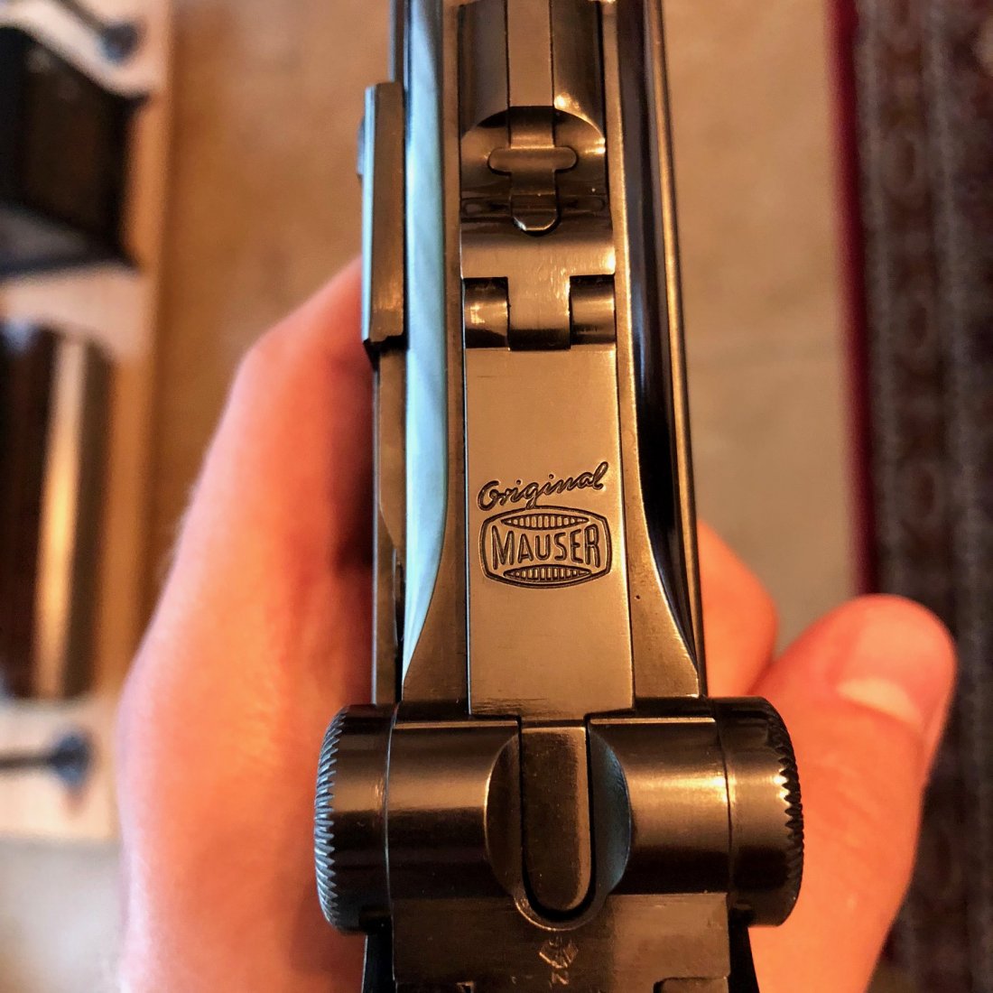

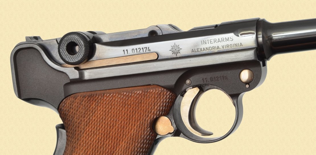

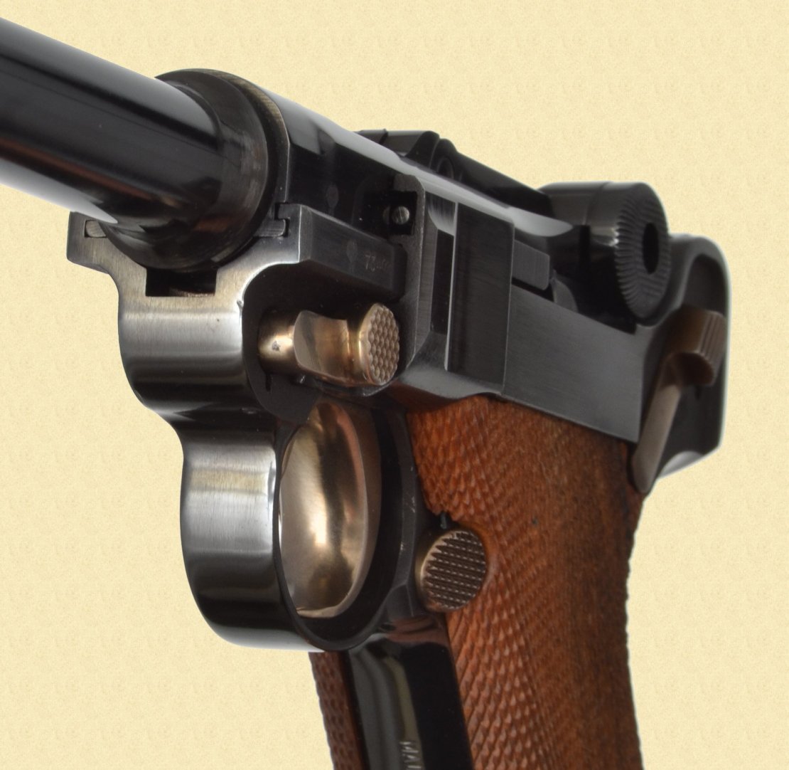

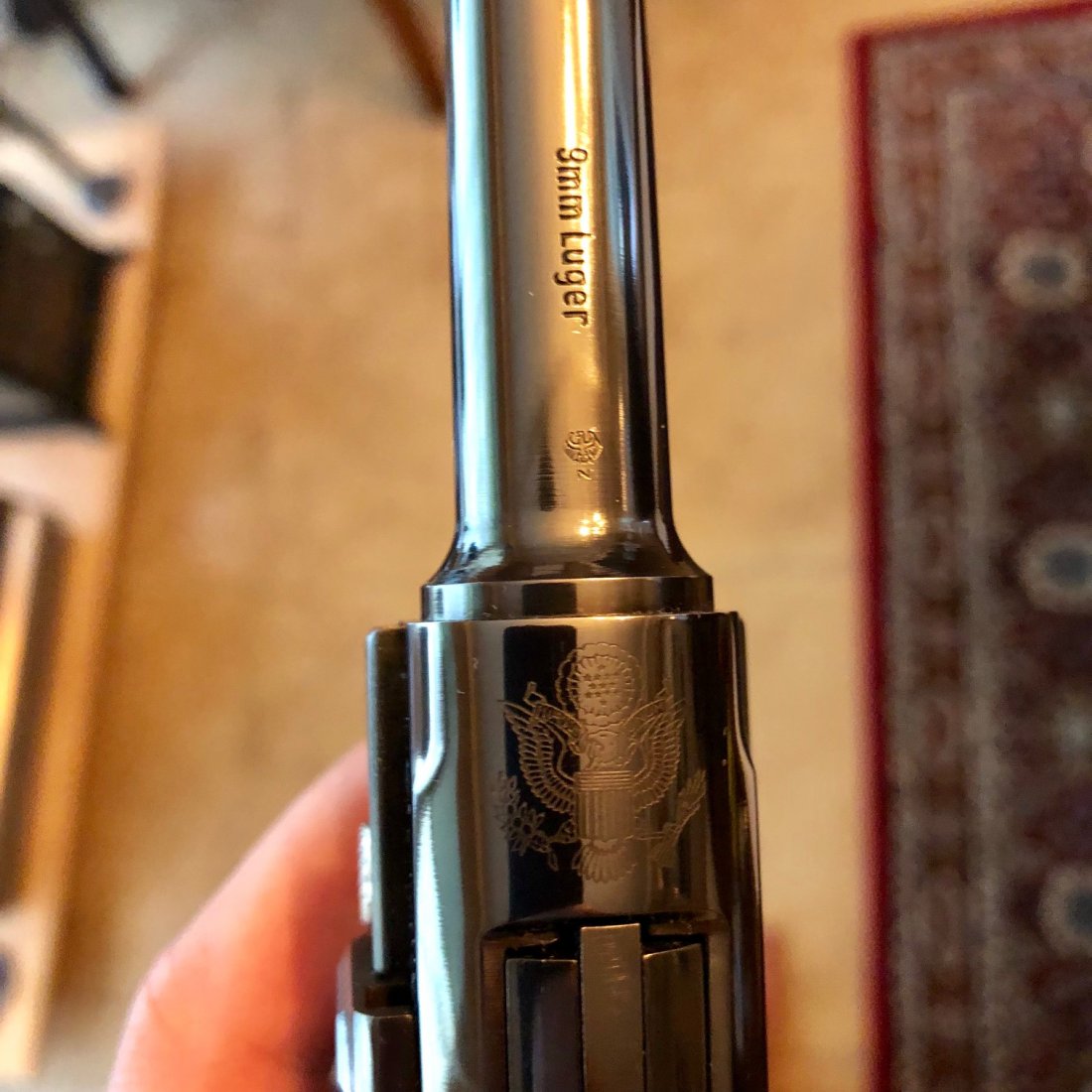

This one I noticed didn't have the typical Mauser proofs or "Parabellum" on the left side, instead has the Ulm stuff and the left side is blank. Was this for the European market originally? I'm guessing it was made in 1973.
Anyway, one HUGE question.... what can I do about these GRIPS! Ugh! I have a large hand (I can handle a Mark 23 easily) but c'mon, what were they thinking?! I feel that is this iteration's only downside. Lets compare it more to a sharp 2x4! I have read here that some members either cut-down and re-texture, but I'd rather not harm the originals if possible. Seems most here have the Swiss variant. Are there any other options for my 06/73?? Buy some orphans for sale from someone, and cut those down? Any plastic re-po's on eBay ever? Could I make some old VoPos or wood ones work at all?
Thanks for the help. I'll post a more detailed shooting report soon. The trigger and sight radius is amazing compared to my old DWM. Pics below for you. My best-

Nice 1970's Mauser luger; but it is not a "navy", though it does have a 6" barrel.
The Mauser 1970's grips are different from the originals, and held in place a little differently on the inside. You could find another set of Mauser grips and work them down to suit, or have someone make you a set of thinner grips.

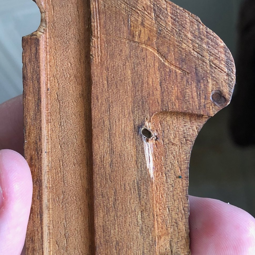

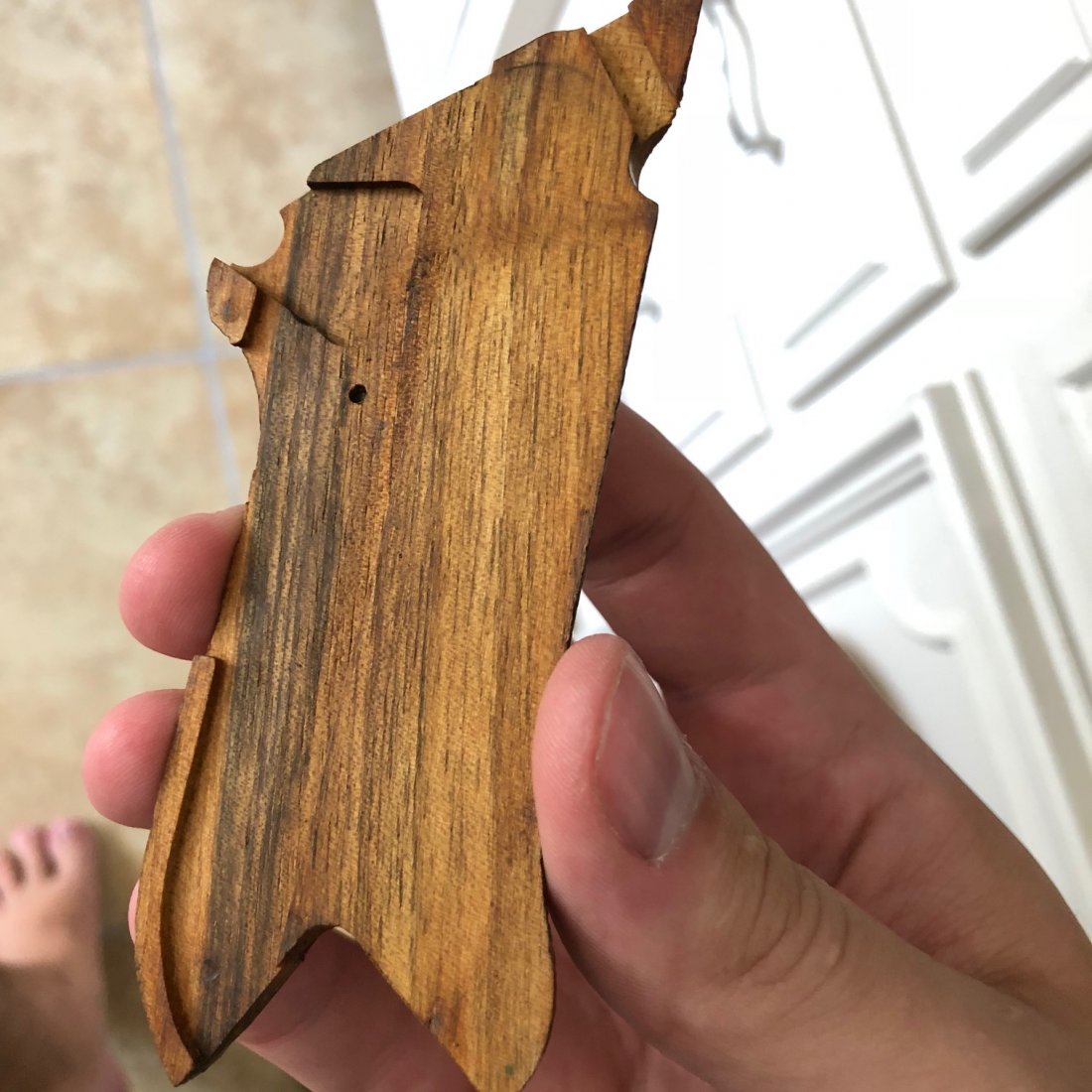

So I am sort of upset about how Mauser decided to handle these grips. As previously mentioned my right grip was slipping around ever so slightly, well, today I removed them and found an issue. The right grip's hole had worn back & forth, cracked the wood even, is surprising as the gun did not appear to be fired when I got it. Is this a common issue? It is discouraging and I am debating contacting the seller as this issue wasn't disclosed, or apparent when I purchased it. Sigh.

Yes, that is typical of a '70s mauser that gets shot.
Next the grips will crack from the hole, you can "fix" them by making the hole larger, filling with epoxy and re-drilling the hole. Or better yet, use release agent on the frame and pin and put the grips in place and tighten them down.
These '70s Mauser lugers are not the epitome of luger development, though some think they are "the best". JMHO

Thanks Don. I wont be doing any of that... I'll sell while its still OK and let someone else tinker with it.
I ordered some plastic 1929 style Swiss grips, I wonder if I hole those out, if they would hold up, being polymer and all?...
I know they wouldn't exactly match the German style frame, but there aren't many other options.
