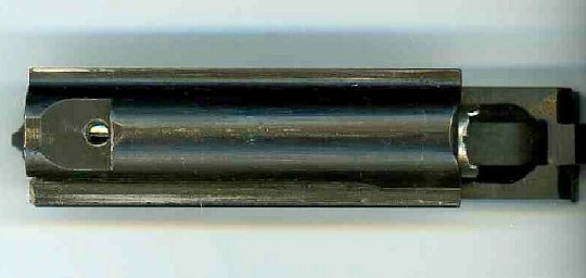

I have convinced myself that drilling the "Norwegian" gas relief hole in the bottom of the breech block is a very good idea, and should be done on any re-barrel job, and probably to any shooter luger. Collectible lugers probably should not be modified and left in their original condition- since they don't get shot anyway. Gas escaping to the bottom may result in a "blown" magazine- another reason to use "mecgar" mags for shooting and not original mags. But mags are cheaper than a new bolt, extractor, and possibly other associated parts.

Could a photo of the drilled gas relief hole be shown?

The hole is drilled on the machined recess of the hold open relief on the bottom of the breechblock?... Not very big either?... probably 3MM give or take a few.... GT

GT is correct, hole is about 3mm and in the bottom flat of the bolt, just ahead of the edge that catches the hold open.

Here is a modified breech block, Not sure if it is Norwegian or Finnish?

This pressure relief modification is found on many Finnish m23 Lugers. Did the Norwegians make the same modification?
Hi Ron,
This modification was made to many Finnish Lugers re-barreled to 9mm.
Hope this helps.

That would probably work even if the pin is not relieved?.... GT

Unread 06-19-2018, 01:13 AM   #13
Originally Posted by Sieger View Post
Hi Ron,
Hope this helps.
Sieger
Sieger and Dick,
That is what I thought but didn't want to contradict the previous post. Thanks for the confirmation.
