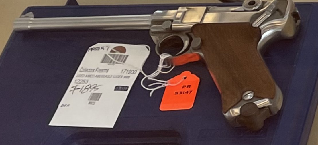

This AIMCO is at Collector's in Houston ($1895):

Dry your eyes boyz ... this one has been up at gunsinternational for awhile.
"AimCo American Eagle Luger 9MM (PR53147)" for sale
https://www.gunsinternational.com/gu...n_id=101615541
5" barrel with stainless finish. Comes with box and 2 extra magazines. In excellent condition.
Price: $1,895.00
Not my cuppa tea but hey ... each to their own.

Whoever listed this doesn't know how to measure a barrel.
