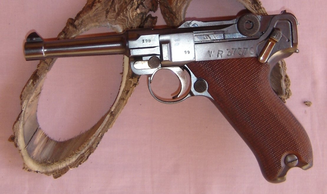

Before I really understood the rules of preservation and "respect" for the 1911 Luger we did shoot it occasionally. More accurate than my Beretta 9mm because of the more comfortable grip. The recoil is also less "jumpy" than the Beretta.
After learning from this forum though, it has retired and is safely preserved for the future!
