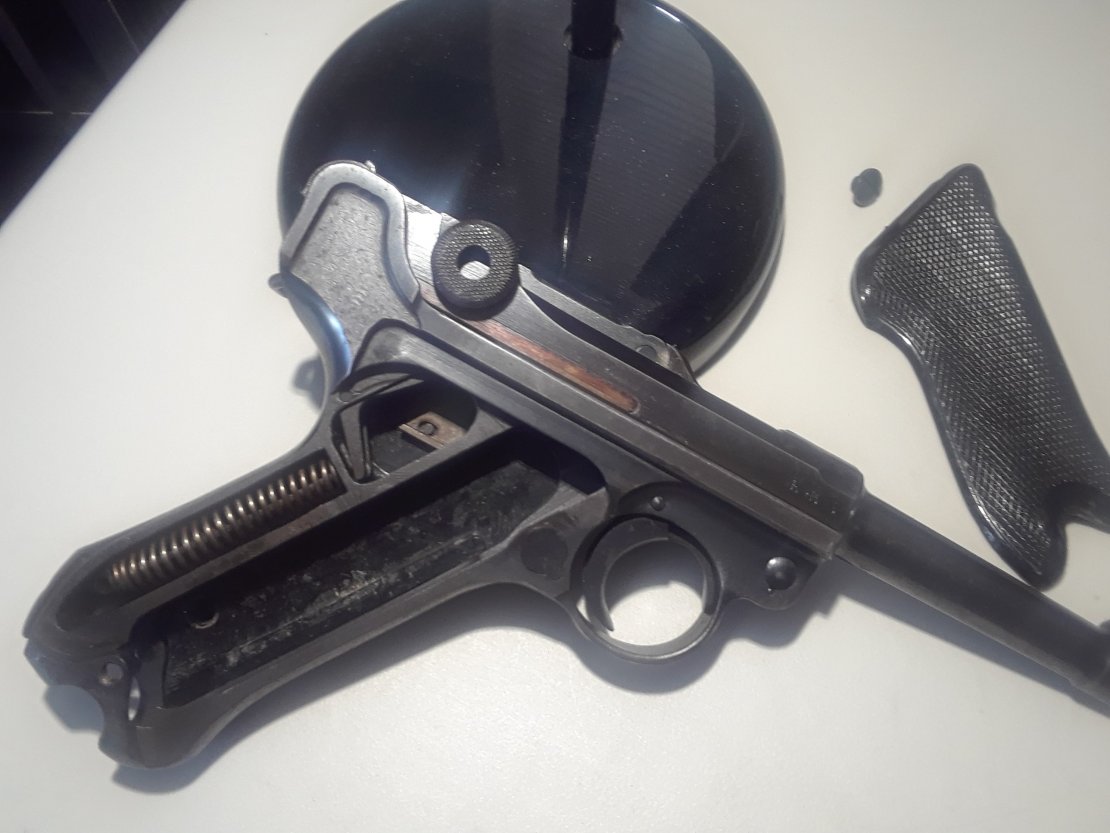

Unread 01-10-2018, 01:07 AM   #7
Originally Posted by mlading View Post
I'll probably take it to a gun smith and pass along the information you have provided.
As Gerry mentioned, 'gunsmiths' aren't very knowledgeable about WW II handguns. Your byf has a coil mainspring, I have never heard of one breaking but the guide could have a problem.
Here's a quick test - Take off the left grip and take a nice picture of the mainspring/gripframe area. We should be able to see any problem with the mainspring, coupling link or the recoil lever. Be careful taking the grip off - The part under the safety lever gets broken off easily. I've found it helps to press in the magazine release while lifting the grip off.

Here is a pic with left grip removed

byf 42 with right grip removed

Unread 01-10-2018, 04:41 PM   #15
Everything I see there looks good. Have you field stripped it yet? I've had a dealer assemble a Luger with the coupling link not connected properly.

4 Scale
Join Date: Nov 2014
Posts: 544
Thanks: 194
Looks fine to me. Out of curiosity, I field stripped and re-assembed a Luger, but did so incorrectly, failing to place the coupling link in the correct position. The receiver/barrel assembly then slides back and forth about 1/4", just like yours. I think we can say definitively that's the issue. If you go to YouTube there are many videos on how to field strip and re-assemble. The procedure is not difficult and requires no tools, you won't damage the pistol.

Unread 01-16-2018, 12:35 PM   #18
mlading
Join Date: Dec 2017
Posts: 11
Thanked 9 Times in 3 Posts
Follow-up. I followed everyone's suggestions. I viewed several field strip videos on YouTube and found that the coupling link was not engaging the recoil lever. Someone had probably removed the receiver and didn't re-install it properly. Easy fix. Field stripping the Luger also made it possible to verify that all numbers were matching. Once again, thank you all for your input. Great group here on the forum.
