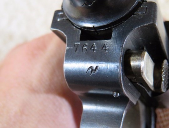

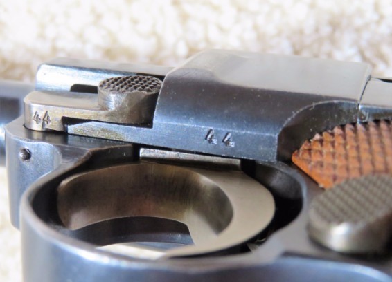

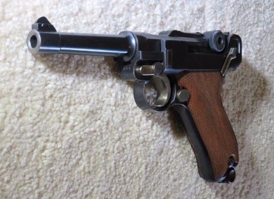

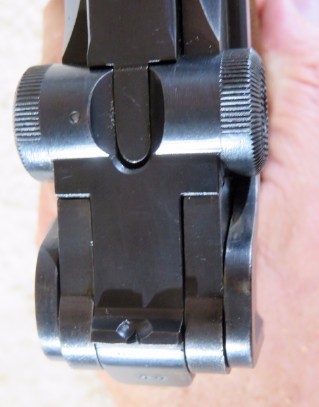

I have acquired a DWM Commercial Luger that I think looks pretty good. As always, you worry about whether someone may have boosted the finish. However, after looking at it closely and reading over the other recent thread on a "1920 30 Cal Commercial" I have concluded that the finish is very likely original. The wear pattern looks like original, there are halos, there is no bluing inside the frame, and the muzzle is not finished. I am less sure of the strawed parts. They just look too good. I have a couple of questions below.
I have included pictures.
But first, for Dwight Gruber, I am providing info on this Luger for your Commercial data base (in this thread, rather than adding to your "call for data" thread). I am deeply impressed with your database work and detailed knowledge of these Lugers. Hope this helps...
Ser. No: 7644/o
Cal: 7.65 para (.30)
Front of frame: 7644/o
Left Rcvr: crown/N upright

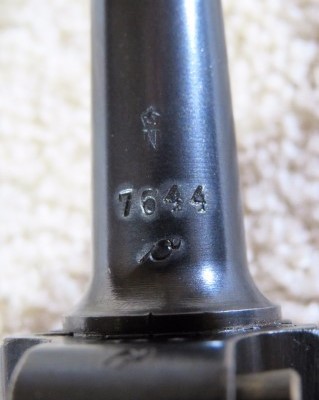

barrel bottom: crown/N upright, 7644/o
Breechblock (upper left): crown/N sideways
Fwd toggle: DWM scroll
Rear toggle: 44
Lock bolt (bottom): 44

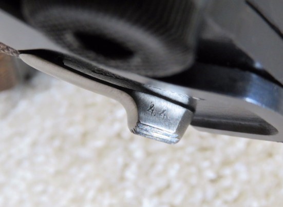

Side plate (bottom): 44, (inside): 7
Trigger: 44
safety lever (top): 44
Grips: unmarked

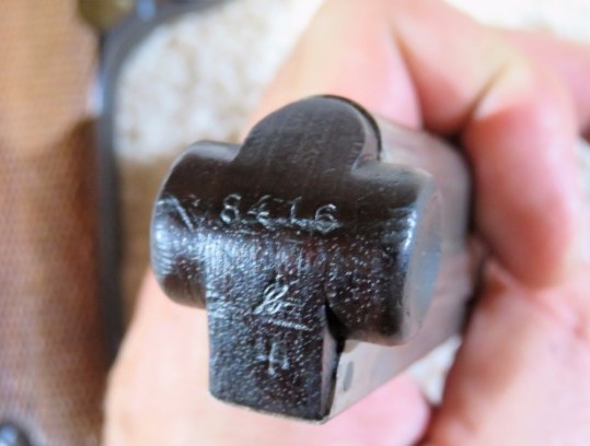

Mag: non-blue (tin?) wraparound w/ non-matching number wood base
My questions:
(1) I have read the FAQs, and all the posts I can find on commercial Lugers. I know the alphabets started in 1921 at around 2000/I. I think I understand that they went to about 1929 with p, q, r, and some s, t, u in out-of-sequence or questionable circumstance (I'm fuzzy on this). Does anyone have a estimate (or guess) as to date of manufacture for my ser no? I'm guessing 1926?
(2) I note that on my Luger, and on the one discussed on the other recent post, the yellow paint for the "Gesichert" has either been mostly cleaned off or was never there to begin with. I say mostly because, with a magnifying glass I can see very small trace amounts (5% maybe) still in a couple of the letters. Is this typical for the commercial Lugers? I would expect no paint there at all if the frame had been refinished.
Any other comments?

Some more pictures. And, oh I forgot, for the database... No import mark.

That is a dandy! Your photos show up very well and I have no problem going with original finish. A real jewel. I suspect the missing GESICHERT paint is the result of a former owner over cleaning it because he didn't know it was supposed to be white.
Unread 10-06-2017, 02:29 PM   #5
Sweet!!! Great Photography!!!
Unread 10-06-2017, 04:30 PM   #6
Posts: 2,305
Thanks: 2,735
Thanked 991 Times in 727 Posts
If indeed this Luger is all original, then you have found a real dandy!! It would have to have lead a very sheltered life to be that nice, but it sure can/does happen to some Lugers. Thanx for showing us your new Luger.
