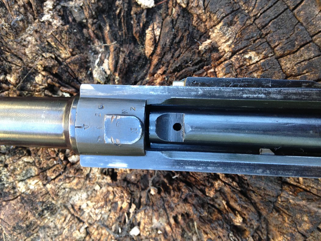

Best I can do right now is describe it, it is an approx 1/8" hole, in the bottom of the bolt, on the centerline, just about at the edge of the "cone" on the inside that fits the front of the striker.

I believe this is the pic you guys are thinking of. From my understanding the hole is present on all Finnish Lugers just in case of a pierced primer.

Unread 09-09-2017, 10:29 PM   #18
Yes,
that is it. Thanks for posting the picture!
Unread 09-10-2017, 05:58 PM   #19
chr
Join Date: May 2017
Location: home country of the Lugers => Germany
Posts: 13
Thanked 15 Times in 6 Posts
Thanks to all.
I am thinking now to update my shooting Luger with this hole.
Gold idea or not, what would you say?
chr is offline   Reply With Quote
Unread 09-10-2017, 08:45 PM   #20
Can't do any harm, as long as it is a "shooter".
