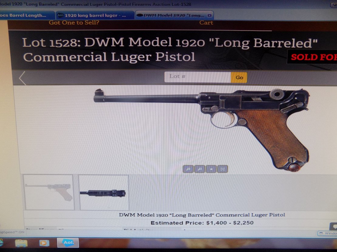

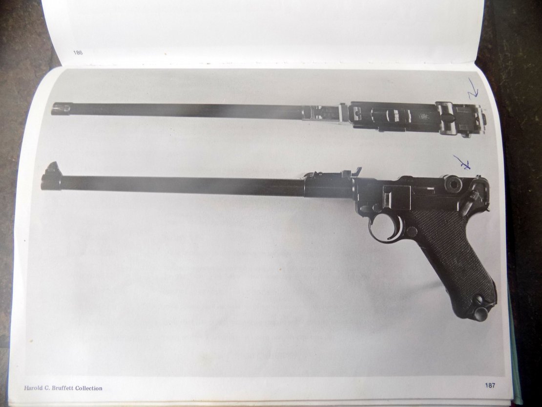

Unread 08-15-2017, 10:32 AM   #11
Default The Ultimate~
Awesome! Your dreams have been realized!

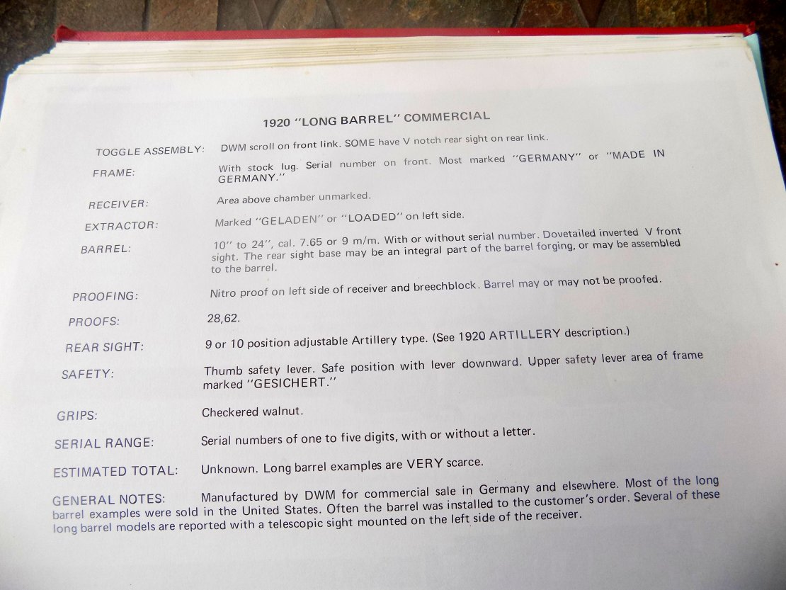

Unread 08-15-2017, 10:42 AM   #12
1920 was a very busy long year!
