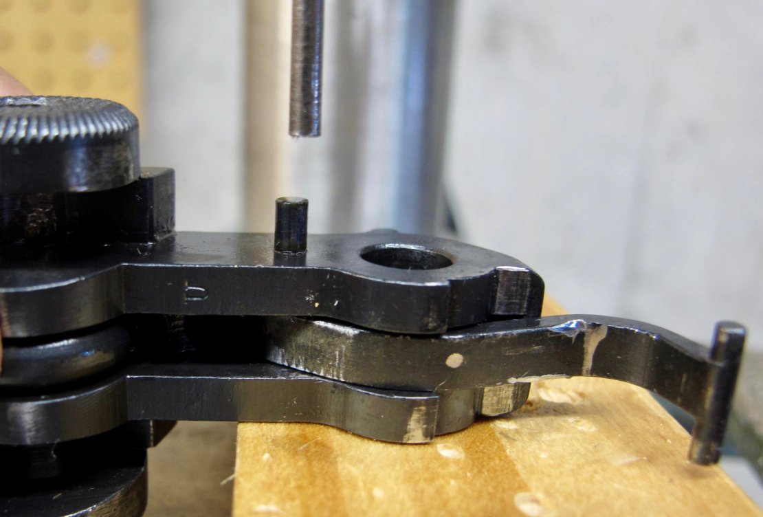

I recently attempted to 100% detail strip a 1938 Mauser 'shooter', just for the fun of it. Youtube disassembly videos give a good overview of how to do it although the ones I viewed leave off removal of some pins. I was able to get the pistol and toggle apart, except for the sear plunger and S-link. I found the pins holding those to be very tight.
After unsuccessfully trying to remove those pins using a punch and mallet, I decided to try my drill press. It worked and I wanted to share the technique.
I found a very small drill bit in my parts box that fit the pin face, and chucked it into my drill press upside down. Sorry I don't have the exact drill bit size, I just made a visual fit of the bit face to the pin. I placed a block of wood under the sear assembly. I found I had to tightly chuck the bit into the drill press or I could not budge the sear plunger pin. But, on about the third try I had things tight enough and pushed the pin out.
There is a hole in the wood block to receive the pin. This photo was taken right before I pushed the pin out.

I was able to dissemble the toggle parts fairly easily, but the pin holding the S-link would not budge using a 3/32 punch and mallet. So, I chucked a 3/32" drill bit into the press, upside down. As with the sear plunger pin, there was a hole in the wood to receive the pin when it was pressed out.
I had to pull down pretty hard on the drill press handle - the pin would not move and the drill bit began to slide upward into the chuck vise. So I then chucked the punch into the drill press; the punch has a textured handling surface less less likely to slip. Note that this toggle has been re-blued. I'm wondering if that was why the pin was so tight. Plenty of pressure, then a "bang", and the whole thing was apart.
I cleaned out ancient sludge where the pin had held the s-link into the rear toggle, then used the mallet to start the pin. It was tight going back together, but the pin went in much easier than it came out.
Pistol is now reassembled and function checked.
There you have it. I've now 100% dissembled a P 08 including the toggle, S-link and sear plunger assembly. Having done it, I would not recommend disassembly of the toggle and sear plunger absent an issue - the grime removed was not that significant, and the risk of marring the parts or losing the spring was always present. But, for those like me, who cannot leave perfectly functional P 08s alone, or who enjoy the challenge, use at your risk and as you wish.
This photo shows the 3/32" punch mounted in the drill press, which was used to remove the pin, just before I pressed the pin back in.
