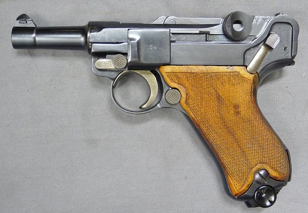

Evan. The pistols are discussed in our book 'The Parabellum is Back - 1945 - 2000'. Mauser set up tooling in the 1970s and produced them again. Your baby is made out of a postwar Parabellum as a feasibility study for a commemorative version. The handwriting on the magazine is most likely that of Prof. Dr. Rolf Gminder, then manager of small arms production at Mauser.

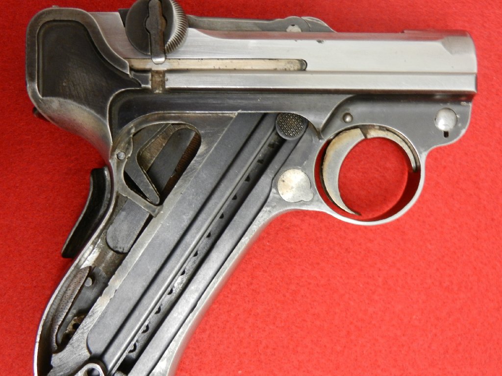

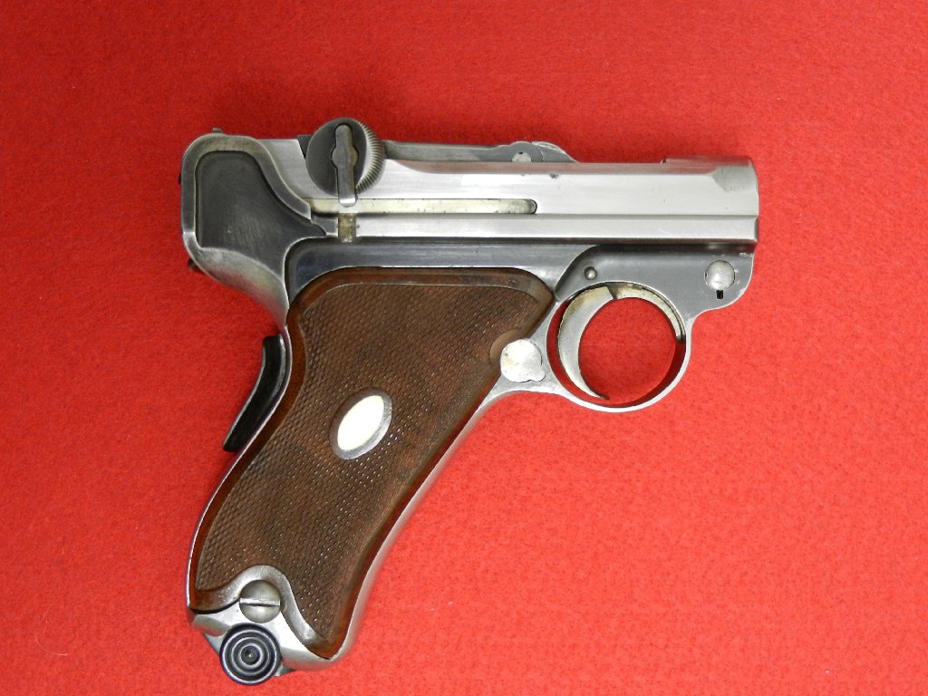

Unread 09-08-2016, 09:57 PM   #31
Posts: 8,197
Thanks: 1,416
What happened to the baby for sale on GB??? Did the sale fall through???
I hate to say it, but IMO Eugene has gotten the proportions and the correct donor Luger to make an appealing 'baby' (or pocket) Luger...
http://www.lugerman.com/Pages/SamplePages/Work_22.html
There is no way I could ever afford one, and I couldn't wait that long even if I could afford it...But it just looks "right"...

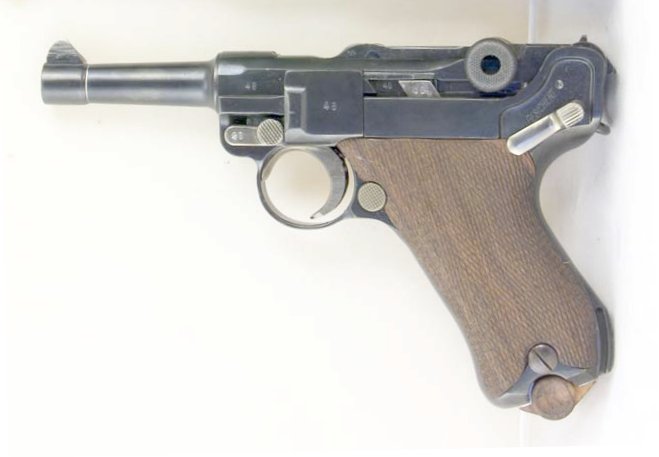

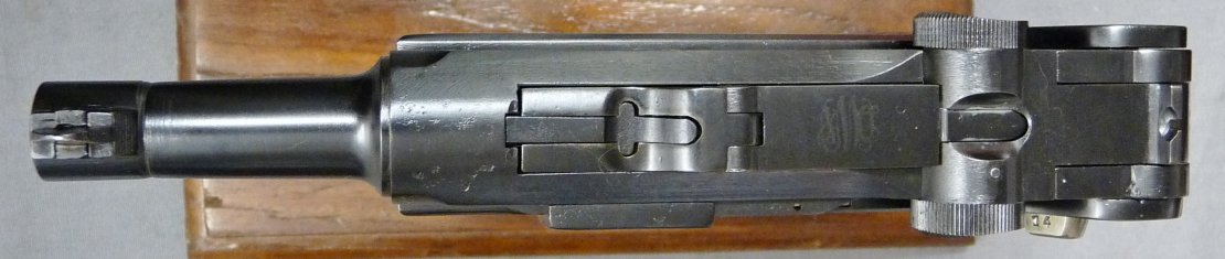

Rich,
You could make one yourself!
As I did with a lot of help from my friends!
This bbl is 2.75", I think maybe Eugene's is a half inch longer? I think I like the slightly longer bbl better myself.
Jim Solomon has the frame now, to make a set of simple "normal" checkered grips without border.
I think you're right about the barrel. Blowing it up on my scanner, I get 3 1/8" from his web site pic. But in another thread, Ron says the early 'babies' were made from shortened fat barrels...IIRC, Navy fat barrels...(I might have not remembered that correctly)...
