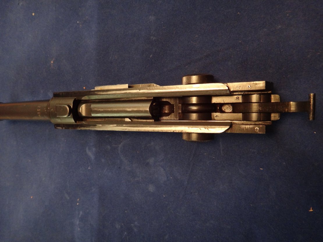

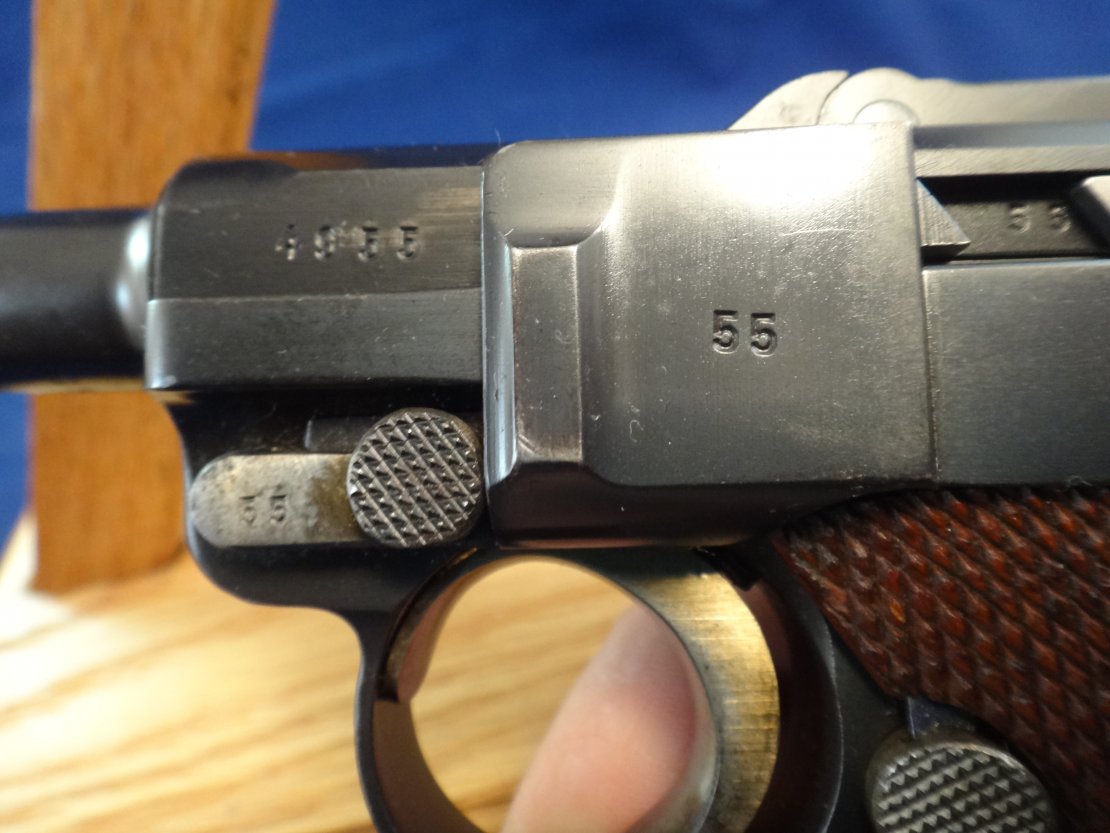

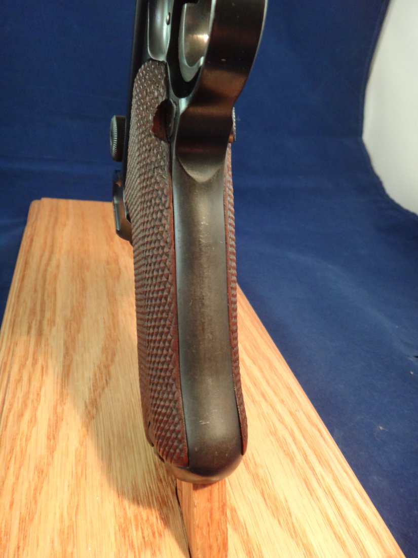

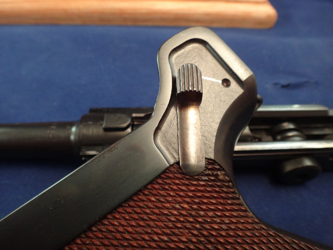

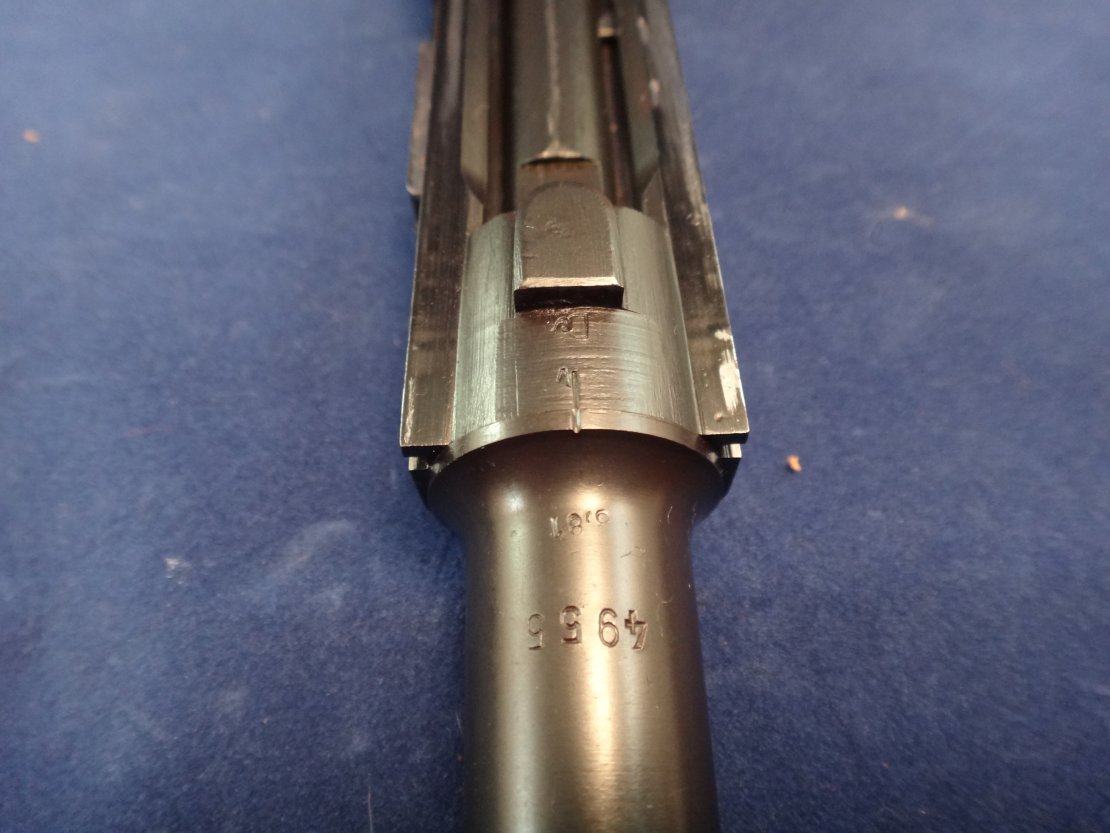

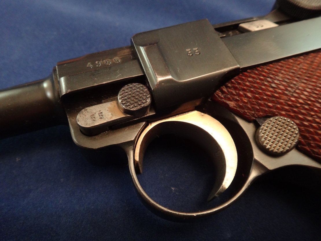

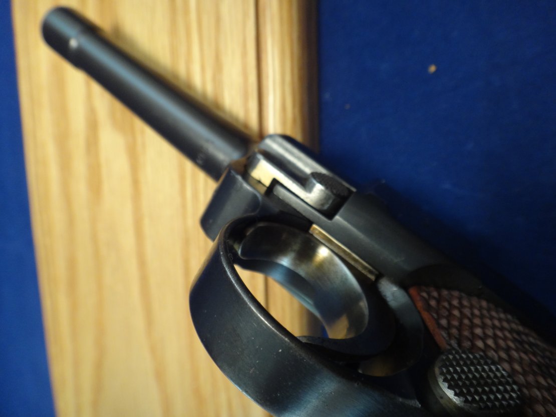

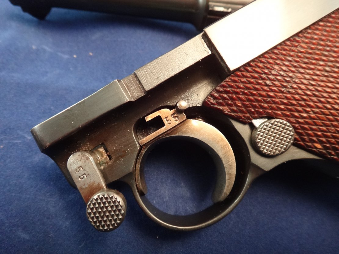

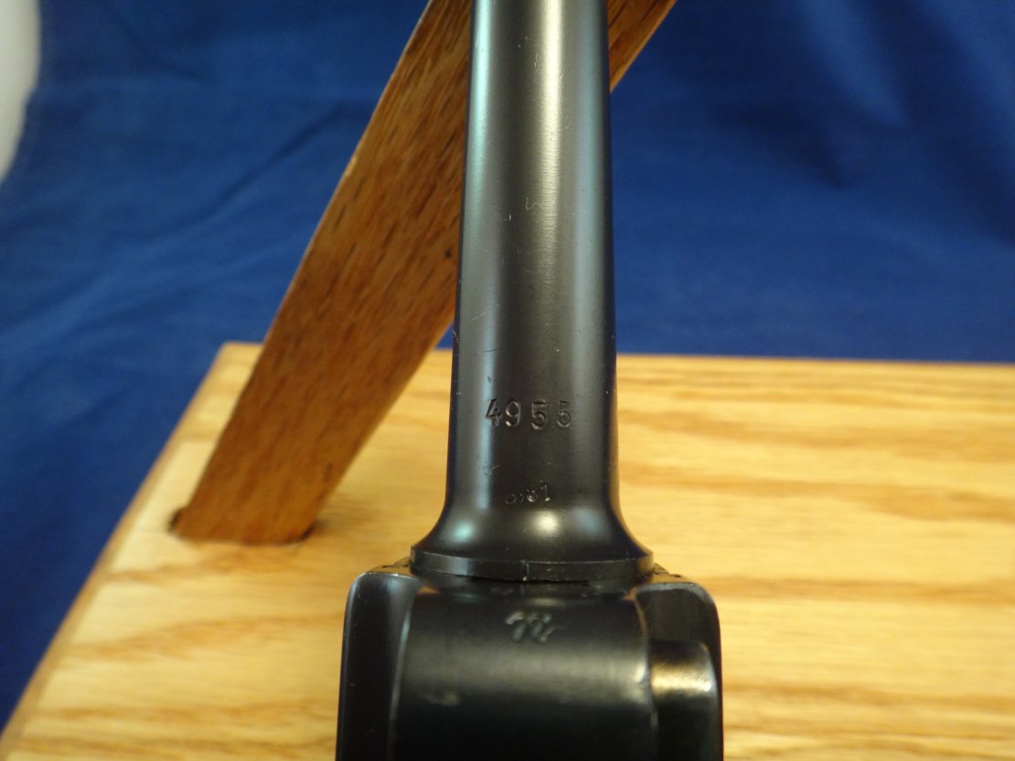

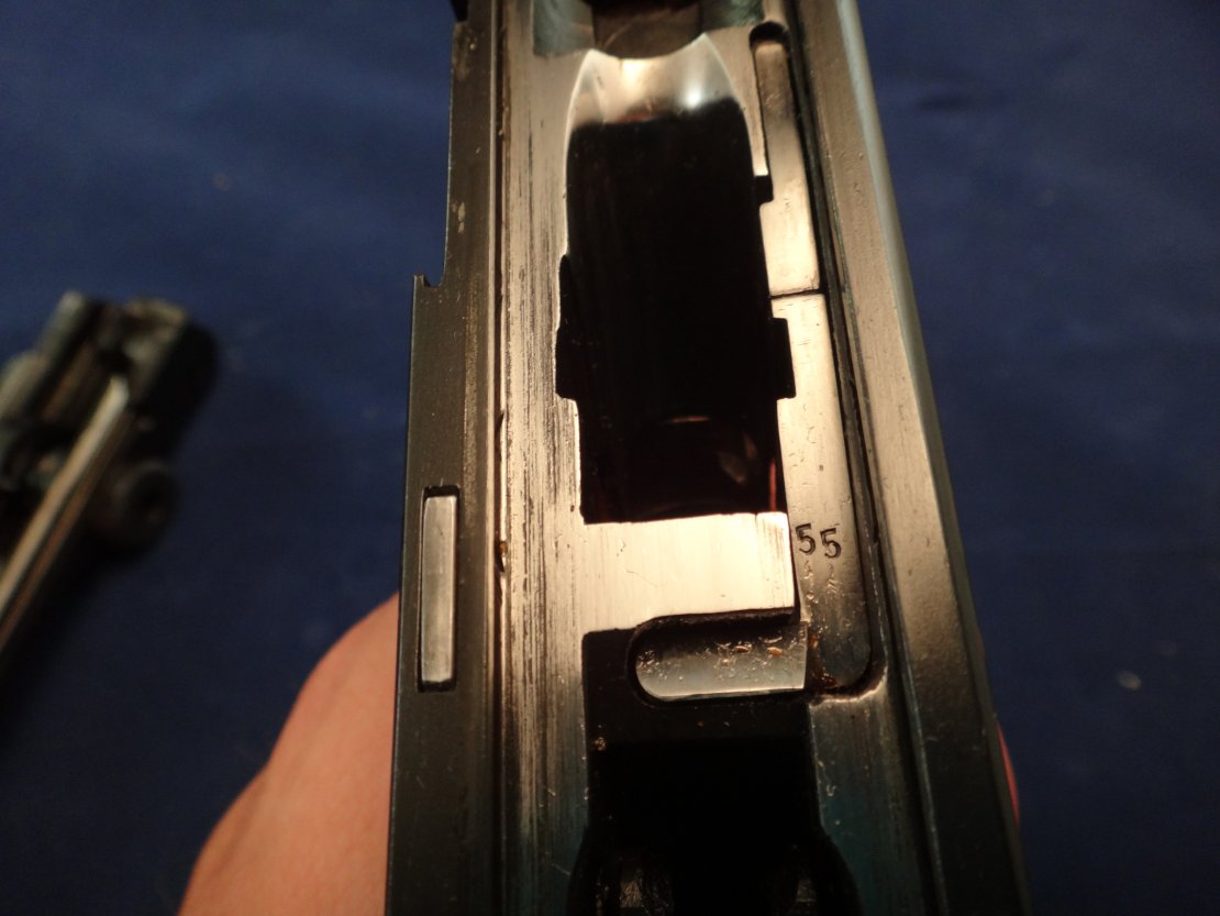

I just want verification to what I think I know, I believe this piece has had an older restoration done to it, It is one of the pieces I got back from The ATF 26 years after it was stolen from me. I do not see any evidence of the halos around the barrel serial numbers and the overall condition just seems too good.
Regardless it is an all matching pistol minus magazine and I still wouldnt consider it a shooter. Would like to hear from others on this though.
Wayne

Wayne,
congrats on its safe return.
I do not think it has been refinished; the markings are just too clear and the finish looks as it should after 80 years.
Unread 05-15-2016, 10:51 PM   #5

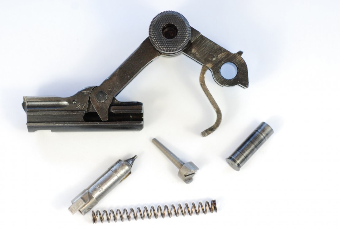

Hi Wayne,

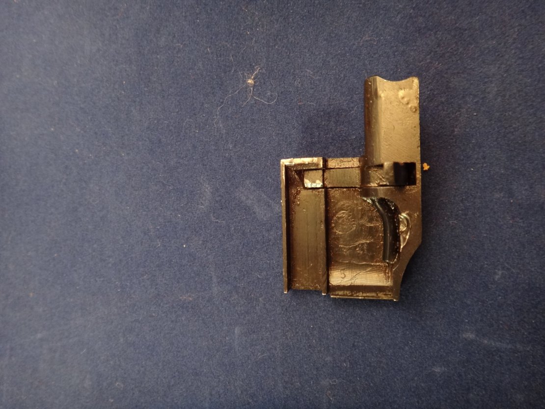

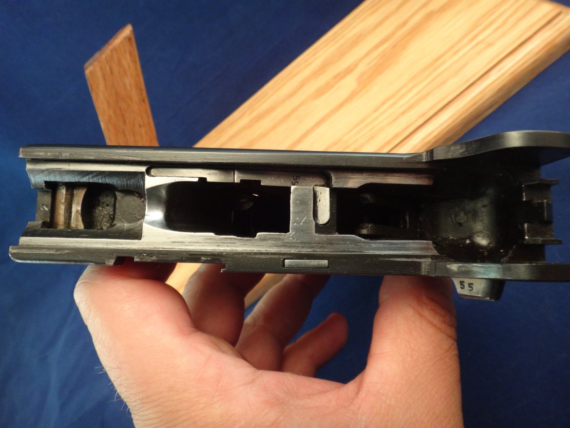

There are at least three strikes against the original finish theory. One, no barrel serial halos. Two, the L shaped lever inside the side plate is blued, it should be "in the white". Three, so too should the S shaped connecting link attached to the rear toggle. You know what they say in baseball....
Regards, Norm

Wayne,
You finally got it back! (I read your earlier threads about this gun)
It is not unheard of for SOME rust-blued early Mauser S/42 Lugers to not have a halo on the barrel SN, but I would expect to see some bit of halo, or wear on the raised areas of the barrel witness mark, or the numbers (8.81 or the SN). But then the rest of the gun looks original to me. The lower frame has what I like to call the 'classic black & white' bluing scheme used in 1936-37 Mauser S/42 Lugers.
- Geo

Wayne,
After looking more closely, I notice that the sideplate trigger transfer bar is blued, as is the mainspring hook hanging down from the receiver. I just checked my all original early rust-blued 1937 S/42, and it does not have these parts blued - they are in the white. It is my understanding that all rust-blued Lugers had these two parts in the white from the factory, so I would have to say something happened here.

Norm,
You type too fast for me - or maybe I'm just too long-winded!
Anyway Wayne you can see I agree with Norm - it is reblued.

Unread 05-15-2016, 11:04 PM   #11
I was ready do argue with Norm, however after getting out my own orig. 1936 S/42, I'm afraid he's right on all 3. But whoever did that work certainly did a nice job, and it is a very nice gun not to be quickly dismissed.

Unread 05-15-2016, 11:16 PM   #14

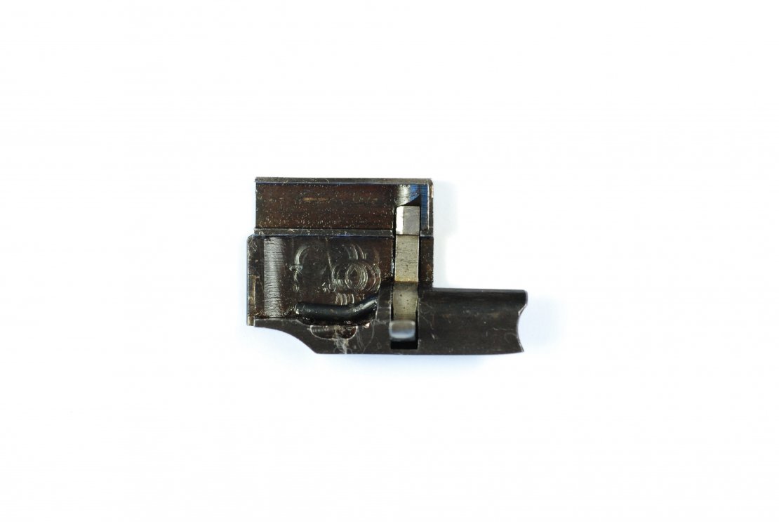

Just to be clear, the L shaped transfer lever and the S shaped connecting lever were left "in the white" on ALL Mauser Lugers until the end of production in 1942. Here are photos showing these two parts on a 42 byf.
Norm

Unread 05-16-2016, 12:11 AM   #19
Geo99
Join Date: Apr 2012
Location: Whidbey Island WA
Posts: 400
Thanks: 103
Thanked 127 Times in 75 Posts
I would say based on the evidence, the entire upper (barrel, receiver, sideplate) is almost certainly reblued and then either fired a lot or someone took great care to make the receiver look like it was, due to the worn condition of the upper rails.
The lower frame parts may not be reblued - it looks fine to me, including the straw which looks original and the grip straps. Whoever tampered with (touched up?) this gun did an amazing job - no buffer used here!

Unread 05-16-2016, 12:22 AM   #20
Geo99
Join Date: Apr 2012
Posts: 400
Thanks: 103
Also the extractor looks a little purple, which is not normally seen. I've read that later salt blued Mausers can have some purple (especially the ejector spring), but not a 1936 rust blue.
