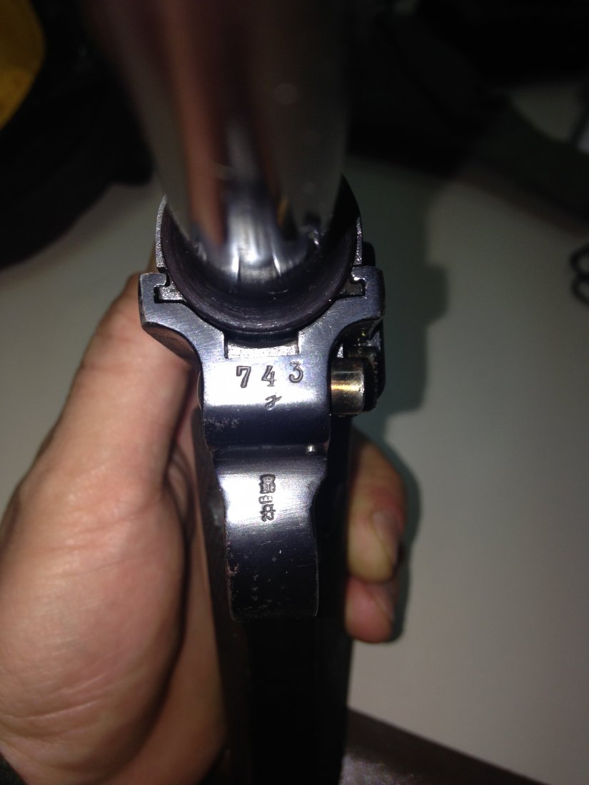

Hi all.
A friend has this Erfurt Luger but he has no clue about its provenance...
It is a 9mm all matching ( except the mag) Luger which apparently mantains almost all its original finish
I don't know nothing about Imperial Lugers so could you help me to identify it please?
Regards
Pedro

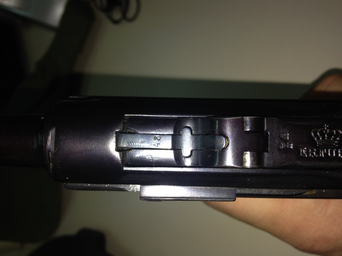

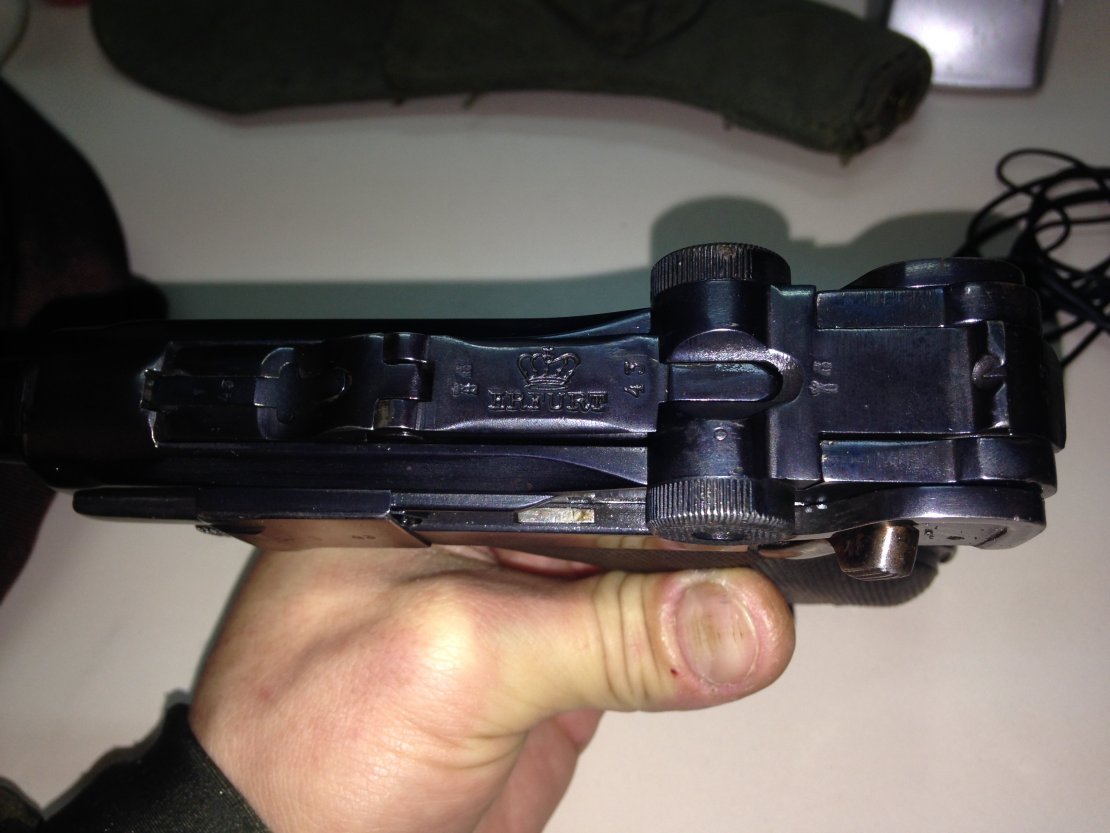

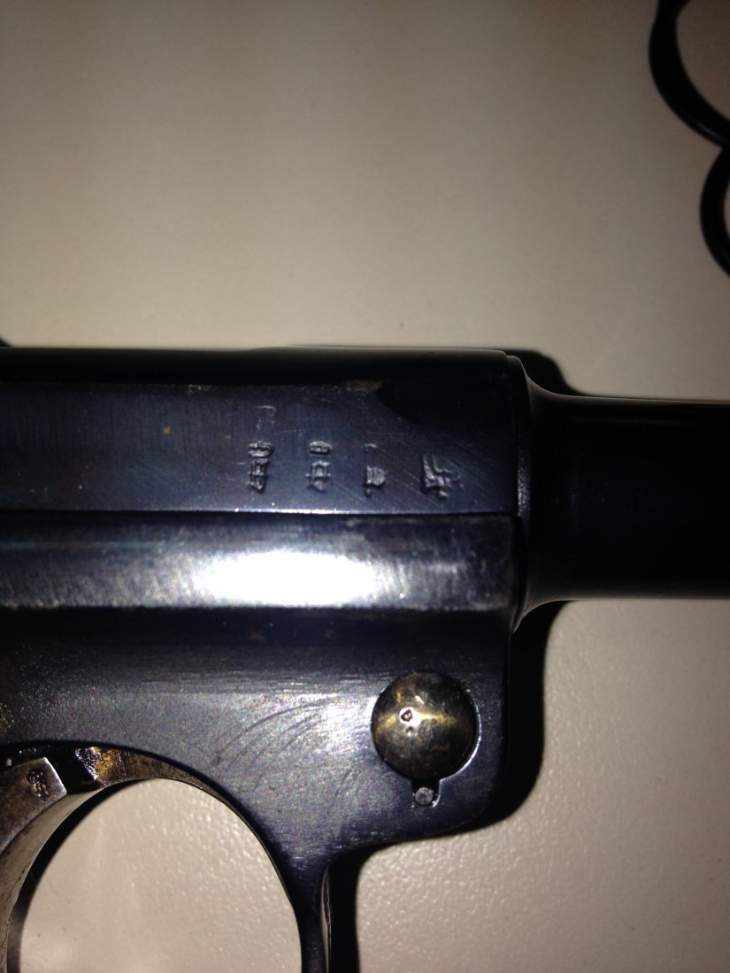

If you need some close ups of an specific area just ask for them
Thanks a lot!

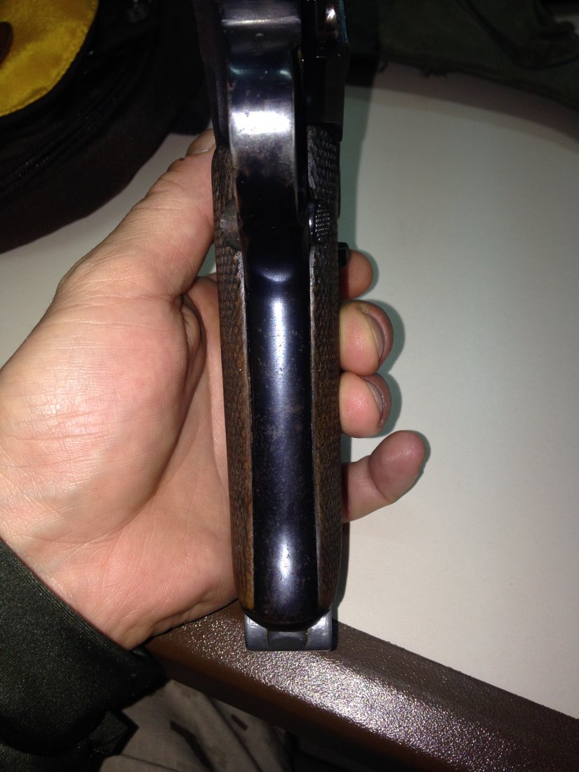

Last pics.
Hope you like them and know something about this Luger!

Can you get us some photos in a natural light, such as daylight but not under direct sunshine? To me it is looking like it has been reblued, but need to see photos without flash. Also include the muzzle from the front and closeups of the tiny pin sticking up on the left top side of the round toggle knob?
Thanks.
Unread 01-20-2015, 07:57 PM   #5
It's had the year date scrubbed off the chamber and been terribly reblued.
The following 4 members says Thank You to George Anderson for your post:
Unread 01-20-2015, 08:49 PM   #6
Posts: 2,674
Thanks: 3,245
George is correct as usual. Very poor rebluing. Wrong color. Also my bet is restrawed. Might make a good shooter but not a collectible. Bill
Unread 01-20-2015, 10:02 PM   #7
Why do re finishers hate dates? You see this type of molestation quite often.
Unread 01-21-2015, 04:33 AM   #8
Posts: 3,403
Thanks: 7,569
Pedro,
Sorry about the bad news, but the silver lining is that your friend can take this to the range and shoot the wheels off it (as I've heard said...) without worrying about diminishing its value in any way. What can be said about it is that was built before the end of the First World War by the Erfurt Arsenal, under contract to the military. The date over the chamber has been removed, and there's really no way to know now in which year it was made. Each part should have its own little proof, stamped at the factory--down to the grip screws, if I'm not mistaken, and this sets them apart. If your friend's pistol were in original condition, even if it's a little rough, collectors would be all over it!
