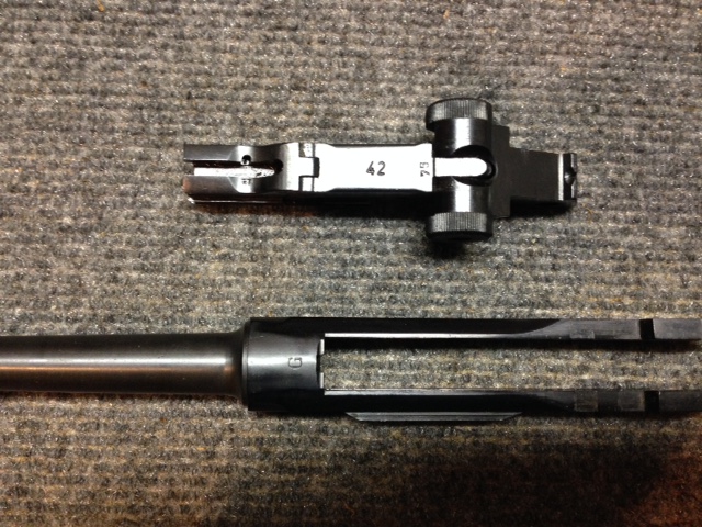

Well my original topic was strawing and you guys answered that, but now I'm more than just a bit interested in the "42" on the toggle versus the "S/42" which was on all old "G" Lugers. Did some digging and found a "supposedly" matching serial number "G" Luger with only "byf" on the front toggle, that had been sold at auction. So here are 2 possibilities for you experts to ponder:
First, we know my Luger was refinished. Apparently Mauser did take some guns in and refinish them in the early 40's. So a factory refinish ? This would explain the factory-quality numbering on the "replacement" toggle, and maybe also the loss of straw, since after 1937 Mauser quit strawing Lugers. Also, Mauser was using "42", "S/42" and "Mauser" banner after 1937, and "byf" after 1941.
Second, could it be a case of a "42" toggle straight from the factory, for a few guns ? Reason I ask is that it turns out that Mauser was given permission to use "42" in addition to "S/42" beginning of 1936. I know Lugers are notorious for oddball markings and production. Is it possible my "G" was made near the end of the year and so wound up with a toggle from the next production ?
Or it could be faked ! But if so, its a terrific job. I'm going with the Mauser factory refinish theory for now.

S42 changed to 42 in the middle of the 1939 production. No 42 code before then. Byf started in 1941 to end of production. As for the same number. All someone needed was a toggle with the same last two digits. Not all that difficult to find. Who knows for sure but facts are facts. Should make a great shooter but not a high end collectible. Bill

OK thanks Bill. I was never under the impression that this would be a high end find.....and I'm always on the lookout for a better piece. I am attaching 3 more photos showing the 3 parts of the toggle, and the "42" plus the serial numbered "75"(gun is "5775"). Also on the inside of the toggle are 2 marks: one looks like a number "3" and the other is just too small a proof for me to tell, but perhaps you guys know. These stamps are on both toggle parts, excluding the firing pin holder (for lack of a better word). Maybe these marks designate a refinish of some sort. But now we're getting into identity which is off course, so I will go ahead and re-straw and eventually post the results.

The inside marks are inspectors marks. Bill
