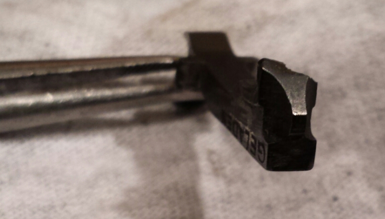

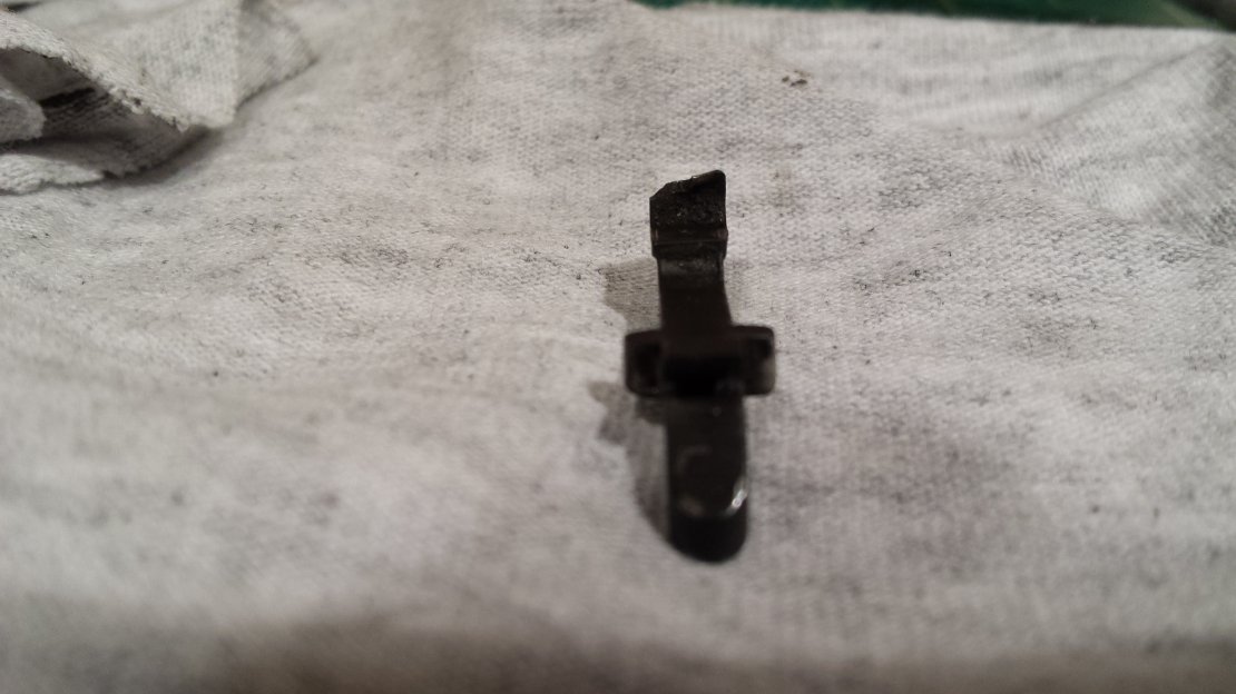

When i took the gun apart after shooting I noticed this nastiness on the business end of the extractor (see pics)
I'm surprised it ejected at all!
So I'm wondering if any of you have ever had a piece like this to be built up with micro welding, then machined it back down to proper shape. I think this is my preferred route.
Aside from that, i could simply replace it. What do you all think? I'd appreciate any ideas on rough cost for these options, if you know.
Recoil energy is transferred to the bolt without extractor, the empty case also got its share of recoil energy, but the weight empty case is too small, its share of recoil energy is consumed quickly by attrition. The function of extractor is to bind light-weight case with heavy bolt, so the empty case can be reliably extracted and then ejected. Without this extractor binding,,, at least on Astra 900 (a type of Spanish Broomhandle), 6 or 7 cases can be ejected, 3-4 rounds fail. Pistol becomes unreliable, but still works 60-70% of time.

Look into laser welding. With that technique it is possible to weld on the square mm...
Unread 11-24-2014, 06:32 PM   #9
Thanks: 2,750
If you are able to get your numbered extractor welded, and I hope that you can, I would suggest that you not use it for range work again. An aftermarket extractor is relatively inexpensive, and usually requires only minimal fitting to be 100% functional. Then if you were to break the aftermarket unit....no harm, no foul!!
I have broken 2-3 of these old extractors over the years(I shoot my Lugers a lot) and just install new aftermarket ones for function. The new steel holds up very well at the range.
Unread 11-24-2014, 08:56 PM   #10
Is it a numbered part? If yes, laser welding is an option. For laser welding service, I recommend Microarc Welding in Worcester MA:
http://microarcwelding.com/
They offer excellent service, including post-welding micro-machining. Cost some $$, but it's definitely a new experience. There are a few gun makers in the area, they use laser welding service for prototype modification, much faster and cheaper than changing the "jigs".

Microarc can and will do the work. $100--reasonable. (weld up + shape)
In the meantime i purchased one of the reproduction pieces on ebay, $35. the thing is pretty freakin ugly, makes the original look like a gem, and i would definitely pay the extra $15 for the genuine article if i could do it over. It is fitted to the gun now. I plan on going back to the range this weekend to see if it does what it's supposed to.

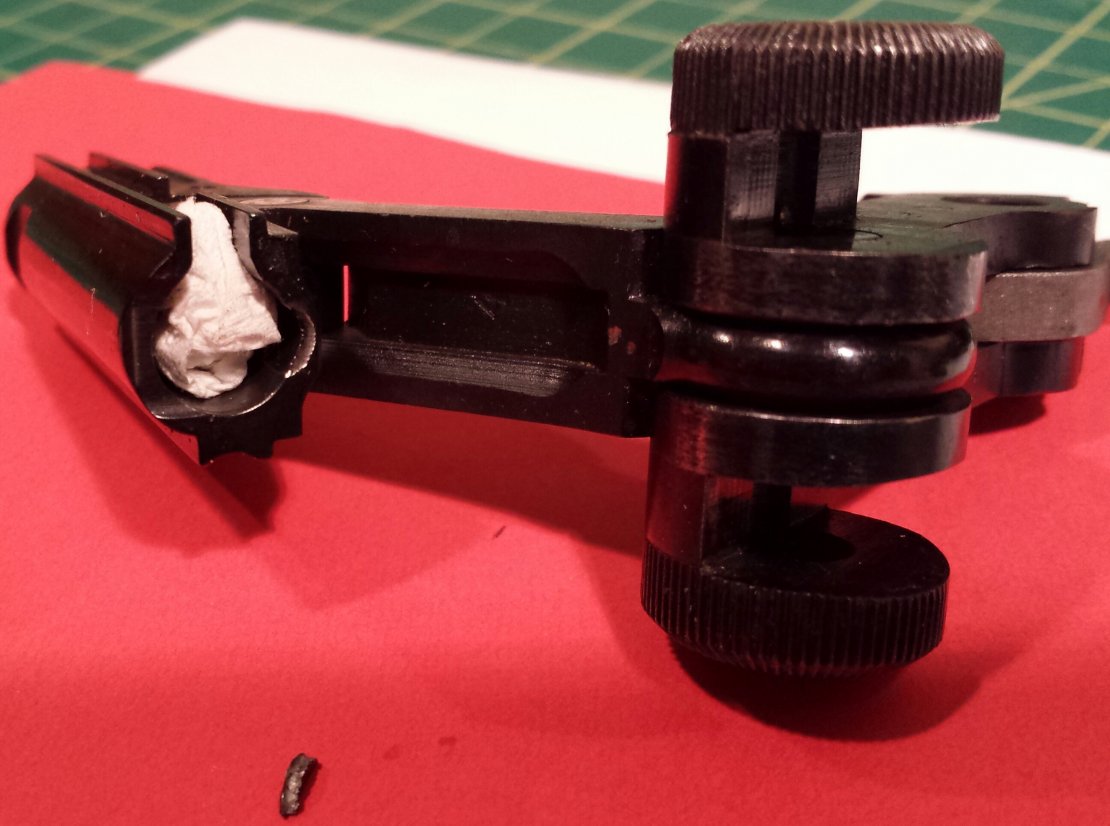

More fun info.
Got back to the range this morning to prove the new extractor.
Made 5 shots, ejected cases perfectly... then, broke my breech block--Yaaaay!
A little half-moon shaped section of the back wall (at 12 oclock pos.) that holds in the firing pin spring retainer decided it wanted to be elsewhere... and did indeed go gleefully to that place.
Long drive, short day.
I'm beginning to think I should do what my dad did: Put gun in box in basement, never look at gun.
