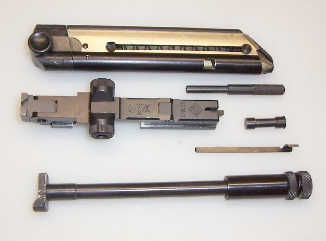

I get ..299" [7.6mm] for my 'insert diameter' (actual measurement). And with .224" bullet diameter [bottom of groove], that gives .037" wall thickness for the 30 cal insert.
Paper clip thickness.
BTW: Here's a pic of the 9mm/.22LR conversion 'kit' that I dug up somewhere, showing all parts.

Unread 09-12-2014, 10:01 PM   #9

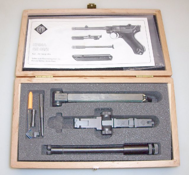

OAL of a Stinger is basically the same, however case length is approx. 0.10 longer. The 32 gr bullet (v. 40 gr) would be a tad shorter, right? The conversion is s blow-back action--how would this affect pressure in the barrel? The Stingers were effective in breaking toggles in both the 4" and 12" barreled models. CCI Velocitors' velocity is in between Stingers and Mini-Mags, so that's another choice, if you think the shortened liner would work with them. I'll never again use anything more potent than the Mini-Mags in these Ermas, whether pistol or kit.
This kit in your pic is the SE-08/2, which has the knurled toggle knobs--much more attractive than the stubs of the earlier models. It reverts, however, to the replacement ejector v. feed lip ejector, and the replacement axle with its bushings, as in the versions made up until the end of WWII.
The shortened liner setup does look a little less goofy.
Here's a pic of mine. The other pic is my Ibanez P-bass knock-off, finally complete. It was missing the "ashtray" covers when I bought it 20 some years ago. The frets were literally falling out, and I installed new ones and leveled them, then had the Ithaca Guitar Works crown them and do the final setup. I had looked for replacement covers back then, to no avail, at the local shops--one even specialized in vintage stuff, and the Ibanez dealer couldn't help either. The internet makes such searches a lot easier, and I was able to come up with a OEM set by Fender for twenty bucks shipped, in about ten minutes.

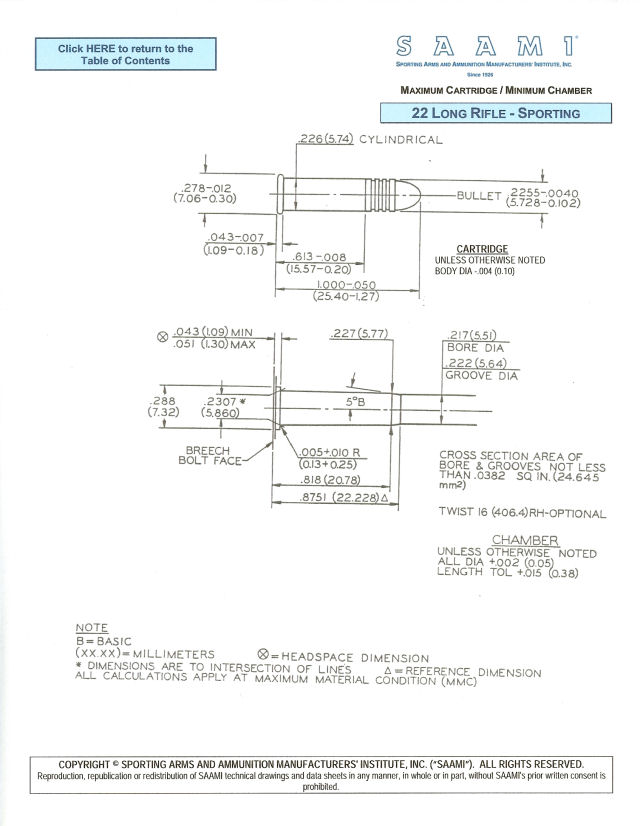

So the Stinger is actually longer than a .22 Long Rifle??? Here's the SAAMI print; cartridge on top, chamber on bottom. The bullet is the same diameter as the case so the [smoothbore] chamber is longer than say a 9mm Luger chamber...To accommodate the same-diameter-as-case bullet...
So a Stinger chamber would have to be longer than a Long Rifle chamber, to accommodate the longer case + bullet...
And it stands to reason that if a Stinger is longer, it won't fit in a .22 LR chamber...Like a Ruger Mk II...

Dave, that .22 conversion unit of yours is quite different from the 4" unit that I have here...Obviously the barrel insert is longer [lots longer] but the toggle assembly is completely different...
Without the spacer, the insert I have here would just barely fit a 5 1/4" barrel...Which would be a 130+mm Luger 9mm barrel...If there ever was such a thing...
The 'cocked' indicator is a hoot...

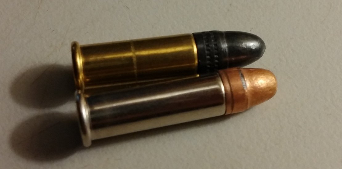

Stinger in silver case and copper plated HP 32 gr. bullet 1640 fps v. Remington Target in brass, 40 gr.LRN 1150 fps. OAL 1.182 and 1.186. respectively. The shape of the end of the slug makes the Stinger look longer, and maybe foreshortening in the pic.
The case is what's longer, but since the round's O.D. is constant overall, as mentioned, this would not require chamber mod. They are labeled 22lr and chamber just fine.
You're right, the rod sticking out the back when the sear is set is funky. It would indicate that it's cocked, but not indicate whether there is a round in the chamber.
Without the adapter sleeve my liner would fit a barrel around 7" long, stopping short of being OK for an Arty barrel.
