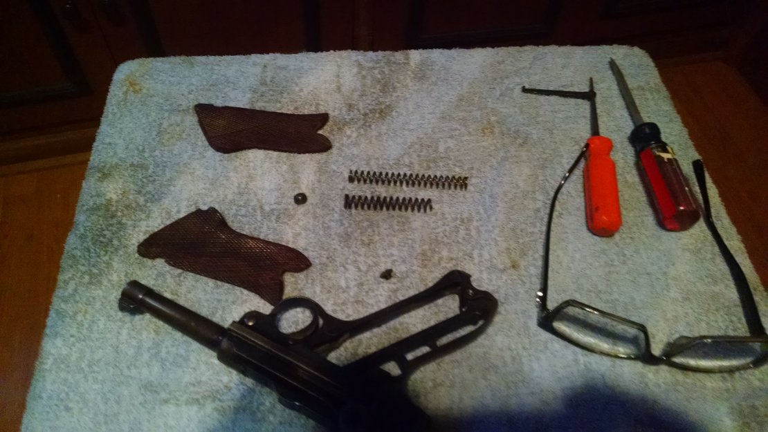

The replacement unit from my spring kit is substantially longer than the original. Is this acceptable?

That is 100% normal. The new recoil spring has not taken a "set" as yet. Once it is installed and used for a bit, the overall length will be reduced.....No problem.

Whew.......tougher job than I thought, especially with the extra spring length. Have to regroup and try again tomorrow.

Wow.....the extra length on the spring made it a real booger. Kept modifying by little homemade tool and finally got it. Action feels MUCH better now. Cant wait to get to the range to see if this cures the problem.
