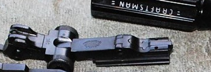

The holes are drilled through to the breech block chamber. They do appear to be vents. They also appear to be factory, but I'm only a novice. If it is an after factory modification, any idea if it was done in the U.S. or Europe? I have included an image with my Mauser for comparison. I wish I had my good camera. Thank you, Bernie.

Thank you for the additional photo of the breechblock. I have never seen this mod on a Luger before. There is sooooo much to learn concerning P-08s.

I thought vents holes at first too but the picture of the breachblock looks strange to me and the more I looked at it the more concern I had. It is most likely a trick of the camera but what is that groove near the top front nearest you?
interesting!

Considering that it is the first of its kind that we have seen, it will be pretty difficult to determine where or when it was done. However we seem to be well on the way to "why".
So if the holes end in the firing pin chamber, is the breach block weakened to the point that it should not be shot?
If it were mine, I'd be at the range right now. Just checking it after each shot or 2...
I don't see the holes as a major threat to structural integrity... .
I don't think I have ever quoted myself before!
