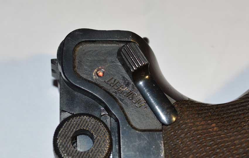

For what I know there is a bit of a confusion among Mauser Lugers "with" the hump and others "without" it. I might be wrong but there is not a precise date when they started to remove the thickened back frame to make the so called hump.
For instance I've got a "K" one wihout hump, while another one dated 1938 has go it.
IMHO

Hello alanint! MAny thank for the input, I took abother photo and from my point of view the hump is here. Please take a look.
Yup, that's a hump. Better pic than the one in the FAQ...
Unread 05-15-2014, 11:05 AM   #18
Input from Frank Manders to me via PM:
The Mauser Hump occurred at about 5800s in 1937. After which all Military Mausers had the hump.
But, before that, they experimented with the hump in 1934 (K-Date). The early Lugers up to S/N 2500 mostly were humped, then mostly not humped to S/N 5500, then mostly humped until the end of 1934 production.

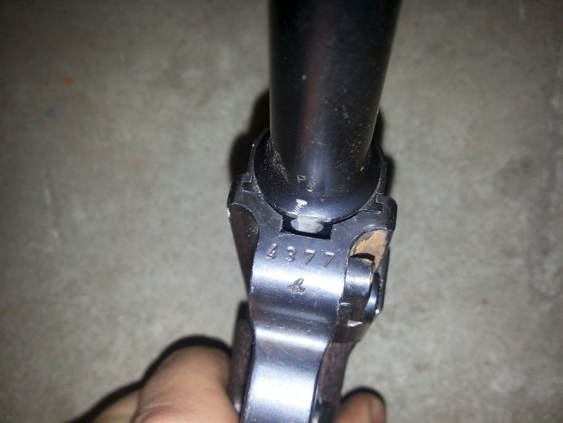

PSE marking mistery has been resolved. I had a talk with a vendor from whom this gun was offered to me- he has more those PSE marked re-barelled P08's and I examined them all. All guns are re-barelled and have this mark. He told he purchased this lot from Norway, all guns he has seen with PSE marks before were coming from there only. Thus I guess this code is Norwegian acceptance/proof/gunsmith mark.
Hope this hepls! Many thanks to all for great help provided!
Another one PSE marked Luger from the him.

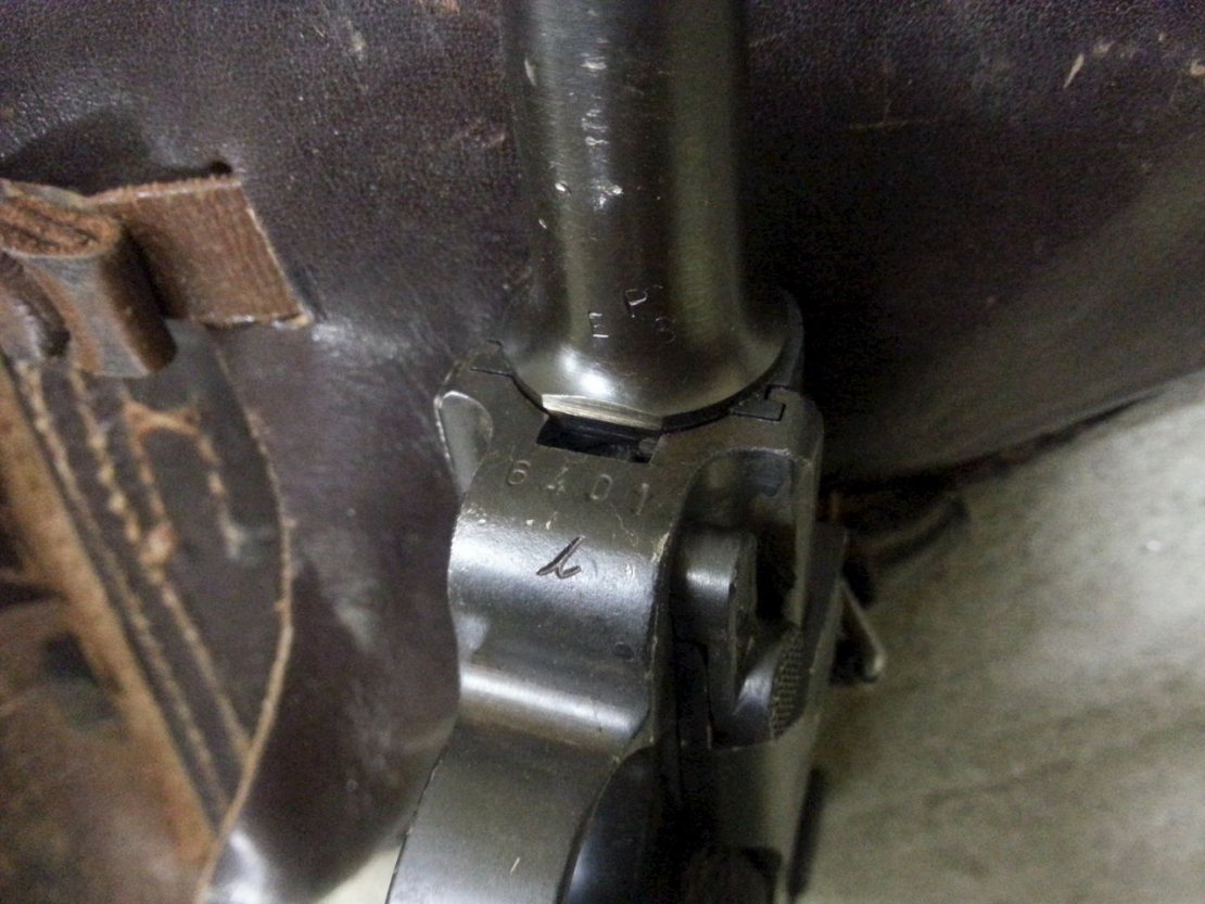

and another one. Bought from Norway, PSE marked and re-barreled.
