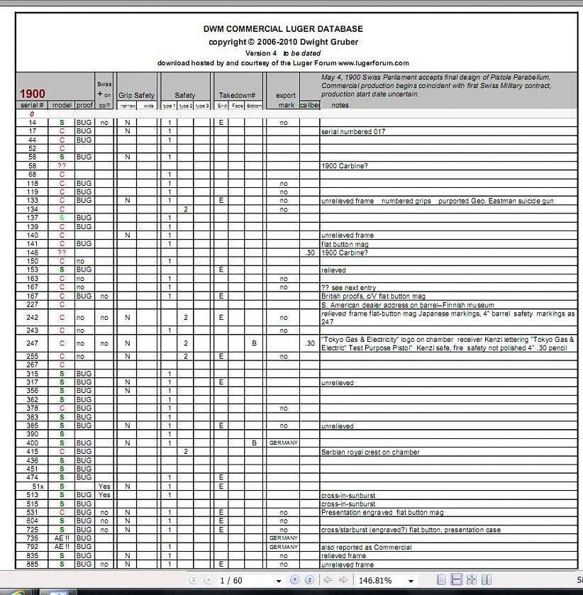

Unread 05-08-2013, 09:02 PM   #4
Dwight, no it isn't, at least I could read the posting AND download the pdf?
NOTE: JUST THE FIRST PAGE

This one works for me: http://forum.lugerforum.com/attachme...7&d=1314286635
