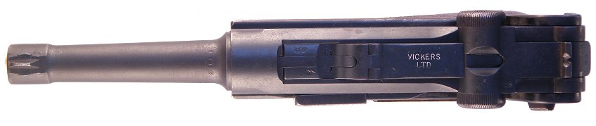

There is no problem, it's absolutely normal.
Whatever you do: DON'T SHOOT IT. Vickers lugers are rare, parts are numbered and impossible to find correct replacements for. You will turn your $3000+ pistol in a $1000- gun in one go if you are unlucky.
If you feel the need to shoot a luger, pick up a shooter grade pistol and play with that instead.
Can you post pictures of the magazines? Dutch magazines are unnumbered and there were several variations.

I also would like to see more photos, magazines and gun. It looks like the ID plate is ?.H XXI/17. Is the letter that precedes the "H" a "R" or "L". Your Vickers Luger was issued to either the "Rignt Half" or the "Left Half" of the 21st Infantry Battalion, weapon number 17. I have a Vickers that was issued to the Left Half of the 21st, weapon number 12!
The "QS" on your magazine is actually a "GS" and indicates that it was made or overhauled at the government arsenal in Indonesia. It is an original and proper replacement magazine for Dutch Lugers.
You have a very desirable Luger in nice condition. The recommendation not to fire it should be taken very seriously. Thank you for sharing it with us.
