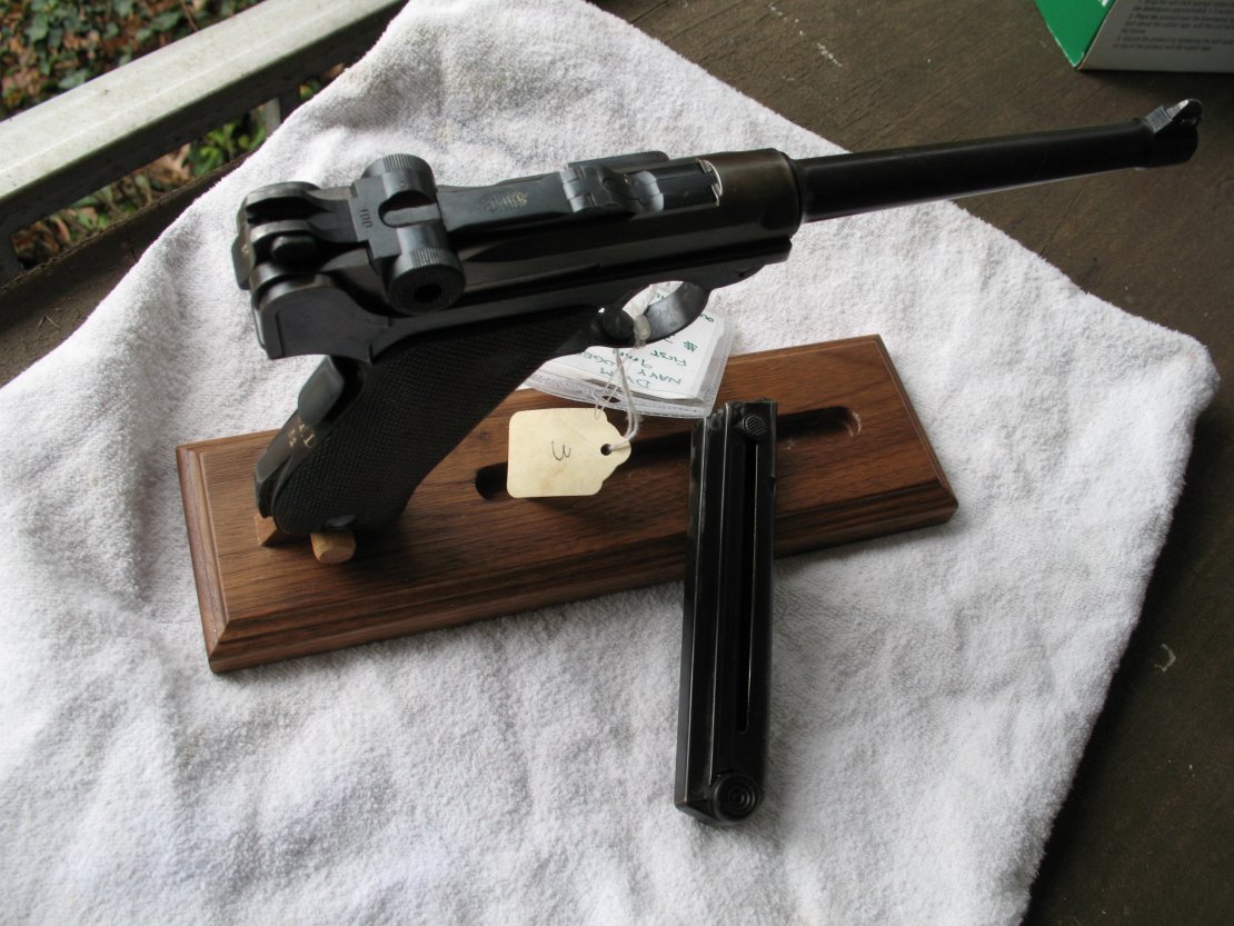

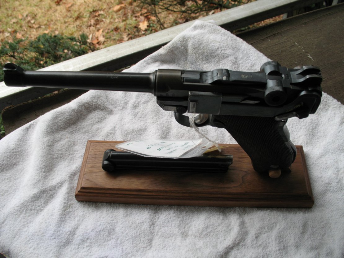

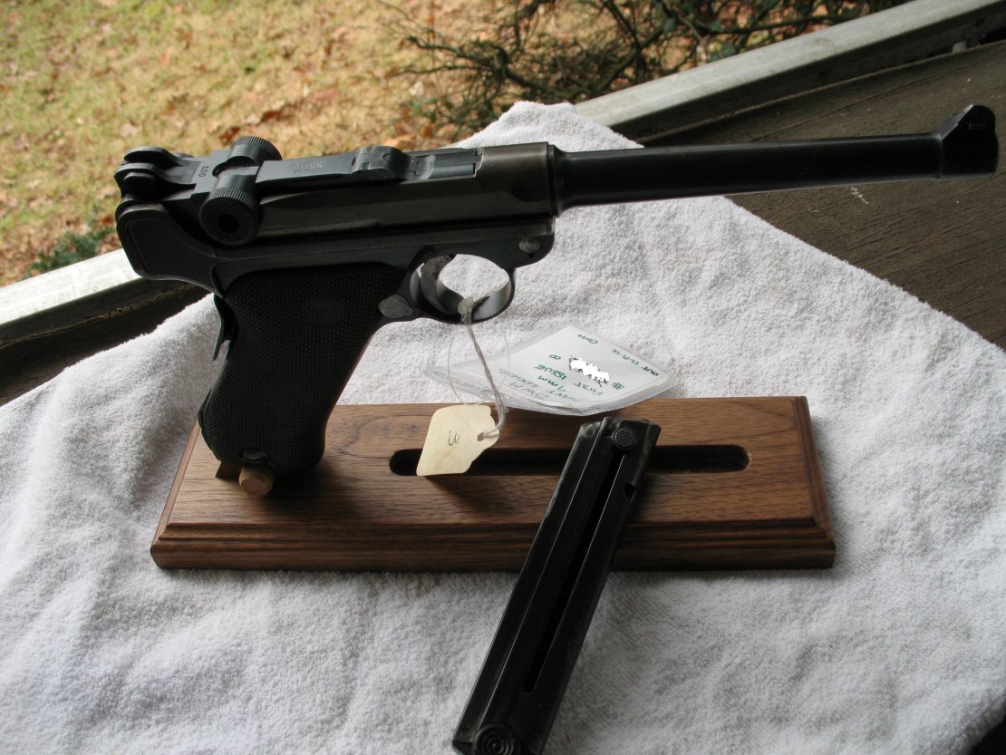

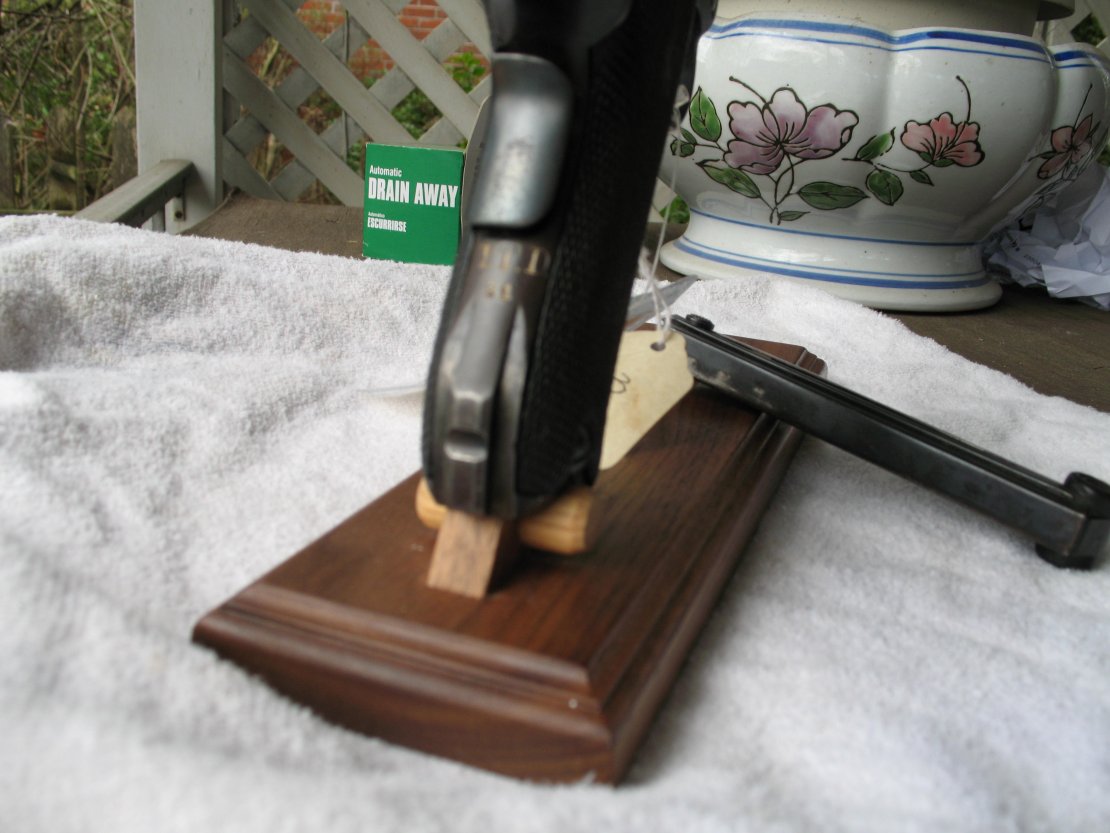

Here she is. She may not be beautiful but she is pretty; and she's all mine. Got her from Turners. They got 15 Lugers about a month ago. What an ordeal - purchasing thru a Calif. company. Anyone wants to hear the gory details, let me know.
She is still in the process of getting cleaned up. Yep, you guessed it: a Christmas present, from my honey. But I agreed to check the gun out and then it becomes a present, under the tree, until gift exchange time.

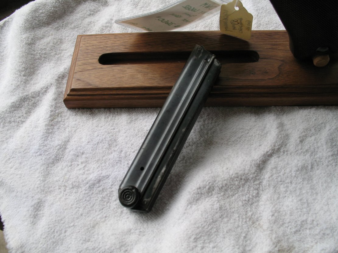

O.K. guys, I need some of you to step up to the plate and help with the questions in Item # 4. The issues with the bluing, grip number off by 9 digits and also the magazine has faint numbers that aren't correct. Things to be concerned about?? I remember some comments along those lines that stated some leeway should be considered since we are talking about Navy's and what they have been through and how rare they are, etc.

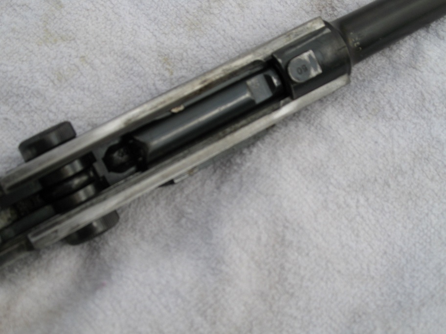

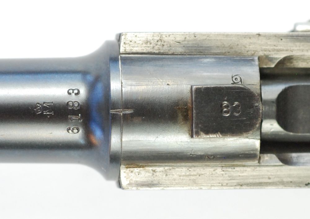

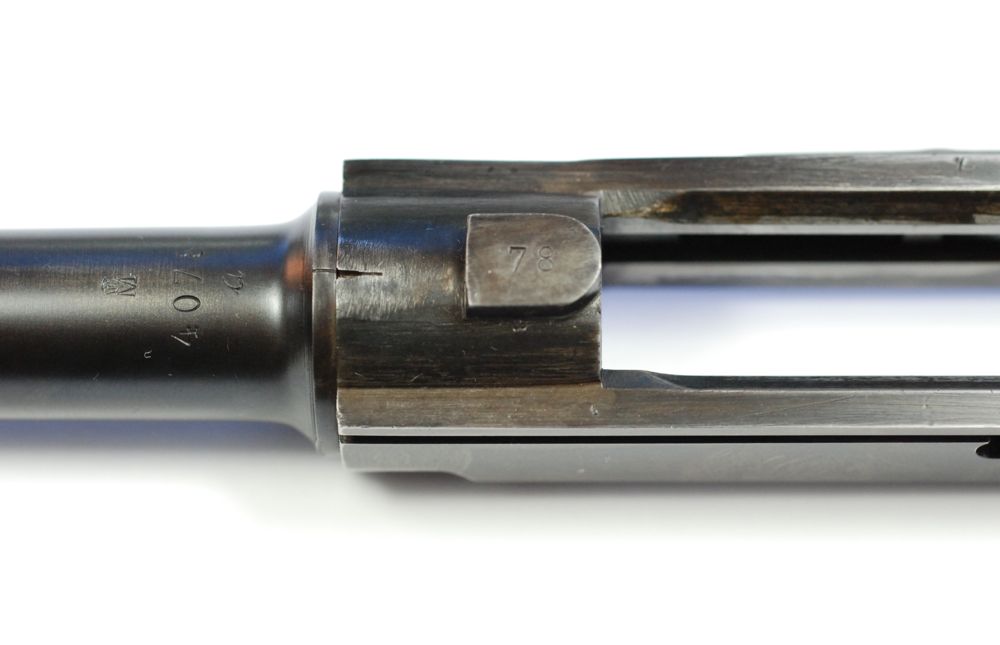

Hi Jack, If you can post a photo like the views shown below, we should be able to tell if your gun has been re-blued. I wouldn't expect barrel serial halos on a no suffix 1906 Navy like yours, but the receiver rails should be "in the white". The first photo shows a gun with original finish, the second, one that has been re-blued (among other things).
Regards, Norm

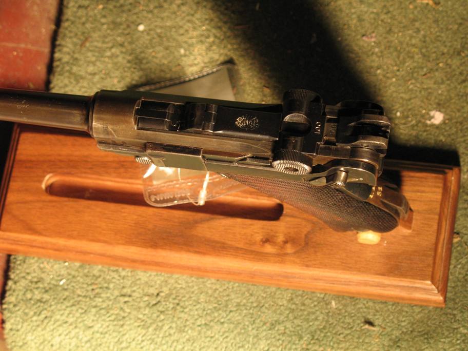

Unread 12-17-2012, 02:55 PM   #15
CAP Black
CAP Black's Avatar
Join Date: Dec 2008
Posts: 767
Thanks: 100
Thanked 174 Times in 96 Posts
I got what I hope is a good shot. On a rainy day I got a few rays of sunshine at noon. So here goes.
Jack
Unread 12-17-2012, 03:50 PM   #16

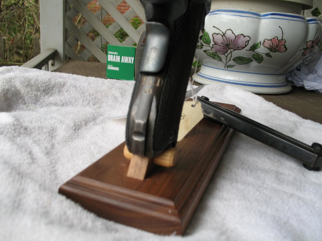

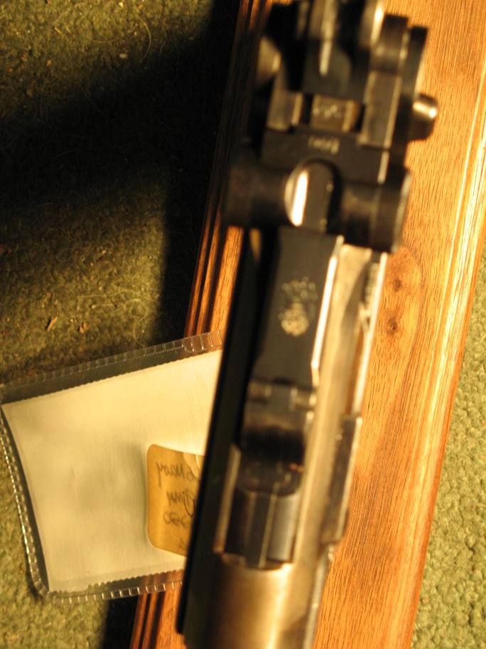

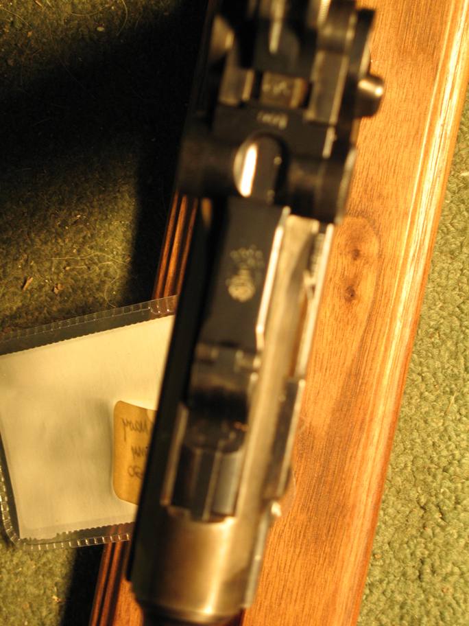

Hi Jack, Well the receiver looks righteous, and it's difficult to believe that someone would refinish the barrel without touching the receiver. Just to make sure though, try to take a sharp, clear photo of the top half of the gun showing the barrel, toggle train and rear sight extended to the 200m position.
Best regards, Norm

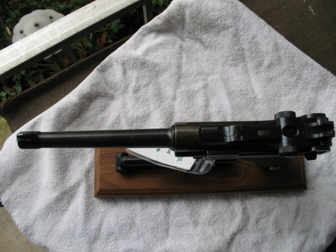

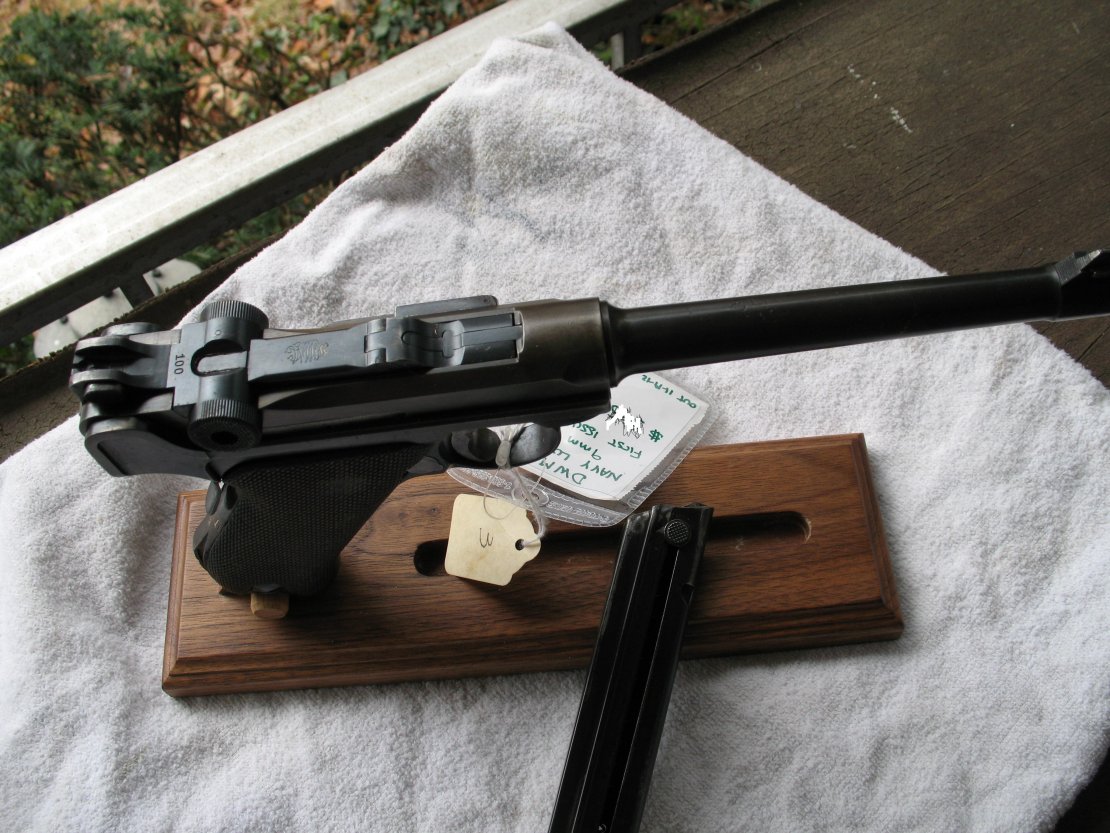

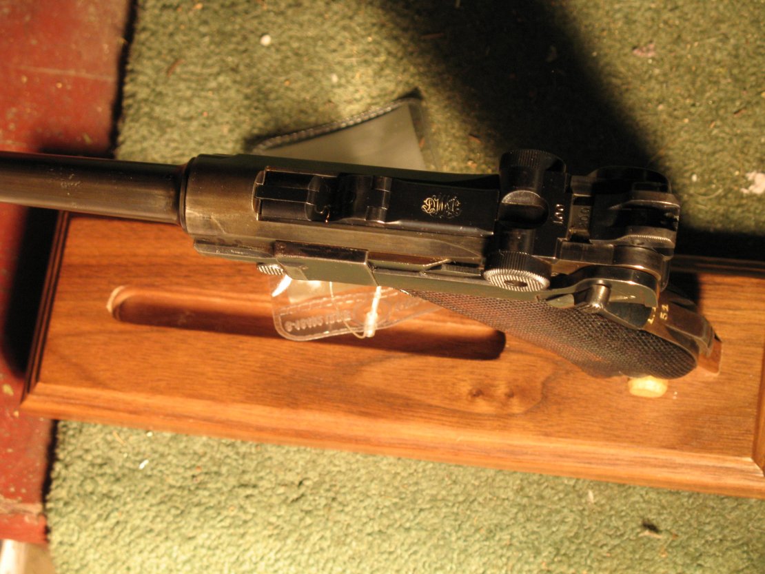

Default new pics

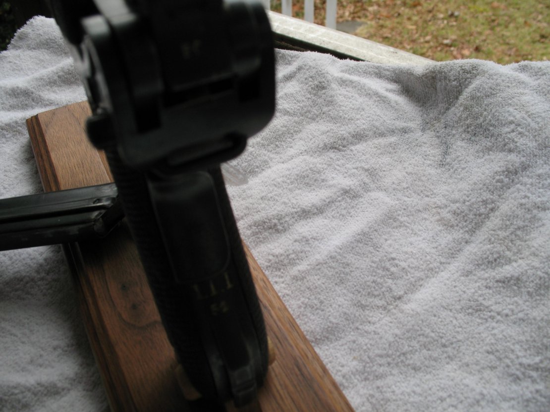

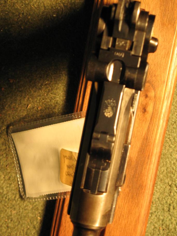

It's raining cats and dogs here and dark; so I had to move indoors and try to rig up some powerful lights and not have glare. Here they are, we shall see.
Jack

Unread 12-17-2012, 09:02 PM   #18
Hi Jack, I wish we had better photos to work with. Although the toggle train appear noticeably darker than the rest of the pistol, it doesn't look like it's been buffed, and I think the small vertical pin in the left toggle is still in the white, as it should be. Do all the serials match? The breech block is numbered on it's left side, and the middle toggle underneath in the recess.
Regards, Norm
Unread 12-17-2012, 10:42 PM   #19
Posts: 3,405
Thanks: 7,578
Thanked 2,654 Times in 1,396 Posts
Jack, here's a suggestion for the pics. The gun is blurry and the base of the display stand is in sharp focus, so we need to work on focusing on the gun. This is a digital camera, right? Try making sure it's in macro mode, the flower as opposed to the group of people. You should be able to fill the entire frame of the pic with the top of the gun, all in focus. The automatic focus function of the camera may also be to blame. There are a few ways auto focus is done, averaged, center-weighted, and spot. It may be that the auto focus is picking up more background than gun, and focusing on that, in which case getting in closer will help.
But how, you say, do I prevent my shadow from interfering if I get in close? If you're using strong lights, have one on each side, each at 45 degrees from the object, and from the line between it and you. This also helps eliminate glare in that the strong light in this setup generally bounces over to the other side of a flat surface, instead of back at the camera. Rounded surfaces will have a highlight here and there, but you'll be able to move the lights around and adjust where this occurs. Set up so that what you want to see is visible, and you are comfortable, then move in the lights. I hope this helps!
D.
Unread 12-18-2012, 12:34 AM   #20
CAP Black
CAP Black's Avatar
Join Date: Dec 2008
Posts: 767
Thanks: 100
Norm:
Yes, the serials all match and appear to be in the proper places. That toggle pin is in the white.
