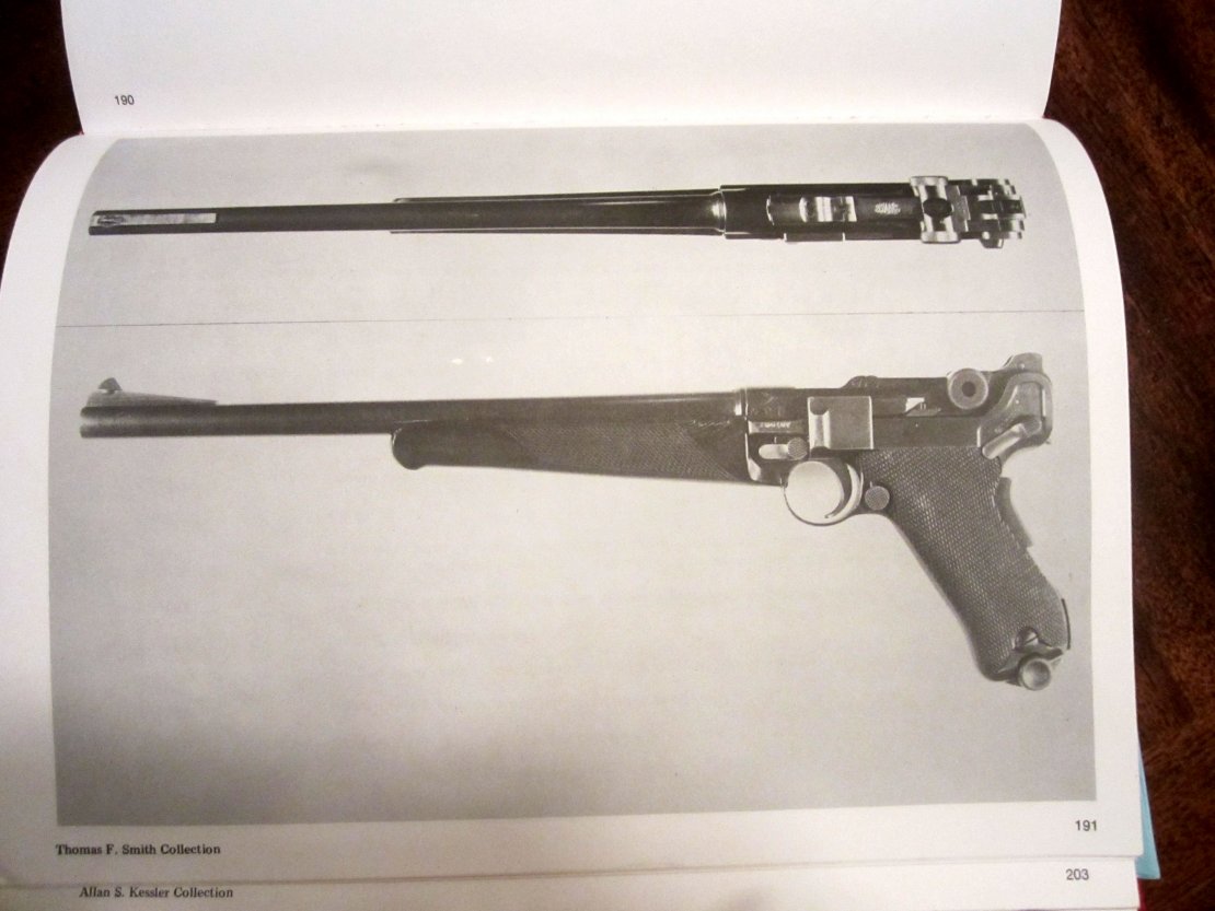

Default 1920 navy carbine
I attached a picture of one in Kenyan.
