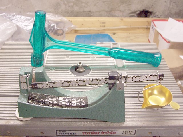

I got a box of 7.62 Tokarev in from Midway; I don't plan to shoot it as is, but disassemble it, reload it, and use it in my 7.63 Mauser M30...
So I used my RCBS kinetic bullet puller to pull the bullets. I saved the powder, after weighing 11 rounds of it. Due to static friction in the cases and the puller, the weights shown in the pic are not exact. They are good enough for me to get an idea of how much PPU put in each cartridge. 9 grains seems to be the average. The powder itself seems to be 'cut round flakes'...or maybe 'flattened ball'...
The cases are headstamped PPU over 7,62 TT.
Bullets are 86gr FMJ with an open base (lead showing) and measure .308".
I've never heard of PPU, but the box says "Made in Serbia"...Edit: OK, it is Prvi Partizan ammo...
I plan on shooting the cases & bullets but I'm undecided on the powder...I might try 5 grains of it just to see how it performs...
I have sufficient 7.65 Luger loaded cartridges, but re-forming these PPU Tokarev cases to 7.65 Luger would be quite simple...
I might save the 86gr bullets for my Luger reloads, and use drilled out 110gr 30 carbine bullets for my Mauser...
Anybody have any thoughts on re-using the PPU powder (reduced loads)???
Edit: Someone had mentioned (in this forum or maybe another) re-barreling a Colt automatic in 38 Super to the 7.62 Tokarev/7.63 Mauser cartridge...I hadn't thought of that...The Tokarev/Mauser cartridge is only .080" longer than the 38 Super...Hmmmmm...

Gee, Rich, thats a lotta work considering PPU also sells loads in .30 Mauser!
Unread 01-29-2012, 02:00 PM   #3
Midway shows it in stock, too...But then what would I post about???
(I would still pull the bullets & change powders & charges)...
Midway shows the 30 Mauser 85gr FMJ Prvi Muzzle Velocity @ 1509 fps...Lyman 45th Edition Reloading Handbook shows 30 Mauser "Factory Duplication Load" (4.8gr Bullseye) w/85gr FMJ @ 1174fps...that's a big jump...

I would say that that is a HUGE difference in fps!!! If it were me, I would likely start out with 4.4-4.5gr of Bullseye, and see how that goes. I have no knowledge of PPU powder as to whether it is fast-slow burner. I would test on the safe side for me, and my pistol.

Those specs for the PPU .30 Mauser seem way over the top....I've fired it thru my Broom and it's actually mild shooting....I've got some Bulgarian Tokarev that I chrono'ed doing 1560fps out of my CZ52 that seems WAY hotter. I think the Lyman load is very conservative.....over the years I've always read that original .30 Mauser ran between 1300-1400 fps
