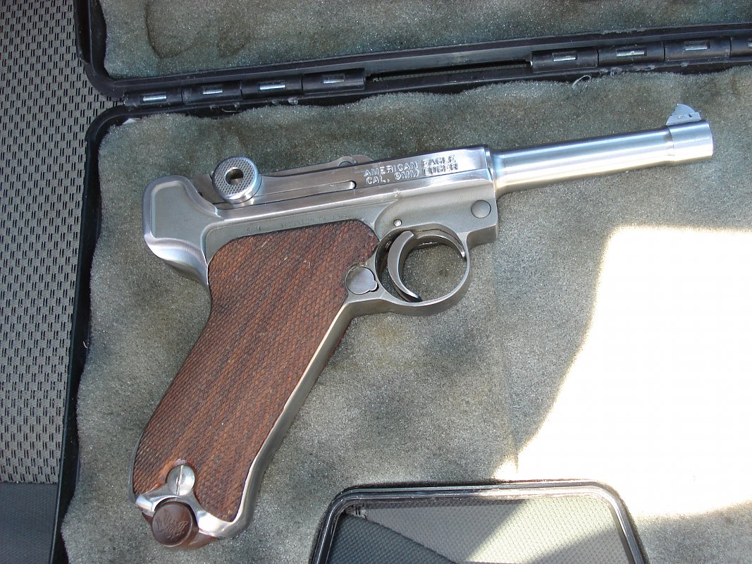

This is an american eagle ss i owned several years ago. it never functioned well and had the same problems yours did. I parted company with it , it just seemed too problamatic to hang on to. It was made in houston texas and looked pretty nice but i was not very happy with it. Not sure if this one was made by mitchell or not or american eagle was a different company.hope yours works out for you. Very nice looking pistol you have.Looking back now,perhpas i should have kept it and tried to work with it a bit more and made a good shooter out of it, oh well i could fill a very large room with the guns i might should have kept over the years.

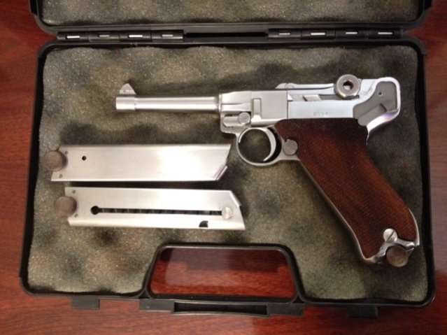

J just received 2 new Magazines that are the original to my gun, I found them on Gunbroker for $25.00 ea. (Picture below with my SS Luger)
Next week I plan to take them to the range and see if they make a difference with the toggle lock back problem.
I will let you know what I find.

Unread 02-17-2012, 03:27 PM   #12
Posts: 10,155
Historical note:
ALL of the stainless steel Lugers were made by the same company... some under contract to others, and some under the various names the manufacturer sold the pistols under.
The names include: SPM, Orimar, Mitchell, Stoeger, and AIMCO. All from Houston and all from the same manufacturer...

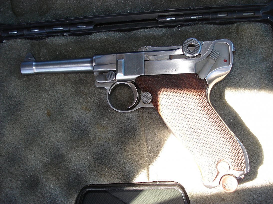

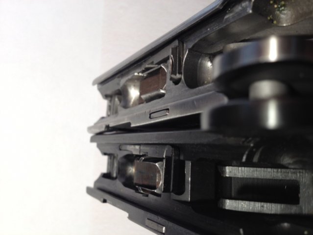

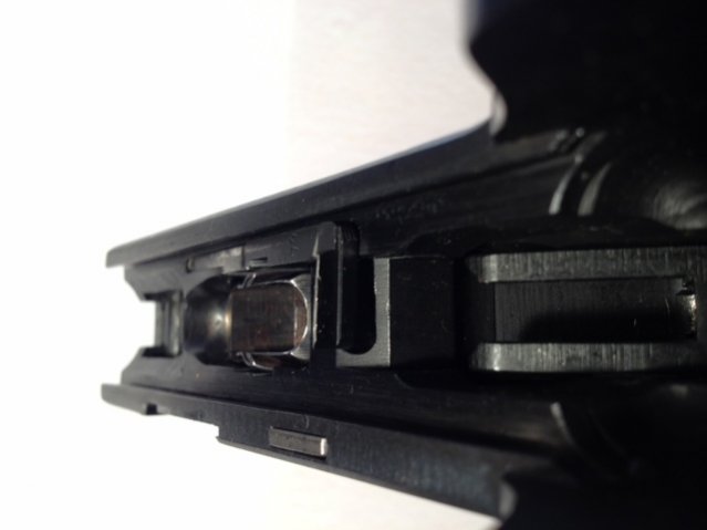

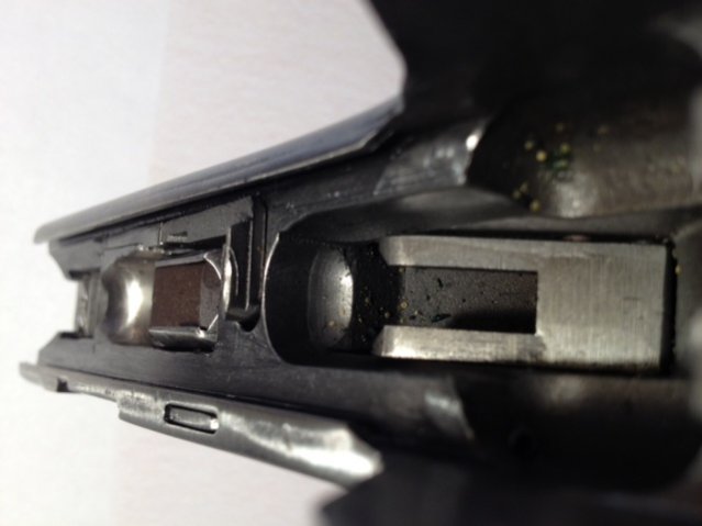

I did as you suggested as well as comparing the SS Luger to my 1936 P-08 and I found two things:
#1. The rear tip of the Hold Open Lever is warn and rounded over slightly where it contacts the indent on the underside of the Breechblock.
#2 The SS Luger Magazine does not push the Hold Open Lever as high as my 1936 model.
It looks like the Hold open lever is of the same design on both guns except one is Stainless Steel.
I have attached 3 pictures, #1 the SS Luger, #2 My 1936 P-08 and #3 the two guns side by side.
