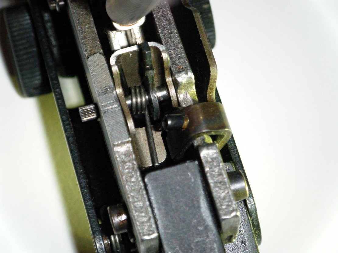

heres a pic

Stoeger produced their own version of a .22 "Luger" because they owned the legal rights to the name Luger in the USA. It bears no relationship in design to the Erma .22 toggle action guns.
Oops, John, you meant other than the toggle style blowback design, right? In both of these wannabe renditions, the toggles jump up and down in simulation of the action of real Luger toggles. But the toggles in neither the Erma nor Stoeger toggles have anything to do with locking the breech the way the big boys do, with their below-the-centerline position of the middle toggle pin. Nor do the .22's toggles come anywhere near the "ears"/ramps on the top end. They don't have to; since they're not locked, they don't need to be influenced to unlock.
I've not had the opportunity to examine a Stoeger .22 in person yet, much less strip it to examine its mechanics. They certainly look way different from Ermas in the images I've seen online, in respect to several regions on the top end, the toggles, themselves, in particular. I also think their grip setup is pretty ugly, with that little screw in the middle of them. Thanks for posting the photo of the action (?) of the Stoeger. To tell the truth, I'm having a hard time deciphering exactly what I'm seeing in it. How about a short pic essay on it, so we can be oriented a bit better?

what we are looking at is the firing assembly....the spring in question is the coil spring that you see. The instructions say that should the sear bar (the back half is shown on the right side...the piece with the pin attached) can be reinstalled by placing the rearmost pin (theres only 1) under the arm of the coil spring and it shows a diagram.....I assemble it to the diagram and the rear pin jostles loose and falls when i try to attach the front of the sear bar to the trigger.

My point about similarities/differences among Stoeger, Erma, and original Luger was that the later wannabes with toggle systems is that their toggles do not lock the breech by the knee joint locking provided by the originals. They are blowback actuated. Since neither locks like the original Luger, their toggles don't interact with the ramps, and their top ends are effectively in fixed position during the cycle. The similarity in toggle design between the Ermas and the Stoegers is that neither needs to be cammed out of battery position by encountering toggle ramps as the entire top end recoils back in the frame.
Thanks for the link to exploded view, John. Combined with Mike's description, I can now understand better what I'm looking at in Mike's pic. The spring in question is #60 in the exploded view?
The exploded view shows a major design difference, compared to Ermas--the main recoil spring is in the handle, as the originals, and not tucked horizontally into the top end, like the Ermas. The sear setup, linkage to trigger, pressed toggle parts, etc. are different, too, but the main spring was the first thing I noticed.

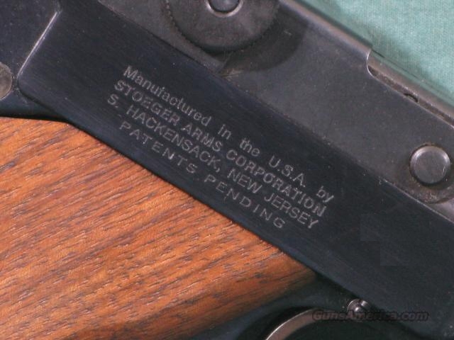

The Stoeger .22 was designed and built by Stoeger in the USA. Introduced in 1968 and made until the mid 1970's.
Here'a closeup of mine showing the manufacturer.
-ML

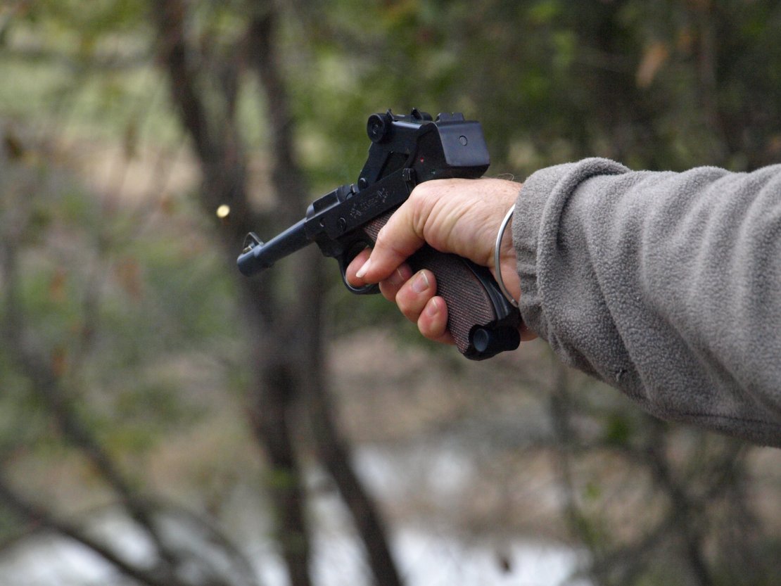

Thats the one i have, i know it is not a locked breach, but the toggle action works the same when fired, or so i thought. In the picture you can see the spent cartridge and the action starting to close.
