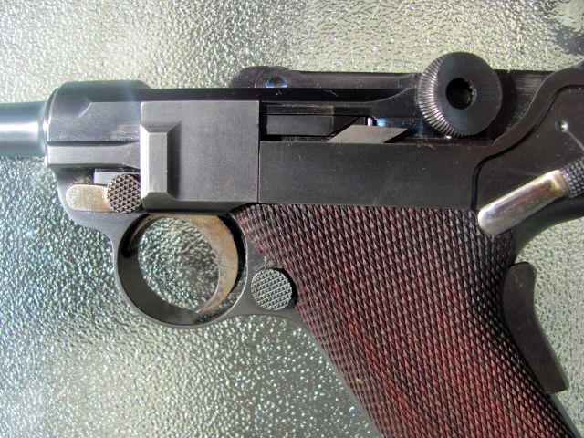

!900 Test Straw Parts. There is wear especially on the edge of the trigger
