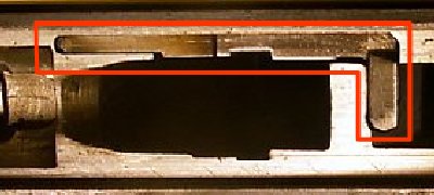

It is attached to the forward part of the hold open.

Is that looking down in the chamber?? And also, the toggle is very hard to pull back. My hands are sore.
AMBROLA is offline   Reply With Quote
Unread 07-25-2011, 03:20 PM   #7
This is looking down straight into the magazine well from the top with the upper part of the pistol removed.

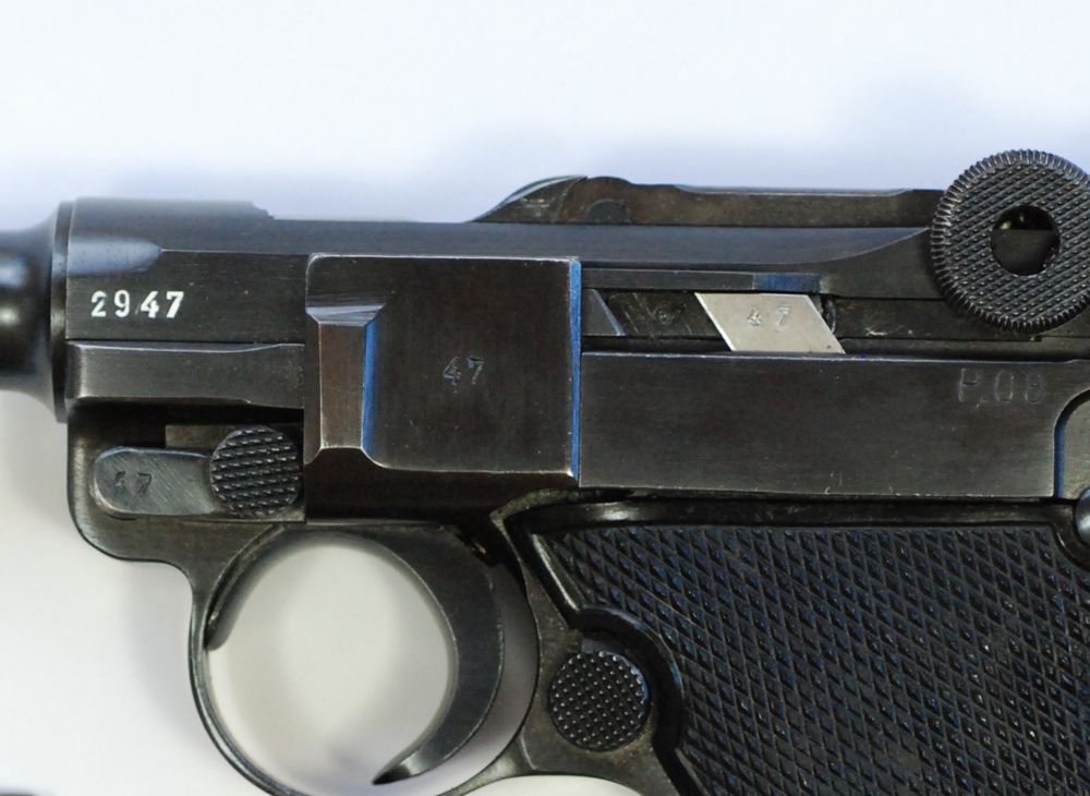

Hi Doug, My 42 byf has a numbered extractor, but it also has the same clumsily finished side-plate as Ronnie's (see photo). With the exception of that front sight blade, I think the gun is OK and well worth $800.00.
Hi Ronnie, In your first photo I notice that the magazine is not fully inserted. Was it this way when the gun did not hold open? Regards, Norm
