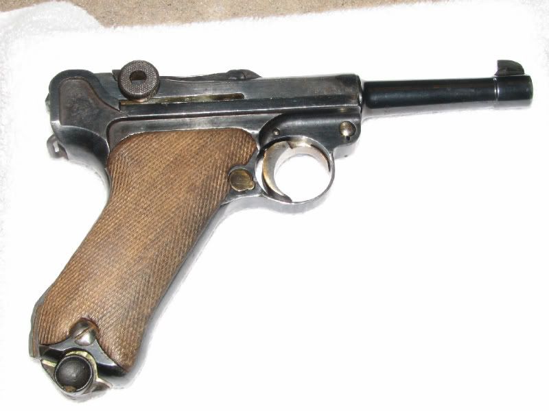

I recently acquired my first Luger, a 1917 Erfurt model in .30 caliber:
This pistol has obviously been neglected for several years as I found rust in a few areas. The action and field-strip lever were pretty sticky prior to a preliminary cleaning.
This photo is from my cell phone in flat light. I'll shoot some decent ones with a real camera when I get a minute.
As far as I can tell, it has been rebarrelled at some point, interestingly still at .309 caliber. Everything else has matching serials, including the magazine. The number on the mag is very difficult to make out due to wear but it is a match.
The bore shows no pitting and there really isn't any serious wear.
I really enjoyed stripping it down. The German engineering is fantastic in its complexity and in its simplicity. I can see why people go nuts for these.
I bought this for $800. Sound about right? I really want a shooter and I'm not so much interested in a high-value collector or museum piece. I've got some Fiocchi .30 ammo on the way. Since the barrel isn't original, maybe I'll rebarrel it to 9mm someday.
I'm no gunsmith, but the finish looks original and there isn't any flattening of the stamps or original factory metalwork as far as I can tell. The grips are slightly loose. I hope after a good cleaning they tighten up a bit.
Anything I need to watch out for before firing it? The action and the mag look to be in good shape. Everything fits well.

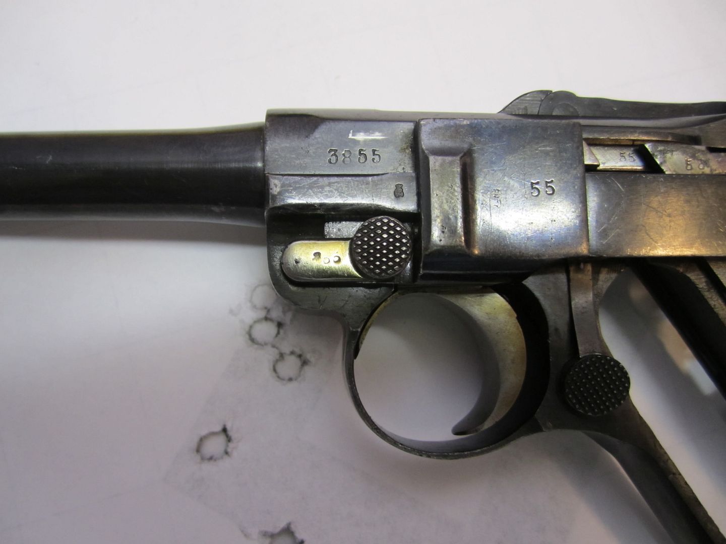

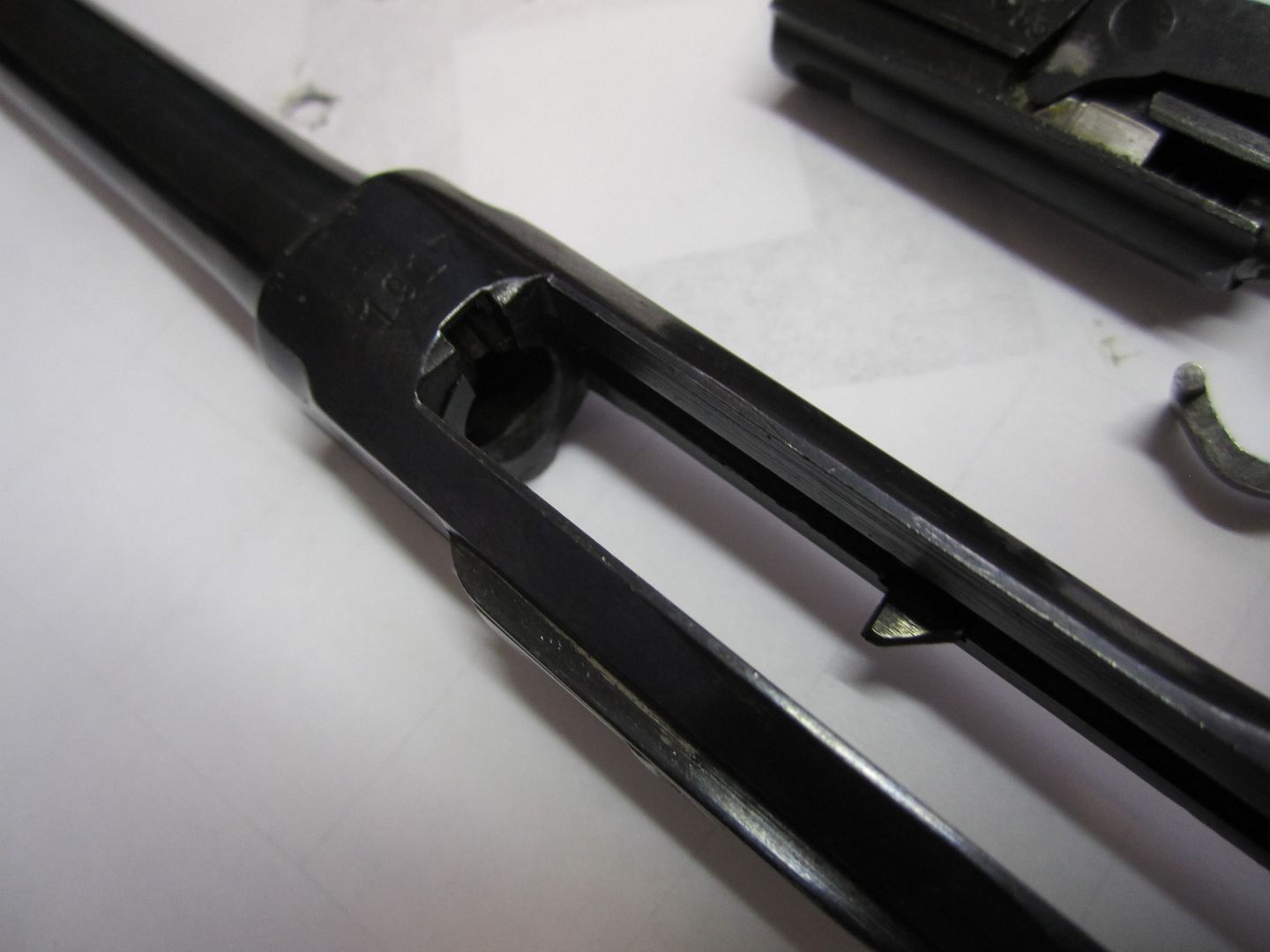

Bryce, Congratulations and welcome..I agree with Mark..I like the .30 much better than the 9MM Just a lot of difference in the cost of ammo.

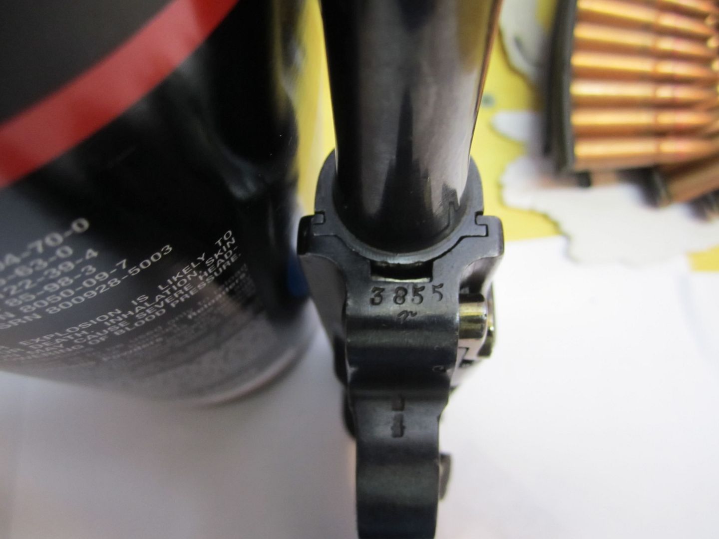

Can you get us a good photo of where the barrel enters the reciever? This looks to be awfully thin on your pistol. Any markings on the barrel?
Unread 03-31-2011, 08:00 AM   #5
Can you get us a good photo of where the barrel enters the reciever? This looks to be awfully thin on your pistol...
...As in no flange at all...and a double taper...Front sight blade is not Luger either...
Also, the 'proofs' on the right side of the receiver look...strange...

Unread 03-31-2011, 12:08 PM   #10
Bryce..Seriously I would take a good close look at the barrel before you fire this weapon. It appears to be home made, not correct and out of spec.
Unread 03-31-2011, 01:10 PM   #11
Bryce,
Take Jerry's advice. He is a very wise man!
Do I possibly also detect a slight bulge in the middle?
Bryce, please look into the bore and see if there are any irregularities in the rifling/inner dimentions. A certified gunsmith should look at this gun prior to firing it. It may have been sold off for a reason.

Unread 03-31-2011, 02:36 PM   #12
I see what you mean by the lack of a barrel flange. This could be a problem, but only time can tell... The receiver was designed to have a full flange, but can function with a limited flange provided the barrel is torqued adequately. What is adequate? With a full flange, usually 1/8th turn is usually about right. With a reduced flange? who knows.
My recommendation would be the same as Jerry...make sure the headspace is correct. Then make sure you have a witness mark so you can periodically check it for movement.
The way such a barrel as shown happens is that the person doing the conversion chooses a rifle barrel that doesn't have sufficient diameter in the chamber area to provide a flange. It may be that the person who did this conversion didn't have more than one barrel to choose from...

Posts: 9
Yes, I'll have somebody smarter than me take a look. Worst case is that I get it re-barreled. Now I wonder if the barrel is .308 or .309. I'm not aware of many .309 rifle barrels. Are there original Luger barrels out there?

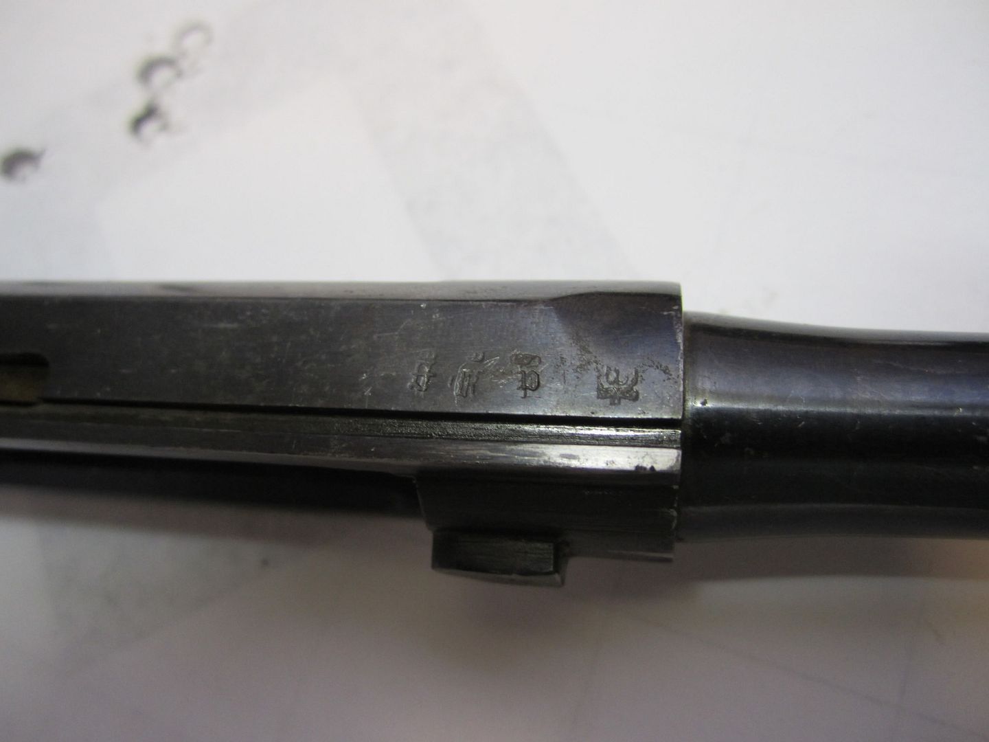

Here are a few more photos. I'd be interested to see what you think about the proof marks and the barrel configuration:
Thanks for looking! I have photos of just about every surface so let me know if you would like another view. ..... and no, the targets are not from this gun!

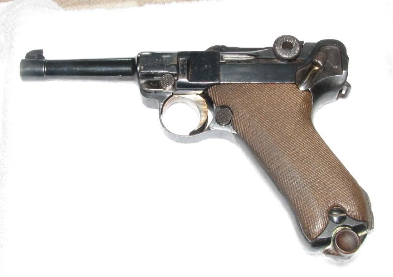

I just got this gun back from Tom Heller who gave it some TLC. It got a new 4" barrel and a spring to match the .30 Luger it had been chambered for. I haven't fired it yet, but he did and said it feeds and shoots nicely! I re-finished the grips too (twice - too dark the first time).
I'm still interested to see what people think about the proof marks on the photos above. Thanks for looking.
BTW, I got a Mec-Gar mag to use for shooting. These better photos really make the finish look more worn than is apparent in-hand. The ol' girl obviously has a few miles on her, but hopefully now she at least looks right and is good for shooting again.

Thanks: 3,245
Should make a good hooter. Can't tell about the proofs.One looks overstruck. I believe
the gun has been refinished so hard to tell. Hopefully someone else will answer. Welcome to the forum. And remember lugers are habit forming. Bill

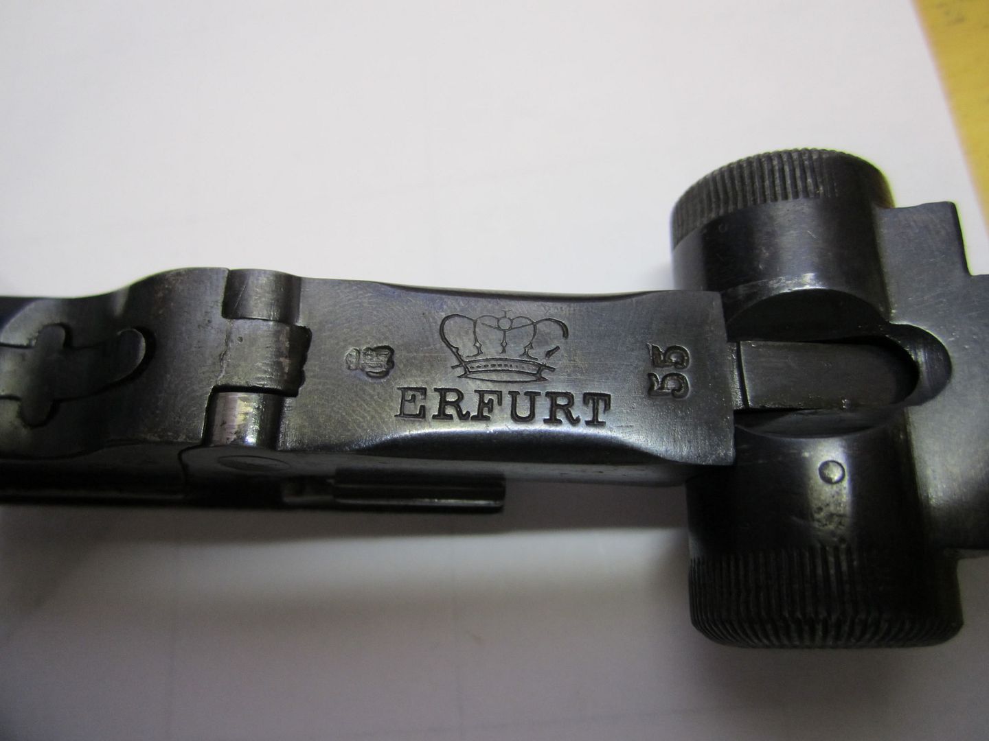

Unread 06-09-2011, 07:03 PM   #18
Definetly refinished. Look at the Erfurt Crown on the toggle....
