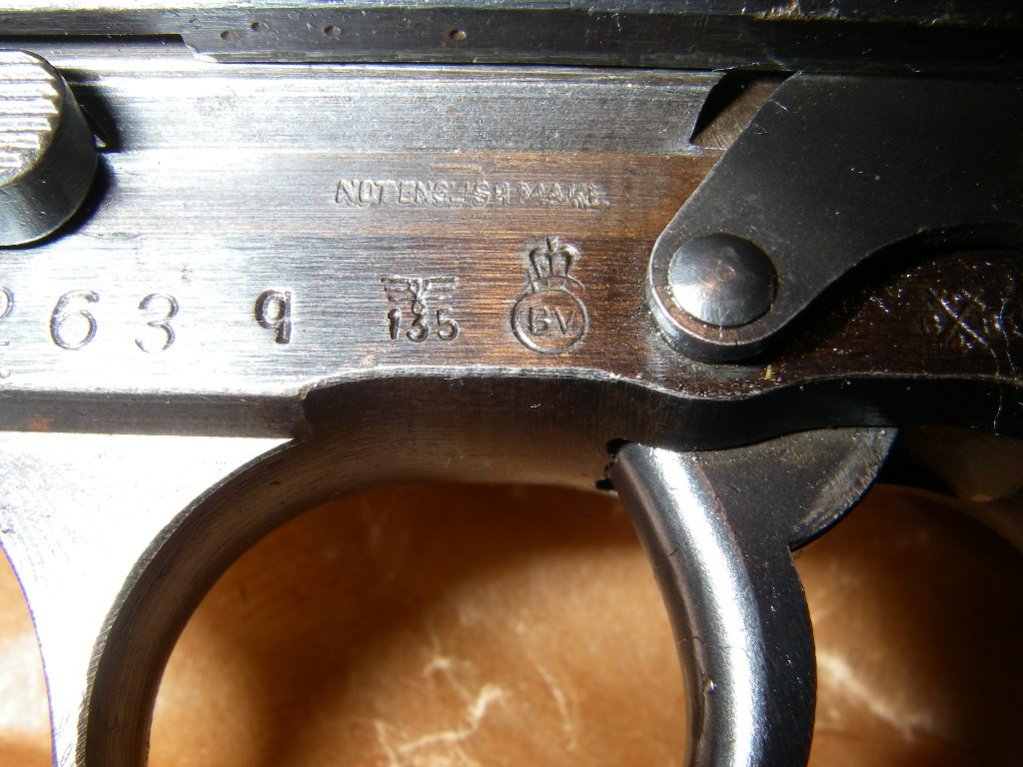

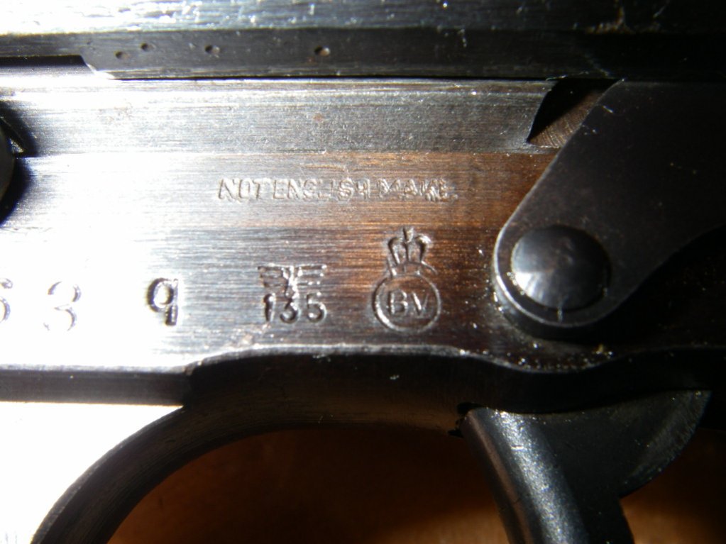

Dwight and others: Here is the stamp "not english made" that was referred to. So far as halo , no halo You can be the judge. Its from a byf 43 P.38. I hope you can see it clear enough, my picture skills are lacking a bit. ..Thank You, Dale

Dale, Nice clear photo. It's my recollection that most "tommy" bring back firearms never were registered, although to have them LEGALY registered, the proof house inspection and markings were required. TH
