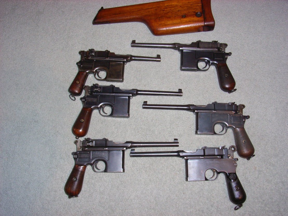

Just thought I'd put in a picture, so people can see, do to the help I received here, what I managed to get back from the customs people. I put in a couple that were here all ready as well.
There is a Late flatside, 2 X prewar commercials, one with stock, wartime commercial with German Army Accpt marks, 9mm military contract and a late post war Bolo.

I like the flatside. Is it in 24xxx range?

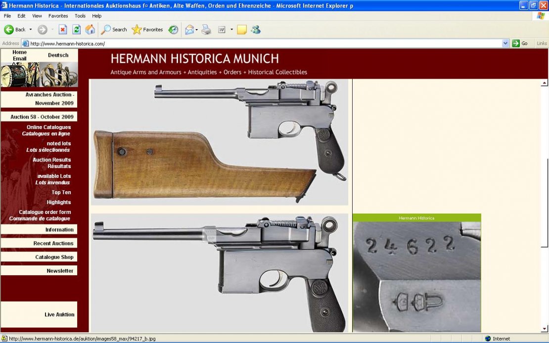

It's also hot in Europe. Here is one (not mine):

Thats close to the number, it's 25209. On the right side is a stamp I've seen before, but the brain won't place it at the moment. It's like tree branch on it's side, or half an antler.

Unread 10-21-2009, 10:34 PM   #11
The "tree" represents the famous Oberndorf Proof House.
