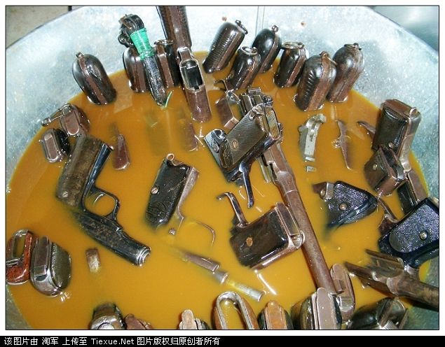

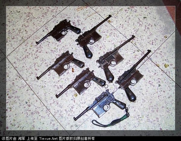

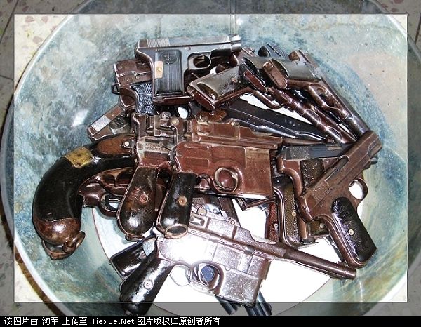

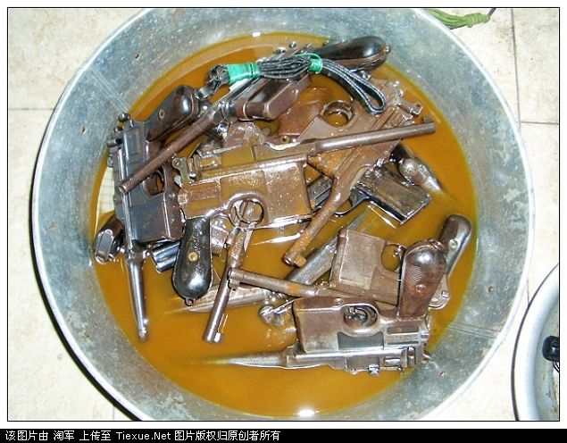

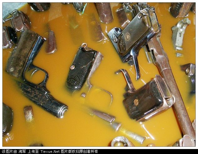

Just saw a few pictures on the internet. One guy proudly introduced his way of cleaning guns. Now I understand many guns that I saw on gunbroker.com
[pix copied from internet. Copyright belongs to original owner]
