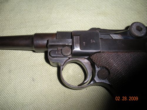

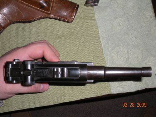

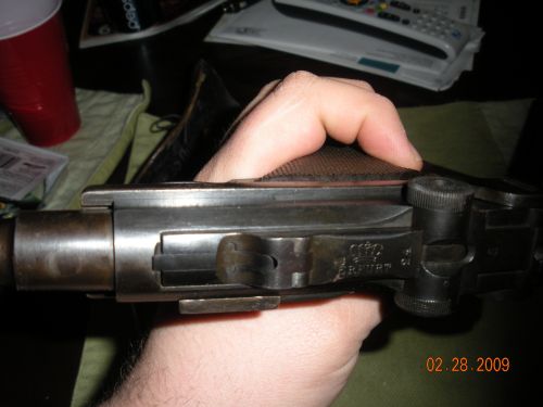

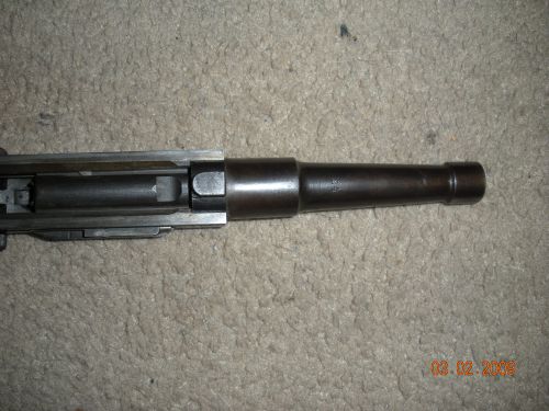

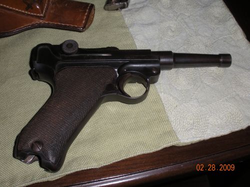

I have had an Erfurt Luger that has no serial number, or date stamp, or sight on the tip of the barrel (none of these things are missing it just seems the gun was manufactured that way. After searching the internet forever I have not found a single one like this. My Great Uncle on my fathers side brought it back during WW2 and I have the papers somewhere. I was hoping you can help me find out more about this gun or point me in the right direction to find out. I have no desire to sell this firearm but I would like to know whatever I can about it. I have included some pictures.

Certainly interesting. I'd like some more pictures particularly under the base of the barrel showing contour and any existing #s. A turned down artillery barrel?
Let's see what the wizzards have to say about this one. Clearly out of my league.

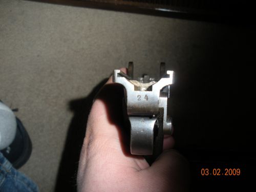

and all the numbers match #24 but there is nowhere on the gun with any more numbers then just #24

That is a very odd Luger. It looks as though it was possibly converted as a chamber/cartridge pressure test piece. The front of the receiver has been milled off to add the thicker chamber segment of the barrel. This would also account for the lack of a front sight, since it wouldn't be needed.
If the "bring back" document shows it as "SN 24", it would add credence.

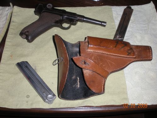

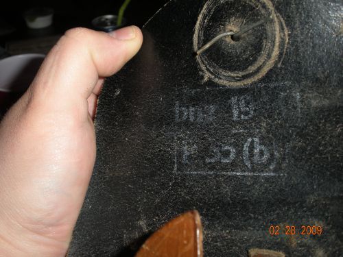

BTW, the holster is for a Polish Radom. These are desirable by themselves. It's not uncommon to find "Bring Backs" with Radom or P.38 holsters.

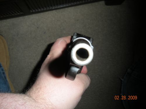

I belive it's a 9mm because it had 2 9mm shells in the bag it was in (green canvas) but i got rid of them 5+ years ago... I don't trust really old ammo and I haven't fired a round through it yet just in case i'm wrong plus i don't want to damage it. Even if this sounds weird I will say it...I feel that I did nothing to deserve being the first to shoot this since WWII it's to importiant to me. i'm off now.

Take a pencil, try to drop t down the front of the barrel. If it won't go / is tight, its 30 luger (7.65mm) and if it falls down the barrel its 9mm (unless its been modifies, which is always possible, but not usual).
"Normally" you see the last 2 of the serial number, in this case the serial number IS 2 numbers so, its okay.
Very odd barrel, since it is "set back", and as someone says, it DOES look like a proof barrel.....

It's a 9mm...thanks! What does proof barrel mean?

I think it is more likely that this was a damaged upper receiver that was salvaged by a resourceful gunsmith tinkerer (no pun related to Ed)... by machining off the face of the upper and using a homemade barrel... This is not a factory modification in my opinion.

There is the same #24 on this barrell and I know for a fact nothing has been modified on this gun since my great uncle got it during WW2. If it was done prior to that then why stamp it with the 24?
Also why no date stamp? Plus I don't know if the pictures show but the color dosen't differ between the barrel and the rest of the gun if it was aftermarket like you think wouldn't they have to redo the whole gun because as far as I can tell it all matches. Also kicking around your site I have noticed that the early Erfurt was notorious for bad (circle) machining around the safty but this is super smooth.

The holster you have for it is totally wrong. As Ron says it's for a German (Polish) Radom . The closure stid is missing from the top flap..the wire that is in there is causing damage to the underside of the holster. You may want to remove this to prevent more damage.
Also I would not put a Luger magazine into the Radom magazine holder..It will not fit & will scrape away leather.
If you want to work some sort of holster trade I am sure I could come up with a proper Luger holster for you.

If I were a betting man, I'd wager that this gun was done by a non-factory 'smith. All of the proof guns I have encountered (4-5 over the years) were prufung marked at the factory.
The lack of such marking is telling.
