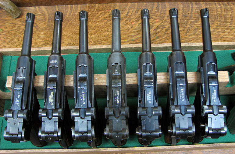

Unread 12-18-2008, 09:41 PM   #17
Originally Posted by mountain guy View Post
......This type of Luger sounds like it would be the KEYSTONE of many collections!
oh they are just laying around at yard sales ...
Unread 12-19-2008, 12:47 AM   #18
Went Blakely
Went Blakely's Avatar
Join Date: Feb 2008
Location: Australia
Posts: 231
Thanks: 4
Thanked 8 Times in 6 Posts
Hehe that photo just made my week. Excellent!

Unread 12-20-2008, 10:54 PM   #19
mountain guy
Join Date: Dec 2008
Location: Tennessee
Posts: 9
Smile
WOW! The photo made my week too! Very very nice! Thank you so much for sharing! I know you must be very proud of your collection! Thanks Mr. Tinker! I will now not pass up any yard sales!
mountain guy is offline   Reply With Quote
Unread 12-20-2008, 11:34 PM   #20
okay, didn't pick any up at yard sales, but in fact bought 3 or 4 from friends, the rest from folks telling me where they were (at a gun show, calling me, emailing me, etc).
actually have sold two of the ones in the pictures, but bought another 3 to replace them :>)
I'll try to do an up-to-date photo tomorrow if I remember
