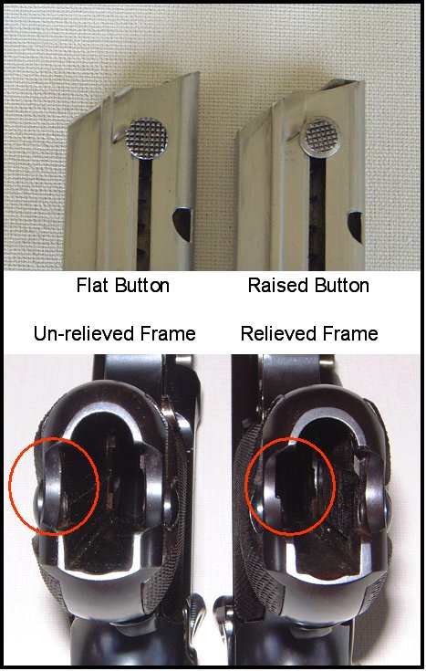

And I have a 1900 that no mag will fit smoothly into or out of...binds like a beast, so it is sitting magless for the moment.
Ya, I pulled the grips, tried several mags, mag release appears to be working smoothly...no dice.
Something is evil in there.

Anna,
If your 1900 is a very low serial number (under 1000) there is an outside chance that it is one of the surviving early unrelieved frame Lugers that requires a special "flat button" magazine. Many of the unrelieved frames were later modified to accommodate the raised button magazine, so surviving unrelieved examples are scarce (there weren't too many to begin with!).

You were right, Ron.
Will post about this gun in the Early Lugers Forum.

Well, oopsie...I looked at the pics from the wrong side.
Post is up on Early Lugers though.
Still a weirdie.

Ron,
I will never cease to be amazed at your knowledge and photograghic abilities. Here's a big 'YAHOO!' for you.
