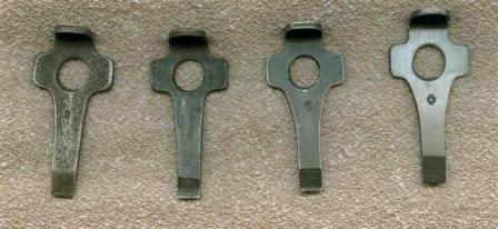

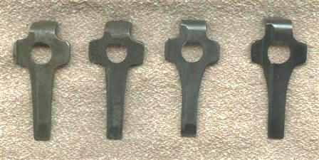

Allen,
Here are a couple of photos of some TD tools I own...
I believe all are German-made, originals...
Left to right are as follows :
* Erfurt made.
* DWM made.
* Luftwaffe proofed.
* "Swiss" marked.

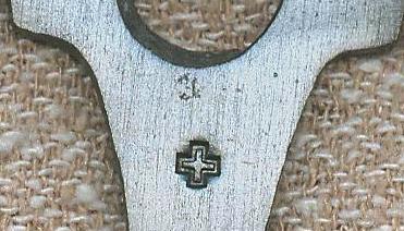

Note : The Swiss marked one (small Swiss cross) are more than likely forgeries...stamping probably added in the USA for increased dollar sales. The Swiss collectors do not report such a tool in use in Switzerland by the military.
I think my tool started out its life as a German made tool and had its "swiss cross' added and a nice polish and blueing job done. I bought it as a 'curiosity"...knowing its markings were suspect...

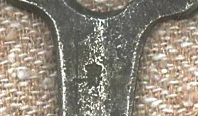

Close-up of the Erfurt mark :

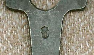

Close-up of the Luffewaffe acceptance stamp :
Close-up of the "Swiss" (made-up...) mark :
