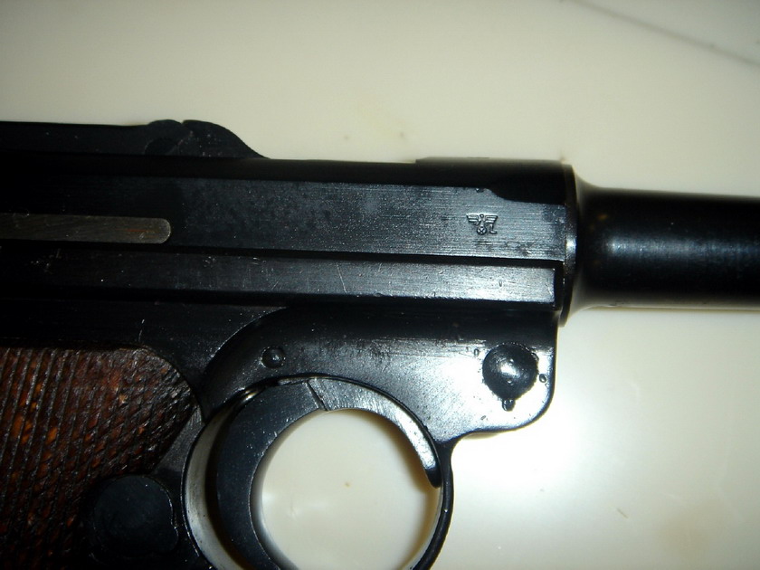

Hi all,
i'm evaluating to purchase a 1939 mauser banner police luger.
I received some pics from the seller and i noted that:
the Schiwy safety has been removed
there is not the serial number on the barrel
the #3 of the serial number on the front grip and on the magazine is different from all the #3 of the other serian number
the blueing looks fine
I'm not an expert so i need the help !!!!
thanks a lot in advance for any suggesion/comment
Ciao
Alberto

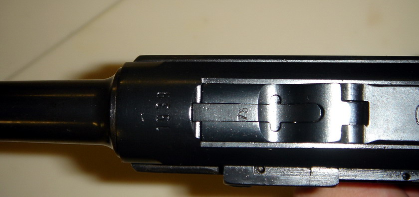

Default Eagle L
Eagle L

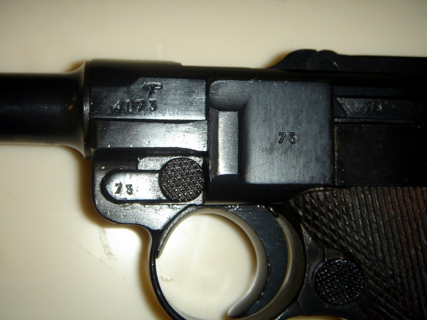

Default safety removed
safety removed

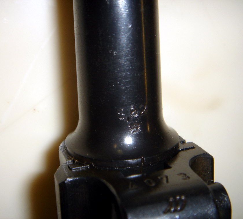

Default left frame s.n.
left frame s.n.

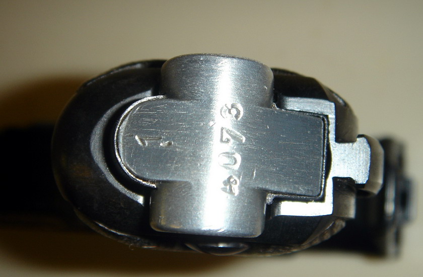

Default different #3
different #3

Default magazine
magazine

Unread 08-16-2007, 11:07 AM   #7
The mag numbering appears to be that of a DDR rework. Perhaps the mag body is marked 2/1001? I would also bet that it is importer marked somewhere. TH
Unread 08-16-2007, 11:10 AM   #8
PS: If this were the original magazine it would have the same size and font digits as those on the frame AND the suffix letter. TH
Unread 08-18-2007, 09:27 PM   #9
SteveM
Posts: 1,016
Thanks: 94
It has the typical Russian "X" on top of the C/U.
Steve
