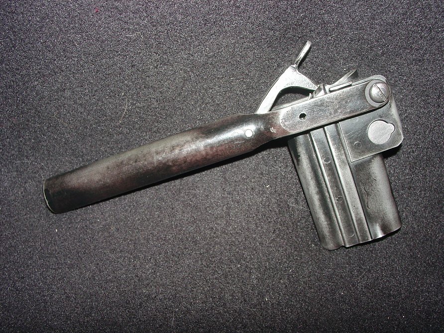

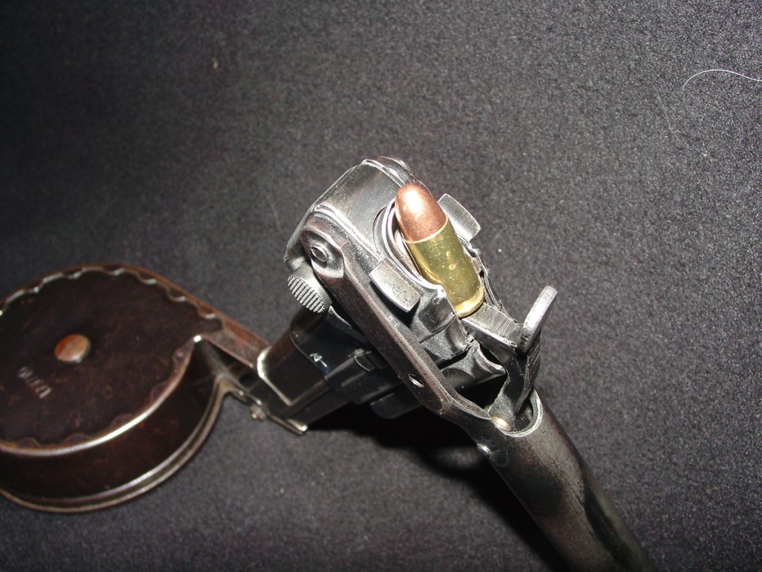

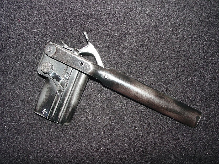

Now Eric, you need one of these, but good luck finding one, they are rare. They are controversial, but they work GREAT !
Harry

Eric, Untill Harry decides to sell you his un loader..you simply use something like a flat headed screwdriver and push each individual cartridge out to un load. They will usually come right out as they are under spring pressure.
