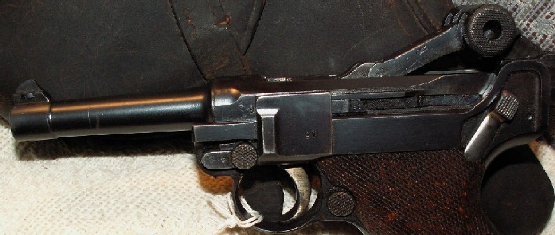

Here's the only picture I have.

JTB - Policeluger is exactly right.... From only the picture, both the take down and mag release button should be strawed (a yellowish color). Since your pic doesn't include the safety lever- I'm guessing that isn't strawed either?
Anyway - after your pic (thank you for posting it - and again welcome!!! ) I'd probably categorized your Luger as a "shooter"... And as far as Lugers are concerned - any luger is worth keeping...
Hope this does NOT discourage you - as we all started with our "first" luger..!!

I haven't looked the gun over in person yet. I'm heading over to do that in the morning. I noticed the takedown lever looked blued. I'm assuming it's an old reblue of some kind then and will value you it down into shooter class.

No problem..! When you do see it - feel free to post back here and ask questions about what you saw before you "do the deal", OK? If the owner lets you snap some more pictures - all the better.
based on the picture - yes, I'd probably put it in the shooter class - but, as a disclaimer - I've been known to be wrong outside my specialized collecting area (which this is not one )....
