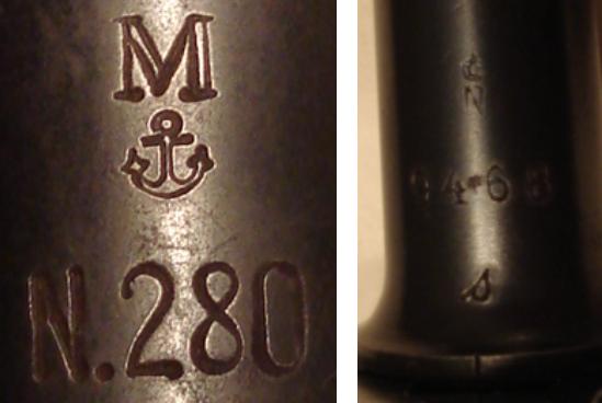

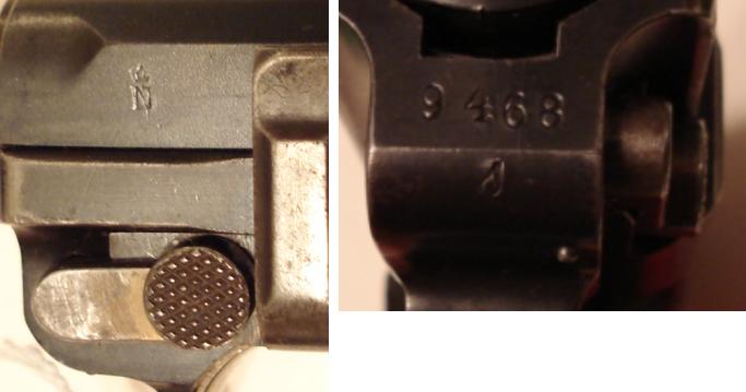

Just looked at one of these, had an unnumbered safety bar (sear block), blank chamber date, C/N proofs and was M/anchor/N.xxx marked on the rear gripstrap.
I know it's a Weimar Reichsmarine luger... should the safety bar be numbered?

I checked my Weimar Navies (9 total); the DWM blank chambers do not have sear bar numbering.

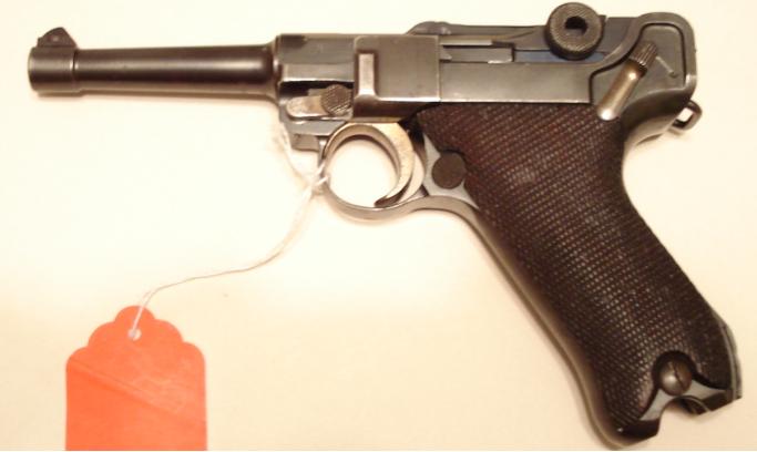

Just working out the new cam in poor light. Here's the general idea:
I'll have better pics in a few days.
Jack

Jack,
The small parts of DWMs with "s" suffixes ("29 DWMs" per Jan Still's nomenclature) were originally numbered in the commercial (hidden) style. Unless the purchaser re-stamped them in military style, they stayed that way. Apparently, the Navy did not.
Don
