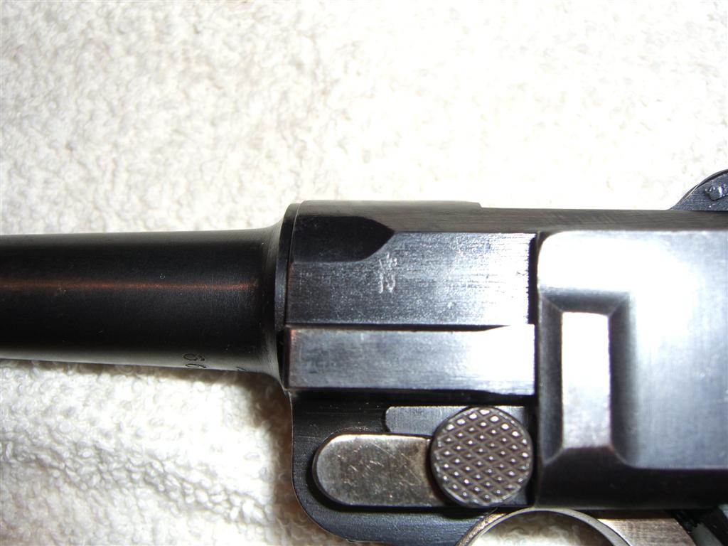

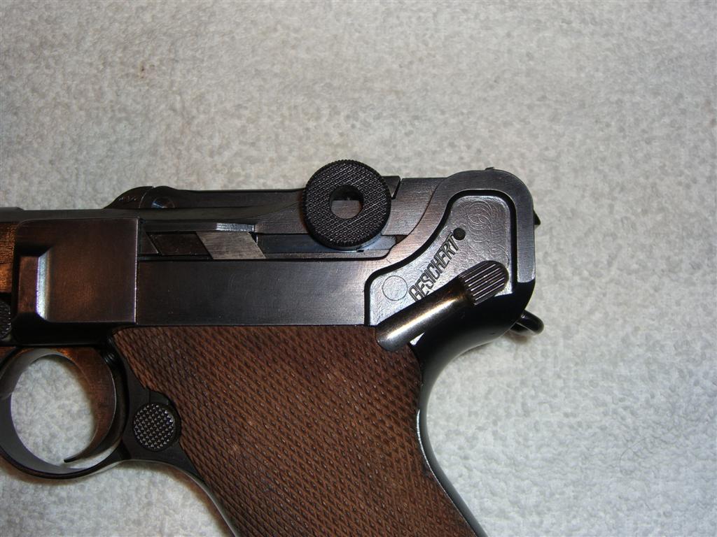

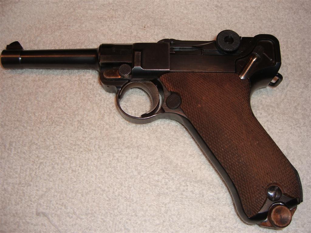

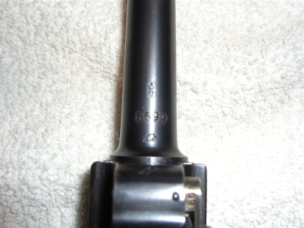

I recently inherited a 7.65 luger from my wife's side of the family. It was her great great grandfathers. I know absolutely nothing about guns, but would like any help anyone could give me in identifying it. I think it is a commercial model. The serail number is 8699 , looks like all the small parts have 99 stamped on them as well. On the bottom of the barrel is a capital N with a crown over it. Thesame symbol is on the left side of the receiver? Also under the serial number looks like a cursive o. Ithas GERMANY stamped on the front of the receiver and GESICHERT under the safety. On the top is a cursive DWM but no year marking. It has a magazine with a wooden bottom, with GERMANY stamped on that but no serial number on the magazine.

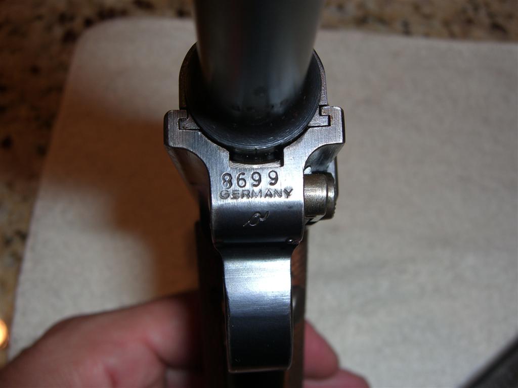

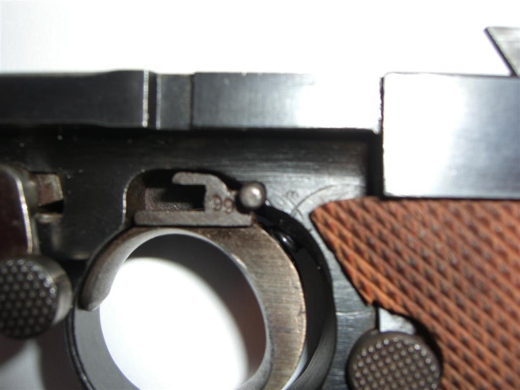

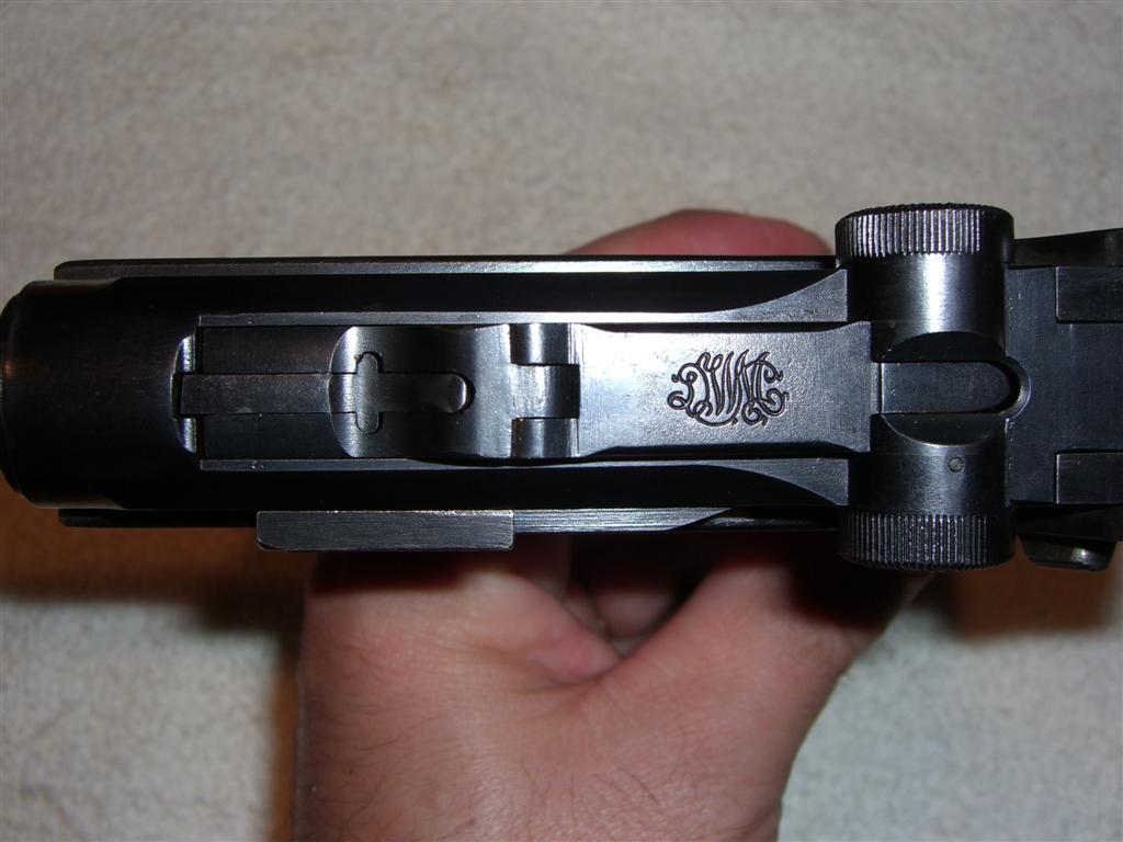

http://forum.lugerforum.com/lfupload/kent10.jpg
http://forum.lugerforum.com/lfupload/kent13.jpg
http://forum.lugerforum.com/lfupload/kent17.jpg
http://forum.lugerforum.com/lfupload/kent18.jpg
tried to add some photo's, I think it is a 1920 commercial model?
Furballf16 is offline   Reply With Quote
Unread 09-29-2006, 02:40 AM   #3
You nailed it Kent, and a pretty nice looking one at that. It obviously has been very well cared for. Current nomenclature is "1920 Alphabet Commercial" because of the letter suffix on the serial number. This differentiates it from the 1920 Commercials that continue the 5-digit serial number without a letter.

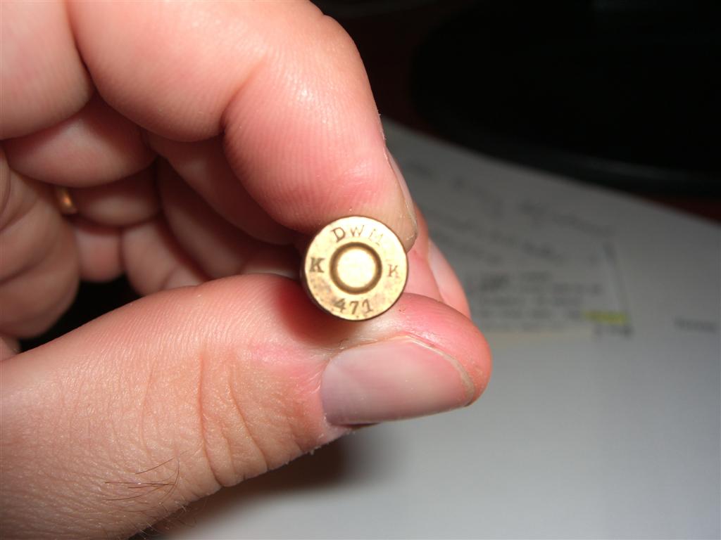

I'm pretty sure it is a 7.65 mm, I actually have some of the original DWM ammunition that came with it when purchased new. My father-in law has shot it last about 30 yrs ago.
Unread 09-29-2006, 12:39 PM   #9
If you have some of the original ammunition, the caliber determination is easy... even if the caliber is not on the headstamp of the cartridges...
If the cartridge is bottle-necked and the bullet is no where near the case head in size, then it is .30 caliber or 7.65mm, if the case is not a bottle-neck, then it is a 9mm.
A 9mm cartridge will NOT fit in a .30 caliber Luger chamber...

A few more pictures including 2 pictures of the DWM rounds.
Thanks for any more info.

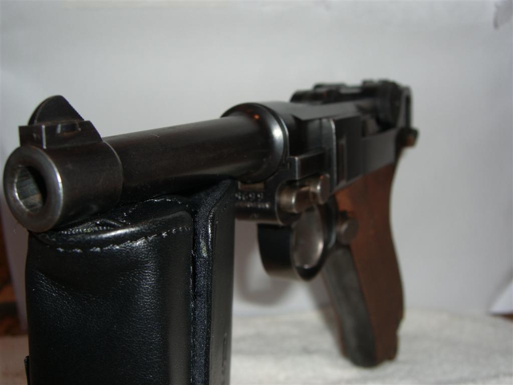

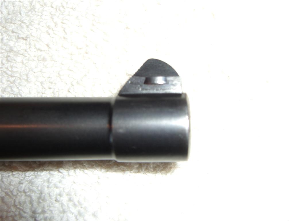

Tomathvl is offline   Reply With Quote
Unread 09-30-2006, 03:48 PM   #17

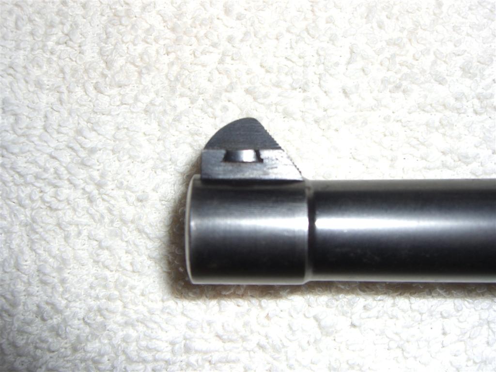

Kent,
That is a really fine Luger. For research purposes, would it be possible to see a 3/4 diagonal view of the front of the frame? and also a good side view of the front sight band?
Thanks much.
Unread 09-30-2006, 06:07 PM   #18
Furballf16
Location: phoenix
Posts: 8
Dwight,

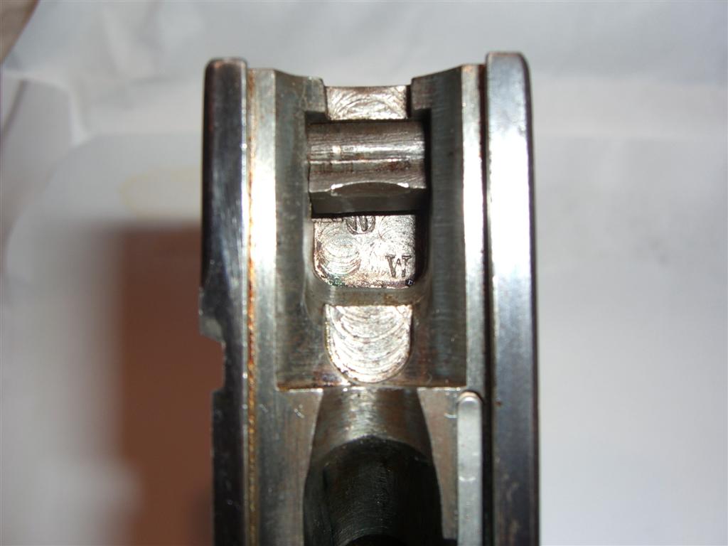

Here is your request, also had a question as to what the markings are on the inside of the receiver, looks like a W and something else, also under the sideplate looks like a little m or n? Let me know if you want anything else.
Kent
