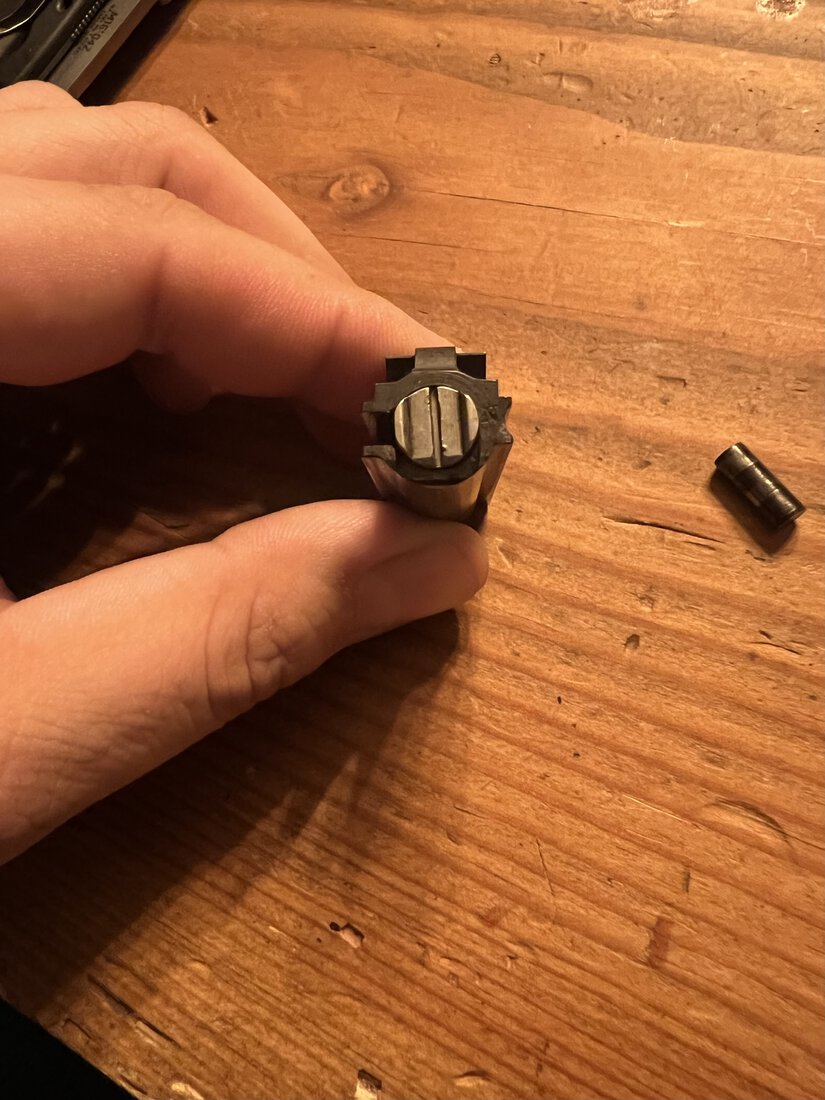

Well i got home from shooting some new factory 124gr 9mm and upon disassembly to clean my luger i found the center toggle to be cracked on only one side of it i have no idea when it happened anyone else ever see this or should i just chalk it up to being a 110 year old piece of steel

Exactly what cartridges were you shooting? Lugers should never be shot with +P, +P+, NATO or any other cartridge that isn't standard pressure. The original Luger load was a 123 grain bullet at 1090 fps. Most who shoot their Lugers with factory ammo use 115 grain Winchester White Box.

This was absolutely nothing hot at all it was just regular federal 124gr factory ammo with a fps of 1150 i know better than to shoot anything hot in my luger and would never ever shoot a +p bullet in this gun

It will happen dependably with the Erma .22s made in the sixties if "hyper velocity" rounds are used (e.g. Stingers and Velocitors). Granted, those guns are made primarily of cast ZAMAK, but the corresponding part to yours breaks the very same way.
IMHO, 115 grain ammo is gentler than 124 grain ammo on the Luger action.. These are old guns, remember.

As for the broken middle link, I think either the part was improperly heat treated, or, a flaw in the metal? I've never seen one break in that spot? But, being that you're replacing it, make sure you have the headspace checked, or you might just go from bad to worse??? : Best of luck with your repair, til.....lat'r....GT

Beside the potential problem with headspace, the fitting of the link pin may present an issue. The new toggle may not have the identical hole size. Just a thought.

As for sanding the holes, the short answer is nope!!!!
Every thousands is important for either maintaining, or re-establishing the correct head space! In fact, a tight closure on the "GO" gauge is desired..
Install the middle toggle, to rear toggle, link pin and see how it feels? If just a little snug, oil it up and work it back and forth thru it's, "working range" don't work it too far as it will remove the blue on the rear toggle knobs!
If then too tight, use a little fine lapping compound. A spot of that, and a couple of cycles by hand, and it will loosen up immeadiatly. Be carefull and don't over do it. Check the rest of the pins in the same manner. toggle should be free, with zero endplay.. If possible... best to all, til.....lat'r....GT..
