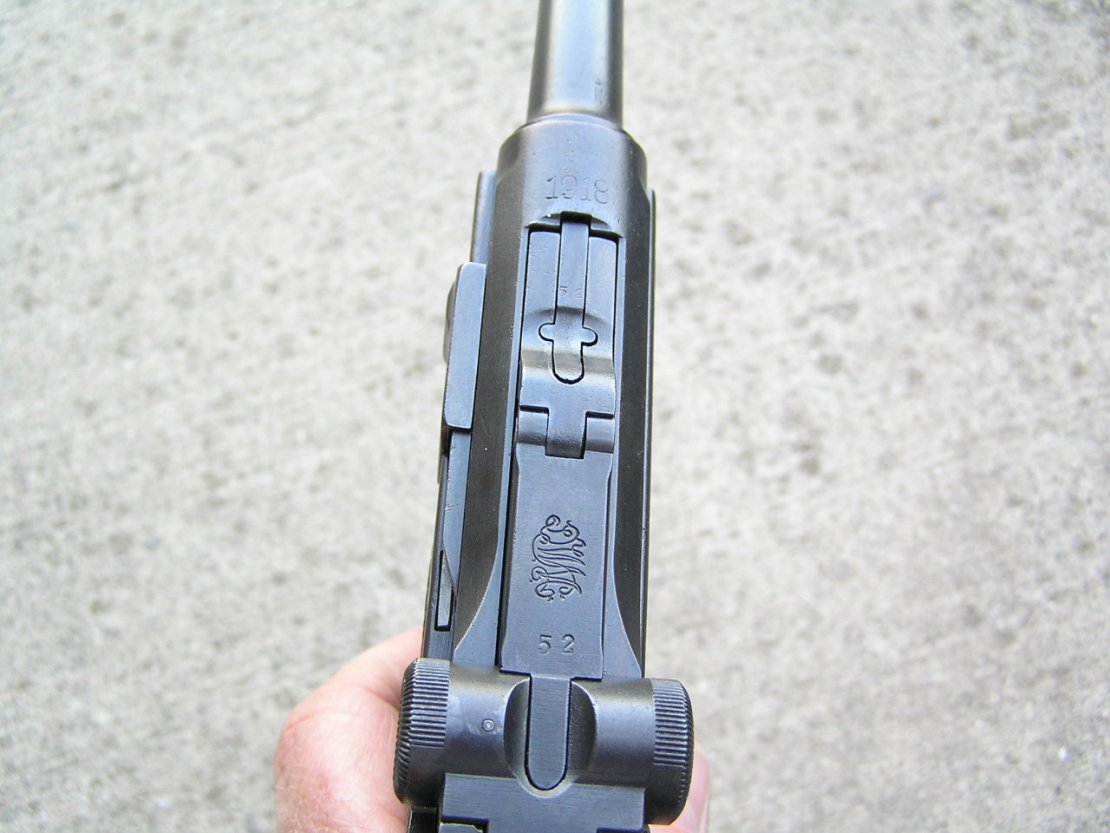

Here is a 1918 that I got - bad finish, stripped and then reblued using the solution. - Mark

Mark, Very nicely done!

I like it Mark--looks great.

outstanding job mark

Wow Mark that turned out great!
I ordered the rust blue from Brownells and a pound of sodium nitrate today, I also strawed all the small parts which tuned out really nice. Tomorrow I polish my Luger to look like Mark's pre bluing. I'll post pics up when its done.
