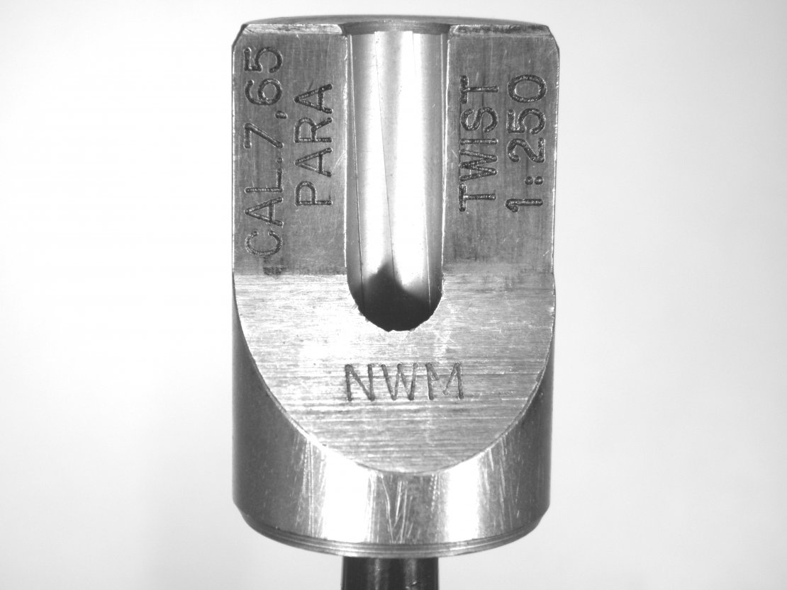

.30 luger factory twist was 1:250mm.
..or 1 in 9.84252 inches. Thanks Vlim.
