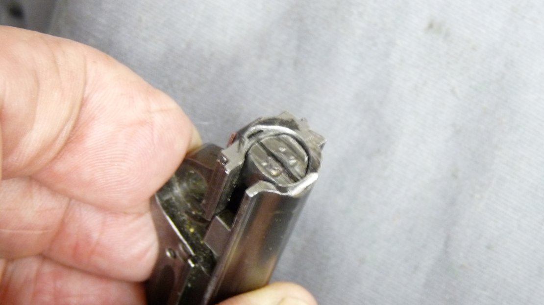

This luger breach block must have been nearly worn through at the striker guide retainer, as after a few mags of ammo fired- it would not function any more!
Disassembly and inspection revealed the wear seen here and also shown in this thread:
http://forum.lugerforum.com/showthread.php?t=35950
The first three pictures are before repair.
I don't have the capability or ability to do a "good" small weld, so decided to fix the problem with a transverse pin inserted to replace the missing/worn retaining lip. I used a 1/16" pin, made from a drill bit.
Being too impatient to take the piece to my machinist friend to do the work in a "real" milling machine; I decided to do a trial repair with my drill press.
I used two 1/16" carbide drills because I broke one, they were not long enough to do a through and through, so I drilled from each side and then through both holes using a normal drill from one side. I was a little surprised I was able to pull this off, mill work would be much surer!
After the job, the pin required grinding and shaping to allow the striker spring guide to enter and turn as designed. This was done with a dremel and various bits. When finished the pin was locked in place using green penetrating loctite.
One can see the pin ends on each side of the breech block, and the pin body where it passes through the circular opening.
Bench function was ok, so then to the range, where 2x 8 rounds as trial worked just fine. I'll be firing more to determine the "durability" of the repair.

I forgot to mention the striker spring guide I used was broken and also had been repaired,
a story for another thread.

I had my local gunsmithing services provider perform this repair to my breechblock.
The repair pin occupies space within the breechblock that needs to be free for rearward movement of the retainer, so I reduced the retainer locking tab's thickness until the toggle would lock and striker would drop.
I popped a primed case to prove trigger/striker function, and will try to get to the range for a full test, and some pics.

Retained by loctite and is an interference fit. Though it could be soldered if you wish.
One most likely will have to use a vertical mill, carbide (short) bit, I did
The breech lock has sufficient flat surface on the top to hold in a good vise.

He did drill in from both sides.
Because the hole is not centered on a flat surface, some tool - I'm not a machinist - was used to cut down to a point where the drill could go straight in without wandering.
The pin was fixed with green Loctite.
My gunsmith will drill the hole and install a pin for $50, if anyone wants that part of the work done, leaving the fitting to the owner.

Using a threaded pin, adds unnecessary complexity to an already delicate job; and increases the chance for failure- like breaking a very small hardened tap in a very small hole, leaving a near impossible removal issue.
I used a 1/16" drill bit, cut to length for the pin, since it was already hardened and should last as well or better than the material of the original block.
If you screw up a pin, as you say - drive it out and put in another; doesn't get much simpler than that.
